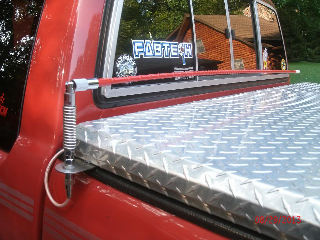

I got all my stuff in for the install.

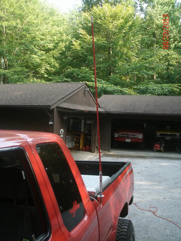

The 4' Firestik II came Saturday
Pyle PA Speaker, which also arrived Saturday. It was cheap and had good reviews on Amazon. Hopefully it's not a Pyle of crap
Everything else came Monday. It consists of the flat mount, 18' coax (It was pictured black in color on the site, but came tan or something. I'm colorblind), 3' jumper cable, SWR meter, and the spring and folding mount that Mark sent me. Thanks Mark!
I'm not certain where I'm going to mount the speaker. I took a quick look a couple nights ago before it got dark and this seems like the only place it'll fit, mounted to the core support in the wheel well on the drivers side. I might see if it will go on the other side of the core support between the bumper. That would be a better place since it will be out of the way of slinging dirt and road grime from the tires. We'll see.
I've started classes again, but when I got home today, I ran the coax cable and mounted the antenna. It's a lot higher than I thought it was going to be The parking garage at school has a 7' clearance, though it looks much higher than that. We'll see if it hits. I guess that's what the folding mount is for

So I have my SWR on all channels to be around 1.3 or 1.4 with a max of 1.7 and a min of 1.1, still without the folding mount.
I haven't run a ground wire down to the frame or anything yet. I thought having it mounted to the toolbox would have been enough, but I guess not. I'm getting a bunch of static, especially while the truck is running. I know how the power wires are run is important. I have a wire coming from the battery to my aux fuse box, then into the cab (EDIT: I don't have the ground connected to the battery. It's connected to the same ground my driving lights are connected to). I'm guessing it's picking up noise from the alternator, fuel pump, or something. The only thing I have in the fuse box is the lights, but I haven't had them on while the cb was on. Anyone have an experiences with noise filters, specifically the ferrite core ones, kinda like this: http://www.ebay.com/itm/4-RFI-EMI-Fe...-/120820909579

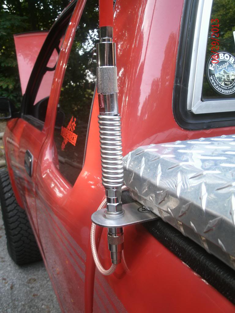

Mount

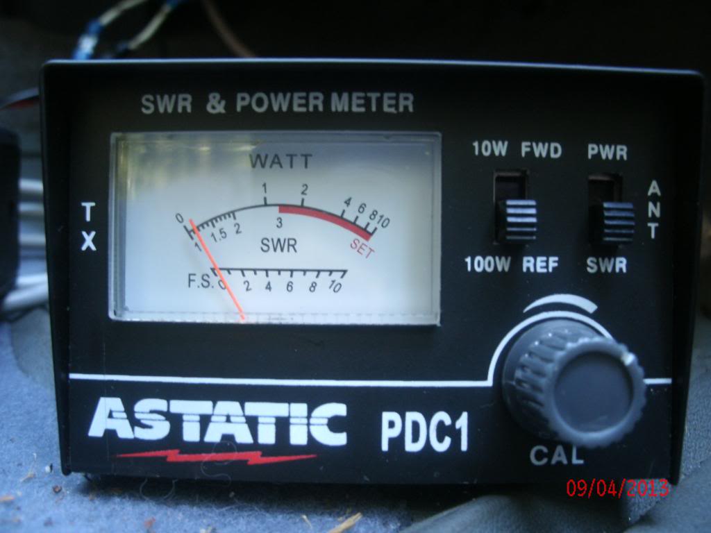

Again, I could only get the SWR down below 2 with the quick disconnect off. So I either have to park on the top level at school or take the antenna off. To make the decision easier, I witnessed a wreck happen on the bottom level. In fact, I was only about 6 feet away. It's the 3rd wreck I've witnessed on the bottom level since I started going to school. So the choice was obvious

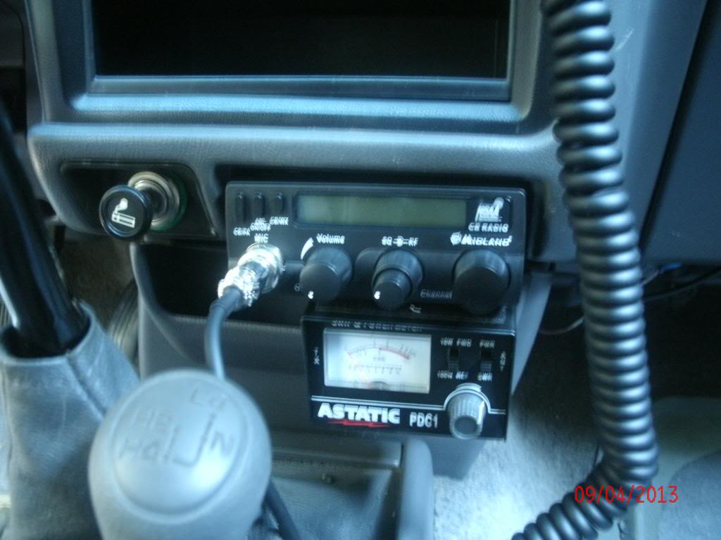

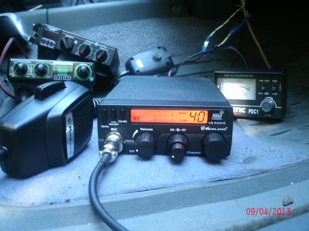

I got the Midland CB yesterday
SWR reading on channel 19

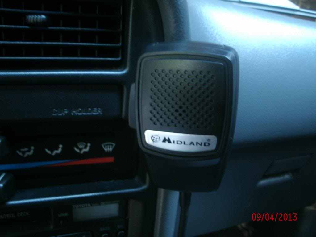

Handheld clip. Didn't want to drill holes to install it. This happened to be a perfect place.
Handheld mounted. Yes, the cup holder will still open.
All together
I'm not sure if I want to keep the SWR meter attached or not. The reason I kept it attached is so I can easily check the readings from time to time. I was also wrong before when I said there was no engine noise. I only tested it when it was idling. However driving to school this morning, I could definitely notice it. Once I figure that out, this should be a great radio. With the engine off, it has great sound. The weather station comes in very clear. The PA function works great. The Pyle speaker didn't turn out to be a pyle of crap.

Hey man, who cares how long it took you... Looking sick! I would ditch the meter and find a quick disconnect message you can just pop it in when you need to. But whatever, its your Drake and who cares which way you do it, as long as it's something that's practical for you. Hahaha, love the picture, and I'm sure everyone thinks you're nuts... They just don't understand this disease. By the way, maybe some of those the thought you were nuts were those that were parked on different levels and getting their car smashed into on other days? Haha.... Maybe it was Envy, rather than confusion? Lol.
