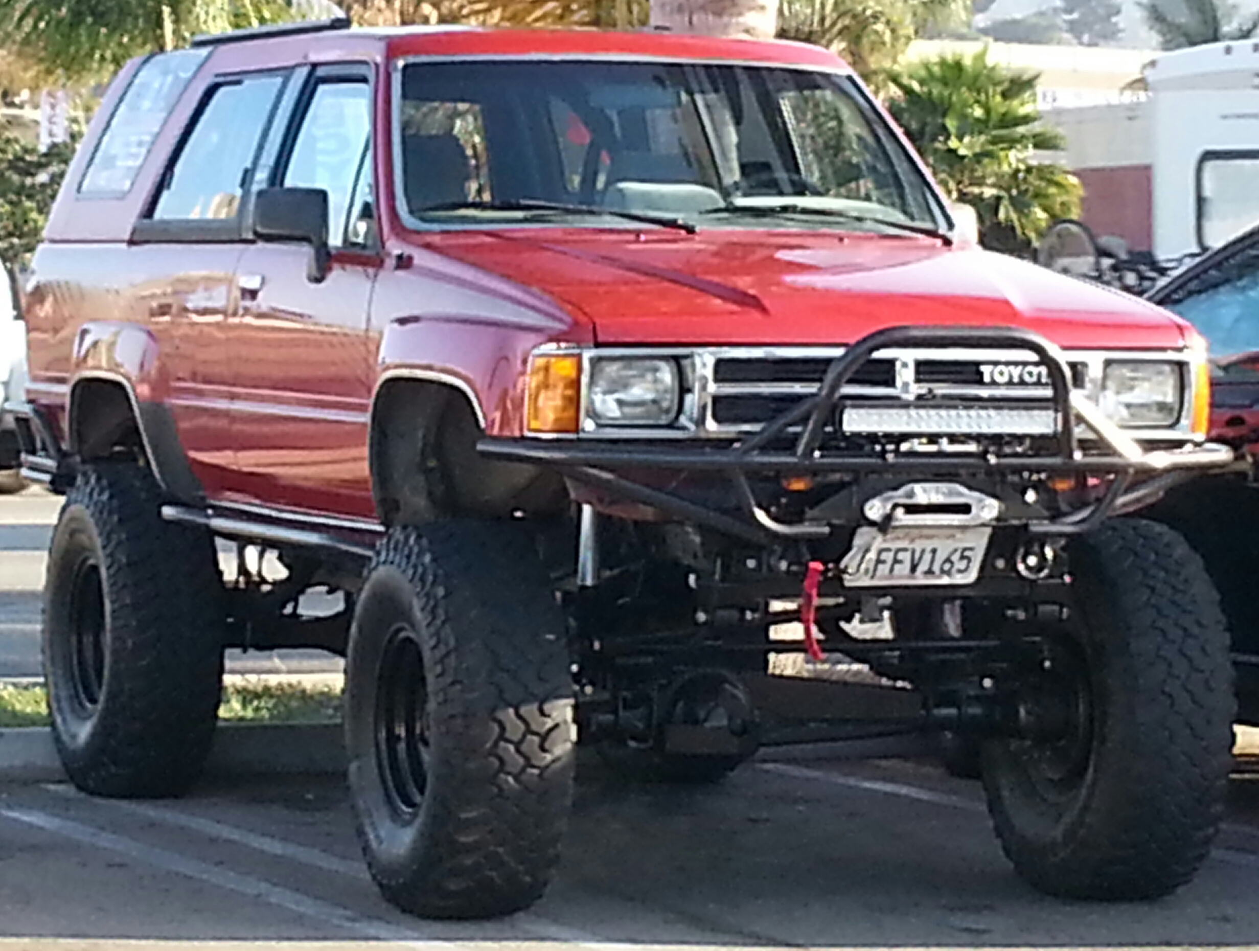

Nutty,.....
I ran my 32x11.50's on 15x8" wheels..... Some worry that when wheeling on a ratio of wider rim/ tire width lesser (10.50 or 11.50 on 10" wide), they could more easily pop a bead free. The Hawaiians go often for the 10.50 on 10-12" wide wheels..... There's a name for it... cant remember.
Even my 35x12.50's are on 8"ers.....

They're better on an 8" wide rim because of the bead holding capabilities at lower pressures. But they also work on 10" wide rims. A 10" wide rim is the largest recommend rim width for the 32x11.5 tire.

Chef, don't post pics of Ruby in my thread! You're making mine look bad

The guy that I got these tires from have them on 2006 Tacoma 4x4 longtravel rig from hell and went crazy quite what often. Period. I've seen the videos. Period. He never wants had any popping of beads........ or otherwise drama.
