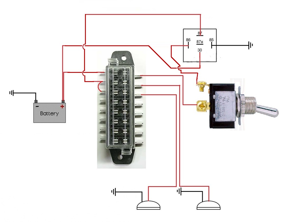

This is what I mean about having a fuse for the switch and each light. Just something I made in my free time.
Not to scale, of course

almost. 2 wires crossed:
Ahh thank you! I knew something didn't seem right when I posted that
