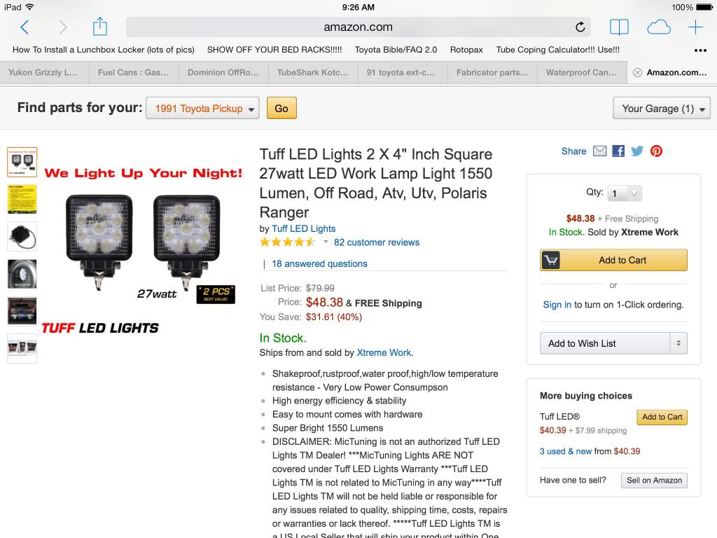

Yah we decided that we were not going to put the air chuck in the square hoses and we moved it to the bed. A will put some expanded metal behind the square holes and then LED lights I need to find some, would amazon 45 dollar ones work? And then i will be putting mounts for a d ring 8 inches further out from the end of the squares. The mounts will be weld through and they will have 4 more inches extra that will pair up with the bars that mount the bumper to the frame for the most strength. Then further from that I will put holes to slide my hilift in to for a secure mounting point at both ends.

Here is what I was looking at any ideas?

Those are great lights, have heard good things. Stay away from the Chinese stuff, heard moisture tends to get inside the lens.

Only thing I would look into about the lights is ordering direct from Tuff lights. I just saw the disclaimer on there, worth looking into if there is a price difference.

Unfortunately the price is almost double on the website so I will stick with the amazon ad.

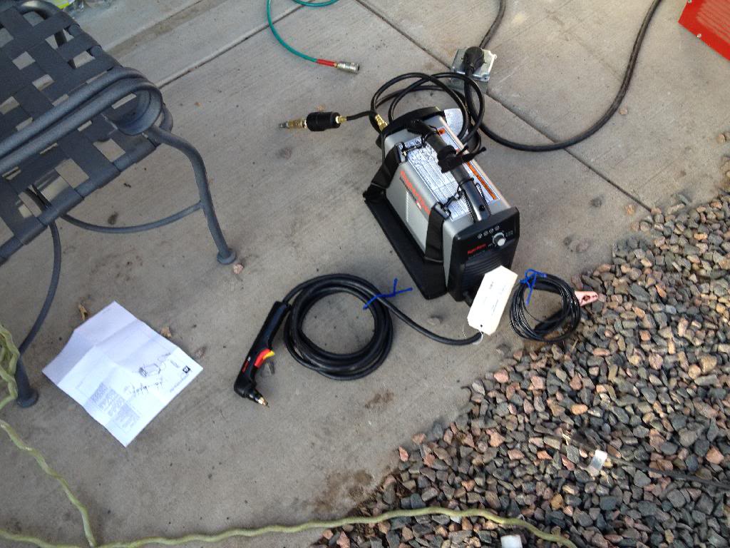

so i got home today and.....

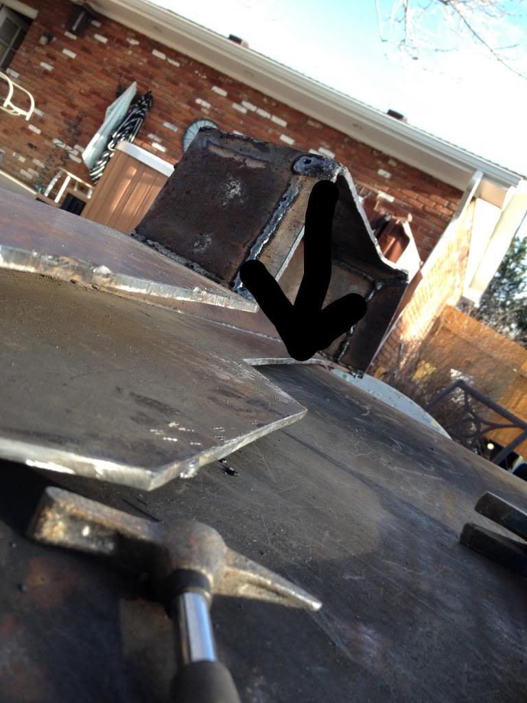

a hypertherm powermax 30!!
had to get it broke in...
so i got the bent pieces cut and rebent? to NOT square to line back up and match the other side.
so you can not see it but starting at the arrow going to the tip it bends down about an inch and sense that side is all welded up the only way i could think of is bending the other side and welding shorter lengths and cool in between to minimize warping Name:  40b10caa-6dec-435d-a1c3-8646c4b23f4f_zps9f762e16.jpg
so i like the plasma cutter a lot and it make quick work of fixing and placing this piece to where it should be. now i got some tacking of other pieces on and them a LOT of welding im getting excited though, its looking cool
jake,

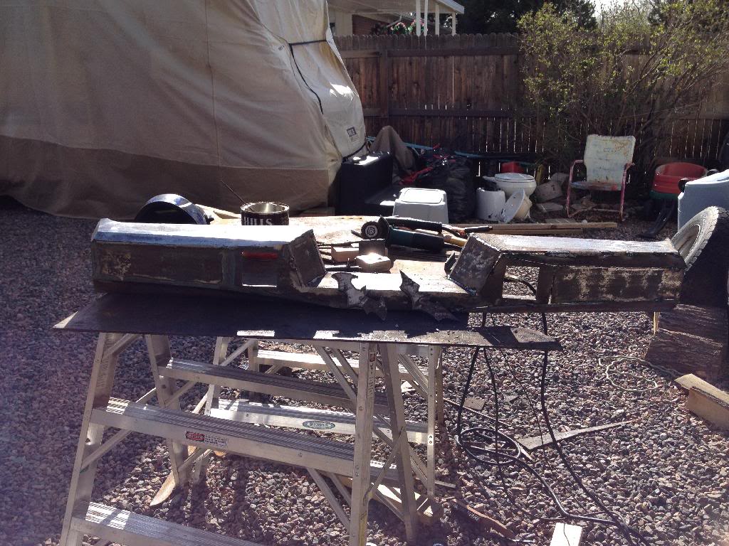

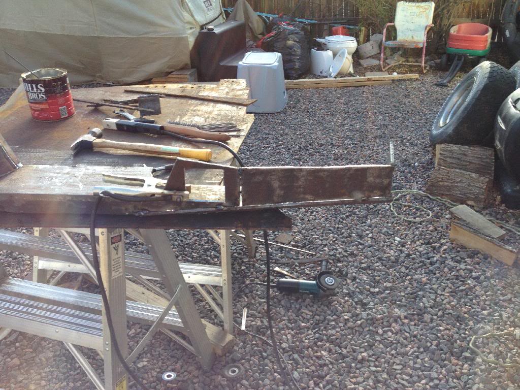

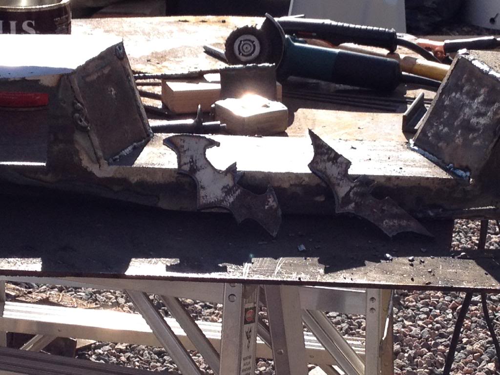

just a little up date on how the bumper is going. i love the plasma cutter it made quick work of cutting the side apart and then after some persuasion with a big hammer i got the same bend in the bottom plate that was so easily obtained on the other side from some heat. any ways the plasma cutter came in handy again fitting the pieces back together. i got the side re tacked back together and got it squared back with the other side. it matches really nicely so if i can learn some patience i will let the welds cool and get the rest welded up
