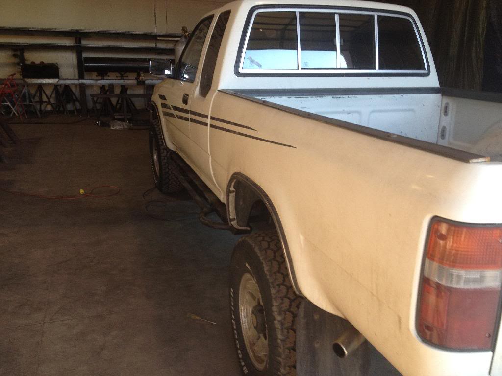

I got pics during lunch this is with the front lowered but it does not matter because it still shakes!!
This is front right from the back

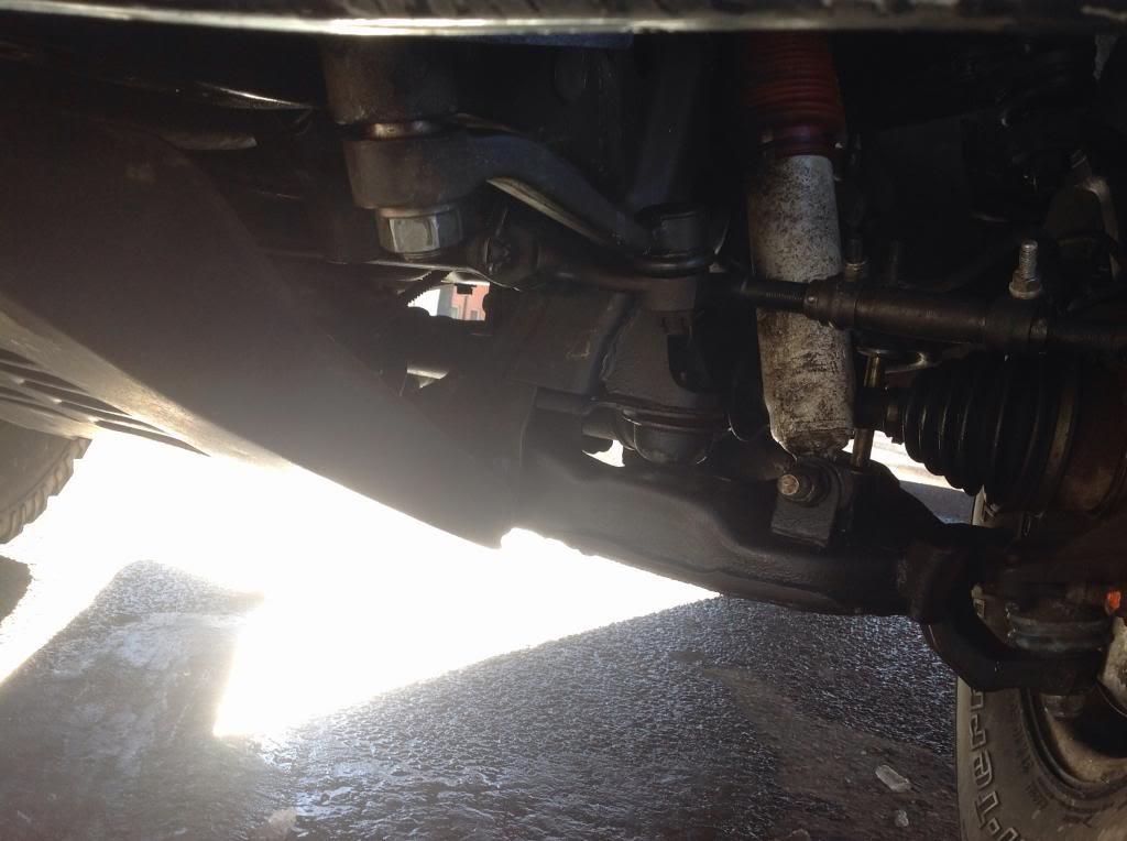

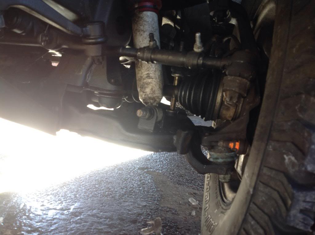

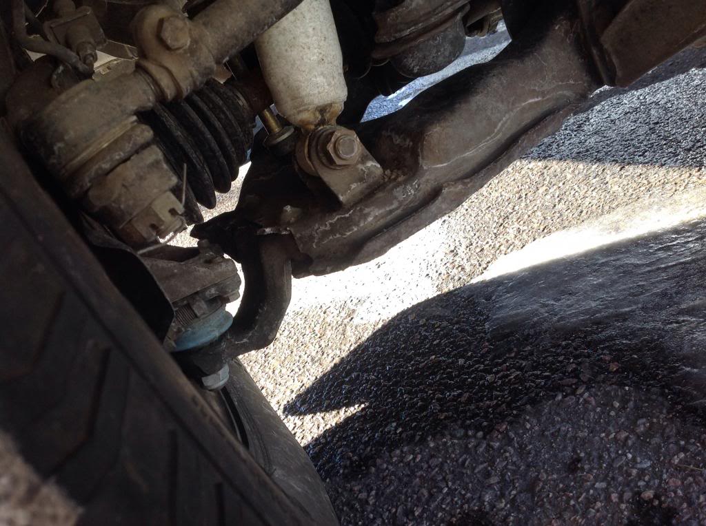

Here is front right from the front but the steering stop on the lower is gone? Don't know what happened there
Might be showing this one again but look at the steering stop bolt. They told me they have no idea why my steering radius was lengthened by 4 feet!! Hhe I can't imagine why??

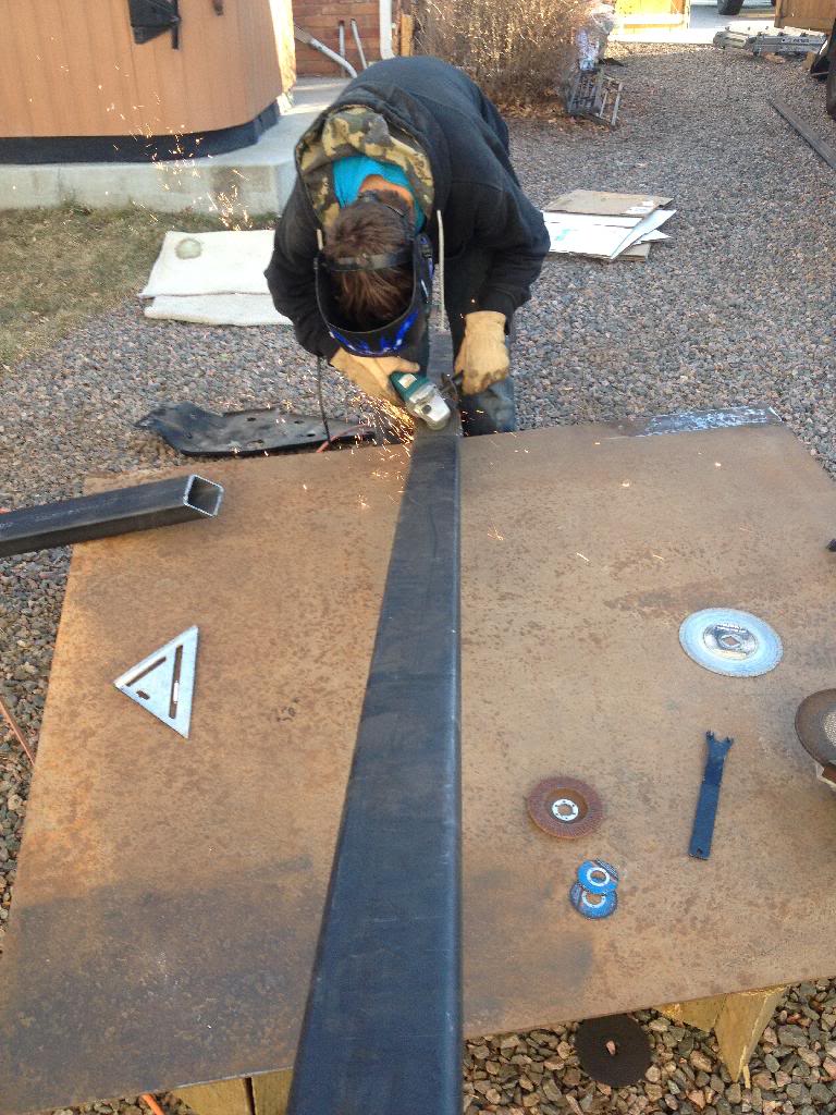

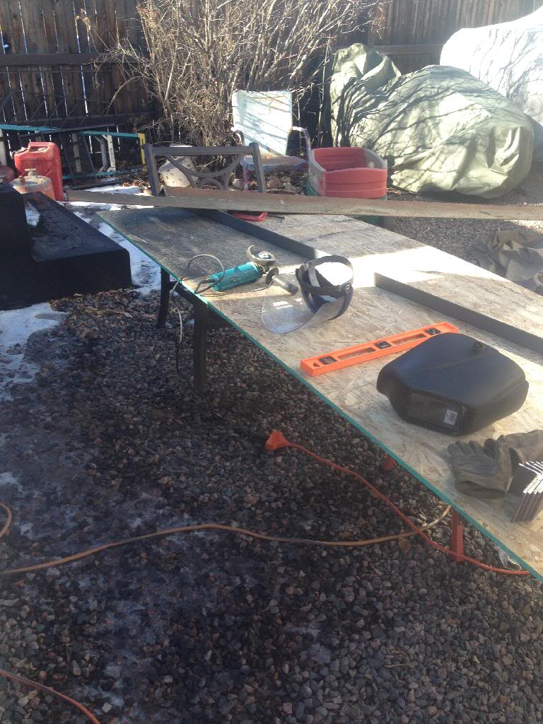

Ok so I wanted to make my own sliders so we went down to the local scrap/ metal yard and got some 2x4 by 3/16 box tubing and some 1 1/2 by 0.120 DOM tubing and we also found a 55x64 quarter inch plate that weigh 250 lbs
Good thing I had my dad's material truck and some my brother and best friend there. We dropped the tube of at a shop that said they could bend it for us and then started on the base
My best friend cutting some box tube
Size:  149.1 KB that "table" is the plate we got

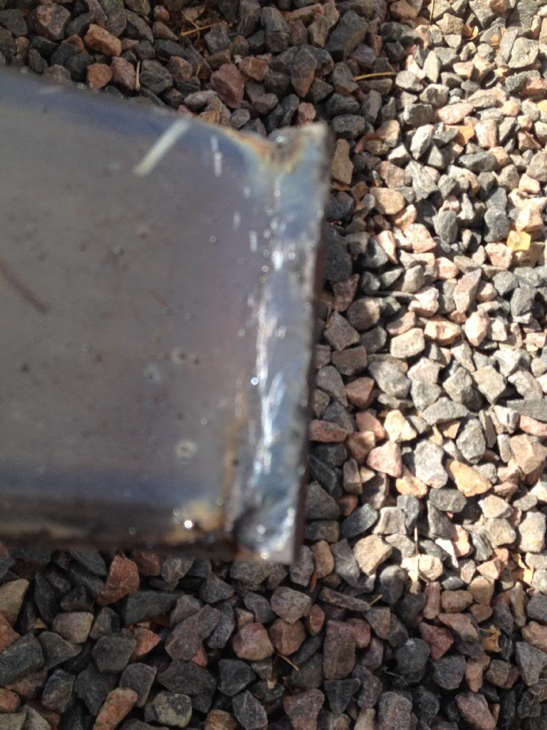

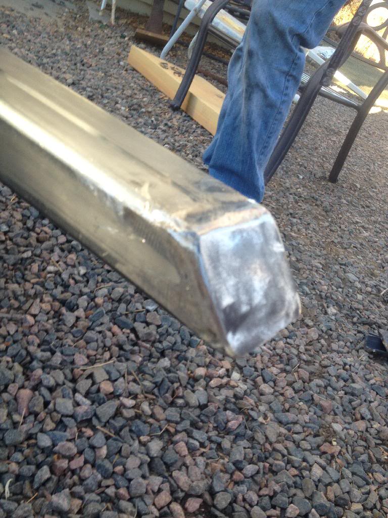

How good are my welds

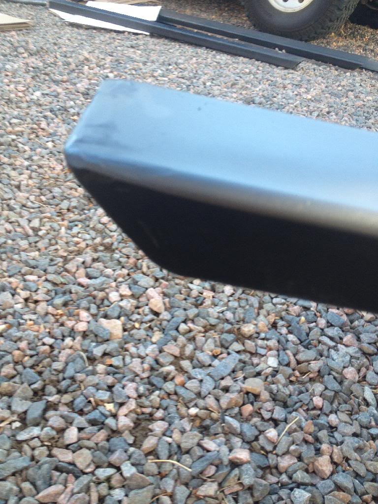

Then we grinded the corners down and shined them up then hit it with some paint to see our work

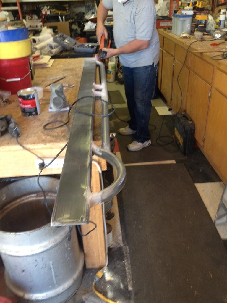

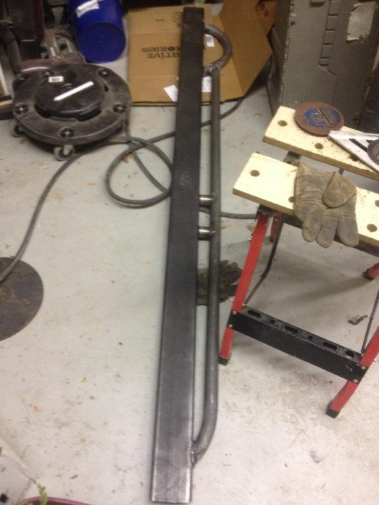

My friend picked up the tube back all nice and bent while I was at work and the first thing I water to do once I got home from work is mock it up to see what it looked like but after I clipped my shin on the corner of the steel plate I desired I could wait tell the next day. So herb is what it looked like mocked up

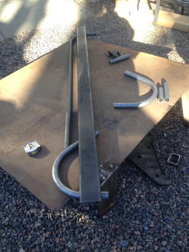

Now I had to wait tell the weekend to start welding. I had my uncle weld the tubing because he knows what he is doing and I wanted the sliders to last for more than one rock
So we had a busy weekend we had welding

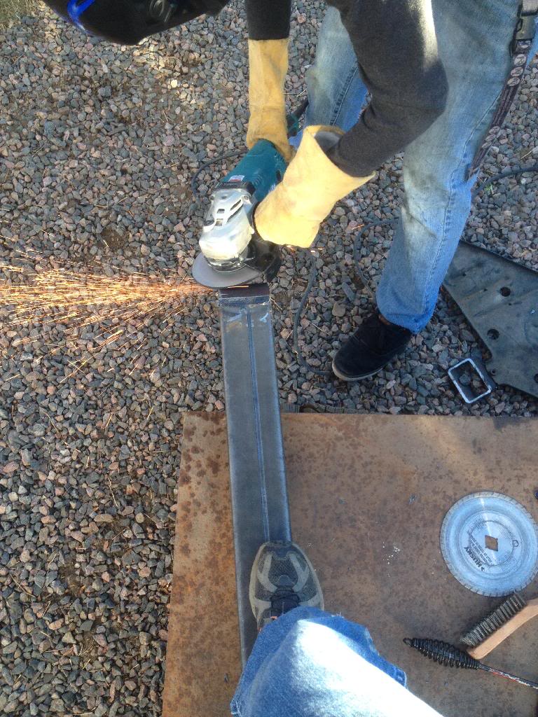

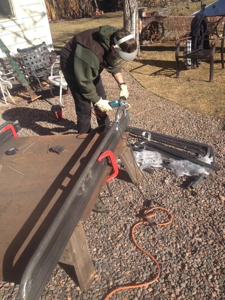

And had to find some thing for my brother to do so I gave him a grinder and told him not to go through the metal

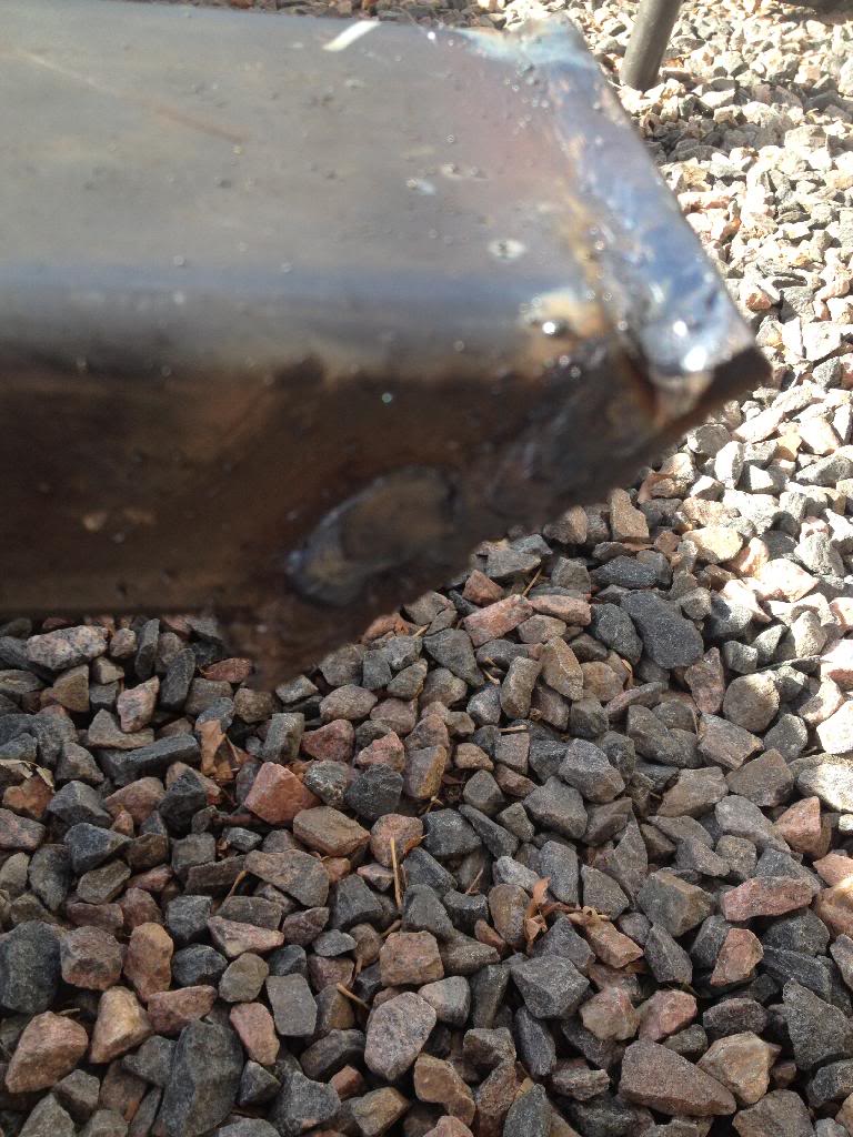

Nice work on the sliders! Make sure to plate your frame when you weld them on.
Its hard to tell about your welds, the picture is a little blury

Oh and here might be a better pick of the weld still blurry but here you go

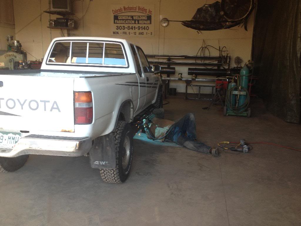

sorry no pics of painting but i went to the welder and got them welded on

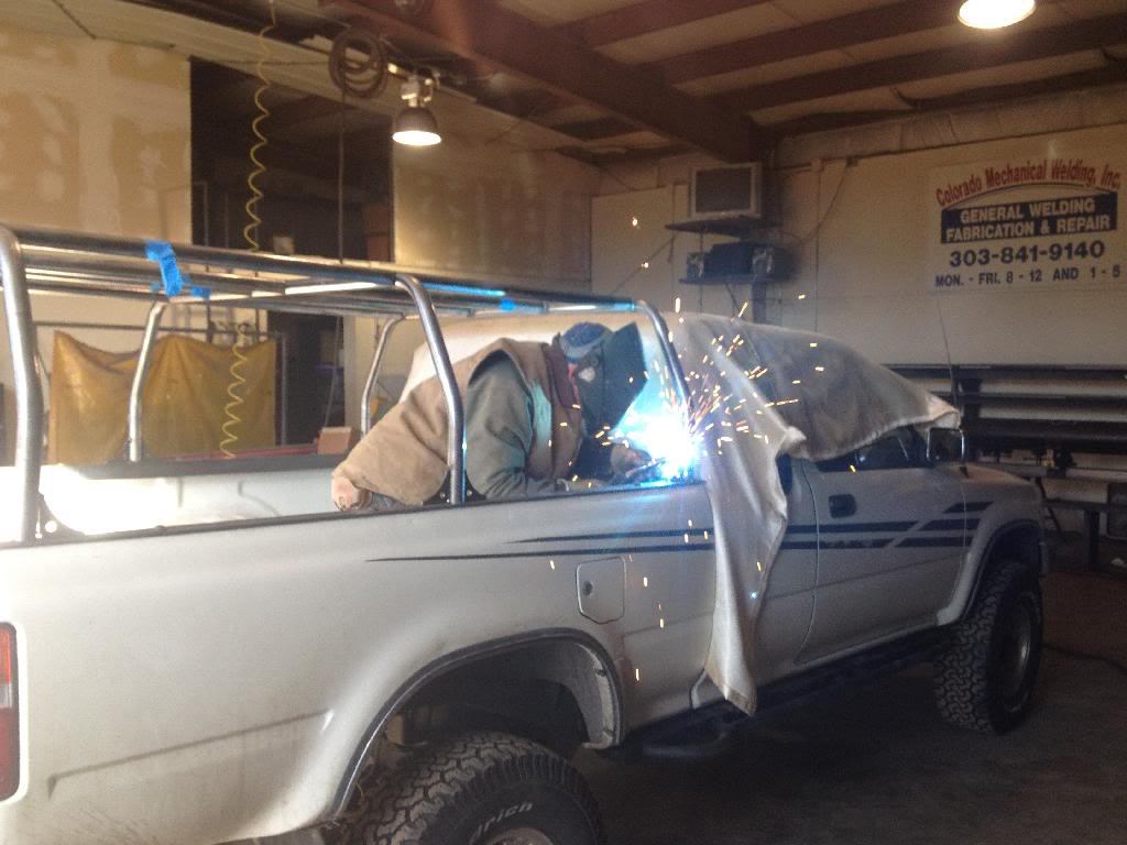

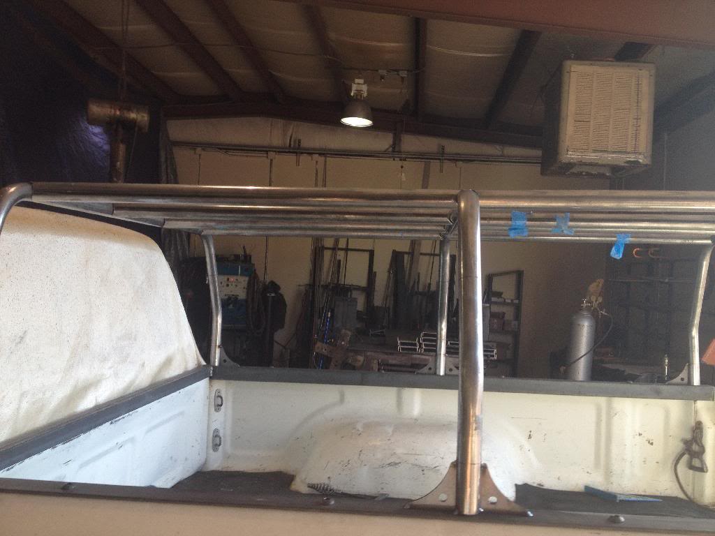

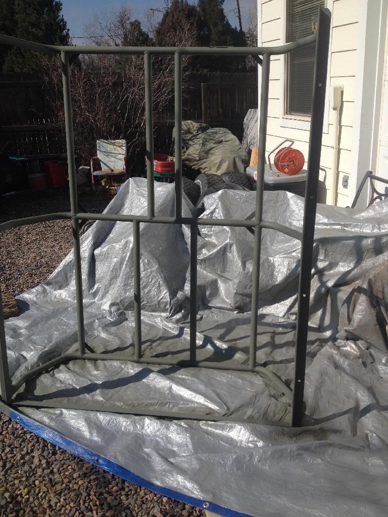

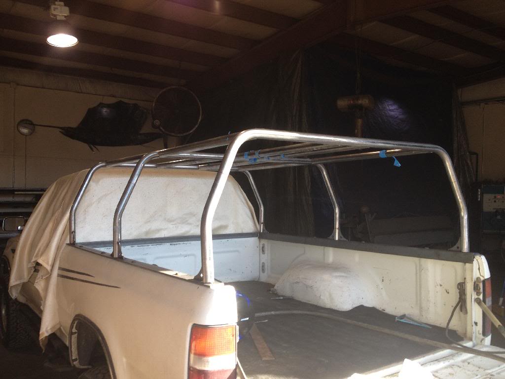

and on to the bed rack
the parts i ordered from all pro offroad and added 4 more of the cross members and 4 more of the bottom corner gussets
the kit is for 95+ tacos so i did not order the bed rails. instead i used some 2x2 angle for the sides and one 1.5x1.5 angle for the back of the bed just for support/more places to mount things in the future. and secured it down with 4 1/2 inch bolts on each side.
then i got it welded at the same time as the sliders

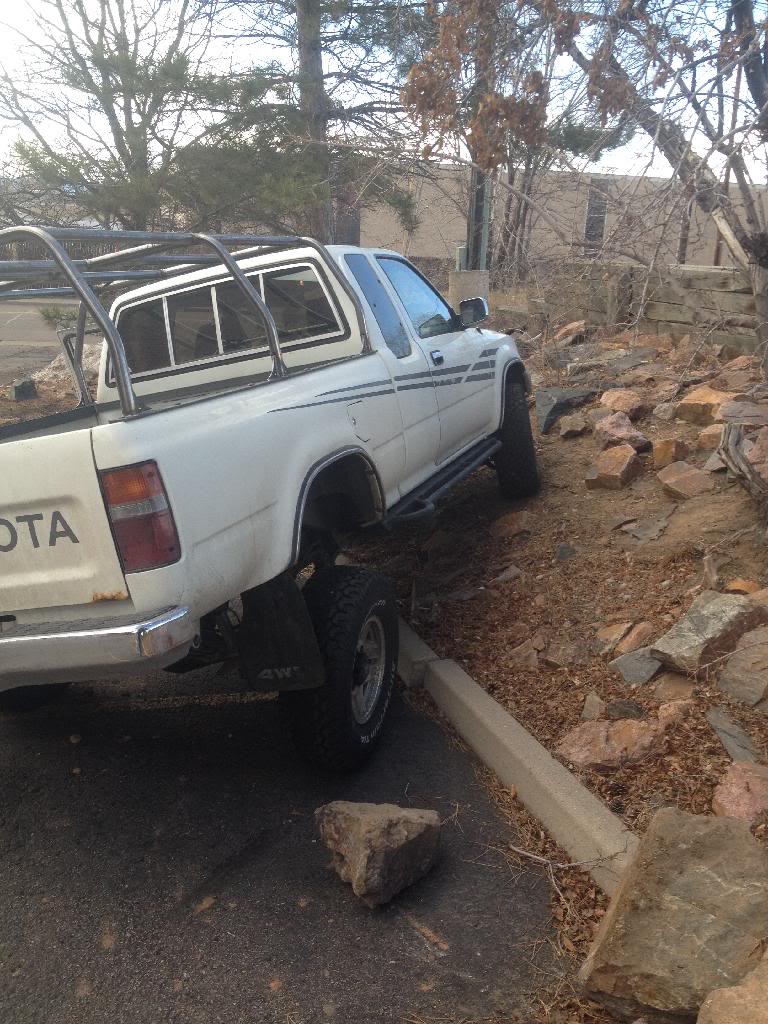

flex pic/ rack

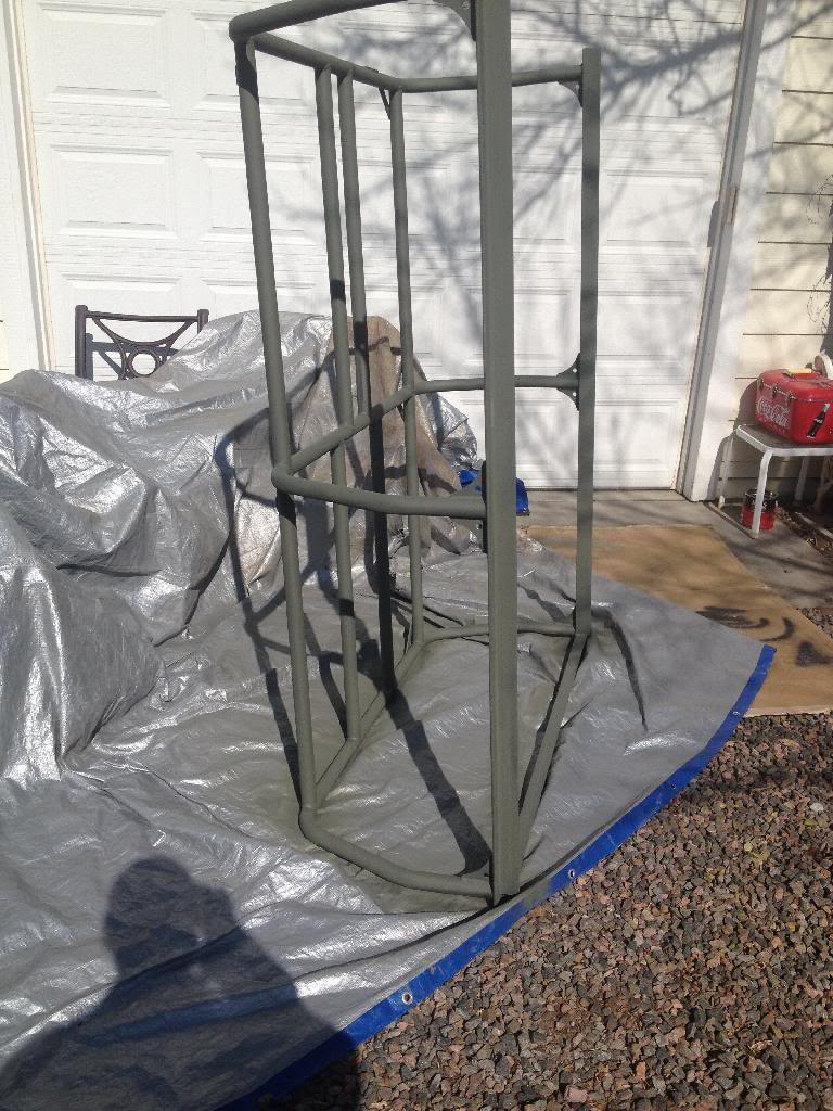

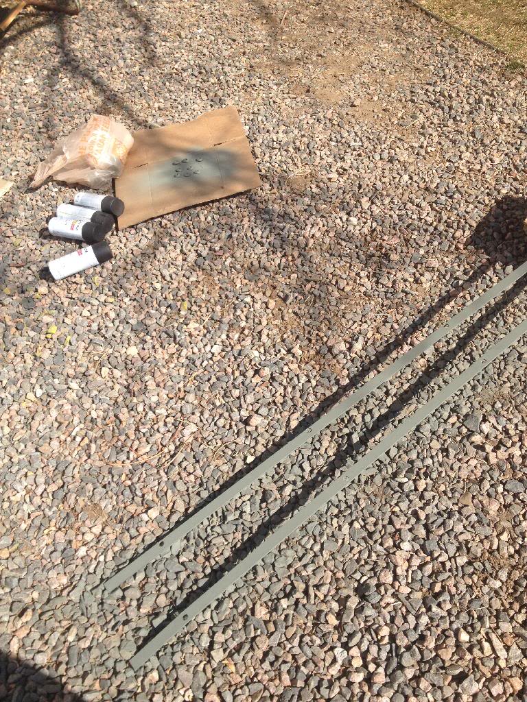

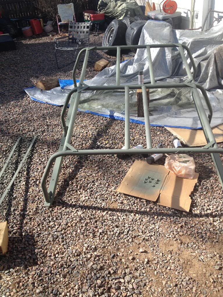

i dont think you can see any of the top but i cut out 8 angles from 3/16 by 1 inch bar stock and had them welded on to the top corners.
i do have pictures of this being painted.
im very happy with it
