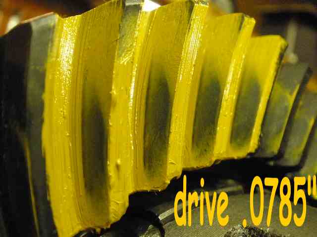

next 3....cleaning and smeering the sleeve lock on the bearings.....the final drive pattern that I am pleased with.....the final coast.
It appears the pattern was .011" (.0895-.0785) too deep the way Mike received it. The sleeve lock is drying now and I will finish it up tomorrow. nite nite. ZUK

Glad to help out. The way it was set up before it would not have held up much over a year with any offroad use. Now it has some PPL and CBPL and the depth is right on so the pinion teeth won't chip on you like it might have before.
