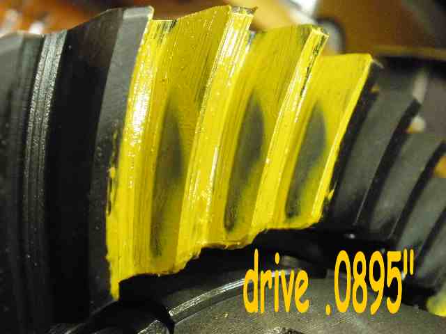

Here's what I have so far.....pics are low res to help for fast downloads...
forget the pics for now....I will make a link of it.

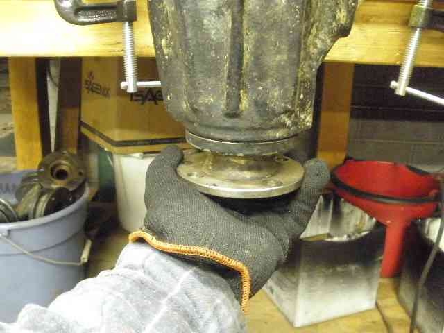

CBPL is none...
PPL is none.....
BL is only slightly high....8~10 thou range

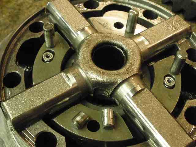

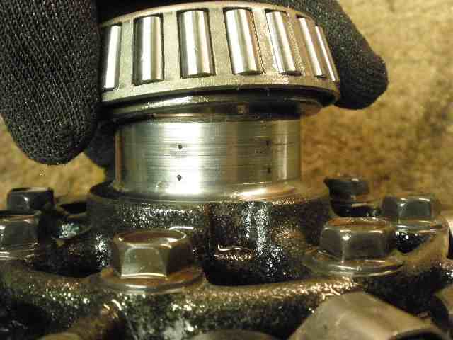

one carrier bearing fell off
one broken pin on the lockrite(I have spares)
more to come

No pics but
what is this?
"one carrier bearing fell off"
I need to see that.
Old Dec 2, 2008 | 05:27 PM
  #97
ZUK's Avatar
ZUK
Joined: Oct 2003
Posts: 1,858
Likes: 28
From: Prescott AZ
The pic display mode is not friendly to me so I will save them all and make a link up quick.
The carrier bearing pulled off with just my finger power....left like this it would eventually destroy the case and possibly the Yukon ring and pinion. Back to work
Old Dec 2, 2008 | 06:50 PM
  #98
ZUK's Avatar
ZUK
Joined: Oct 2003
Posts: 1,858
Likes: 28
From: Prescott AZ

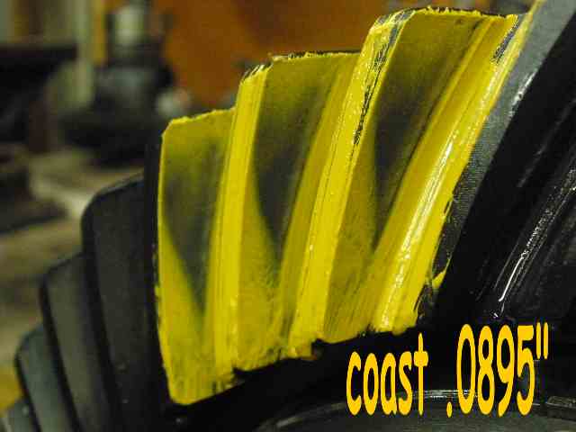

904runner or anybody else....
shoot me an email address and I will send the whole stack of pics.
Pinion was too deep...there were 2 shims (.077" and .0125") that totaled .0895". I just stepped it down 5 thou to .084" and it's still too deep and I'm almost positive when I change it again to .0805" that it will be sweet or slightly deep(my generally preferred depth).
back to work.

first 3.....showing how loose the CBPL was....the pinion had no drag....and the drive side of the way I received this 3rd.

the next 3.....the coast of the original set-up.....the carrier bearing that came off with finger power....the broken pin on the Lockrite
