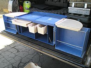

...I plan on buying containers that fit on each other that will hold different items. One container will be food, another for tools, another for utensils, and so on... ...
I just saw the "Dosko Campmate Chuck Box". (Search Youtube for reviews) Just as big as my minimal plastic tub, but offers better organization, and because your stove could be on top- not in front of the cubbies- things can be taken out and put back as needed; it means quicker pack-up. Too bad it's been discontinued. I may have to build similar one myself out of thin plywood.
