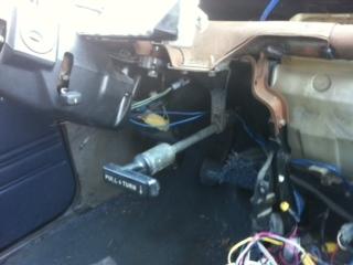

Over the course of the next few weeks and a few trips out to the lake for some mudding to see how she performed as it was, I began checking for the quirks/odds and ends that needed attention with the truck. This rig was purchased close to the winter time and the mornings were chilly enough that a heater would have been appreciated, which this truck did not have. So i began investigating. Checked the water valve and found both heater hoses on either side of the valve (supply and return) were hot as hell, indicating we had heat to the dash, but wasnt blowing hot air. So i began the search for the heater core and hvac doors.

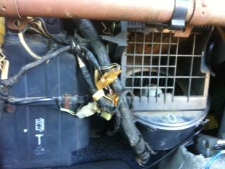

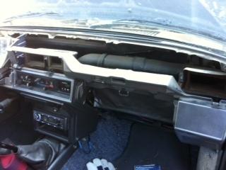

pic of blower motor/door assembly
I pulled the heater core housing and evaporator out. The evaporator was completely clogged with lord knows what kinda of debris (sorry, forgot to get pics of that). I cleaned every thing up as best possible and reassembled. Oh, and to fix the heater, I found that my dash control assembly was pretty much demolished and all the cables are siezed (minus the fresh air/recirc door cable, that one works
). So anyways, I opened the heater door manually and voila, I now have heat, and yes, its hot

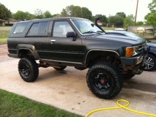

Next came the lifting. After I got my Yota, I started a revolution at the shop (I work for freightliner) and a couple other guys wanted one too. I helped a guy find a 93 reg cab 4x4 long box and when he got it to the shop, we were checking it out and found it had 3" blocks under the back end and a 5th wheel hitch (apparently they didnt like it to sag and added blocks to compensate). My buddy didnt like the blocks under there as it made the truck look like one of those hillbilly 2x4's where they mount 38's in the back and little donuts on the front and think it looks cool. So, we swapped even steven, took my stock u-bolts and gave to him and I in turn took his blocks and put them on the 4runner. This made my truck look like the hillbillyride now which I had to correct. I bought some 1.5" ball joint spacers and cranked the t-bars just a little bit to get the ride even without screwin up my ride quality too bad. I purchased a 3" body lift kit from Rough Country Suspension and installed it. Got my ride to a perfect height for me (just high enough i have to hop to get in). Next I added wheel spacers and tires. Bought this set of Interco trxus's m/t off craigslist from a guy in town, 33's for $350/set and they only had like 5k on them, still had the tits on the tires. After all was said and done, the truck went from looking like this :
to this :
As you can see, I also painted the rims to match the truck, i like it, think it kinda looks recon with the top on
to this :

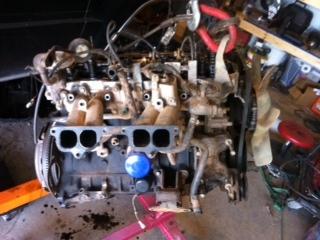

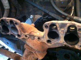

Alright, well, here is whats next...crappy enough, i was actually about 5 hours from trading this truck to a guy for an 87 samurai (just to sell, but it was worth about $1k more than the 4runner). Anyways, on the way home from work, just cruisin along, *knock* *knock *knock*, took it home and parked it in the garage (about a week or so ago). I took the engine out yesterday and found #1, #2 and #3 rod bearings spun. I forgot to pull any of the mains to check those (hoping to god they are ok). Here are some pics :
So, im going to rebuild (providing when I pull the main caps I dont find those spun too...). Got a couple questions though, and I may need to get ya'll some more pics to show you what im talking about, but here we go. Notice on the pic of the exhaust manifold, its very evident on #3 port on exhaust manifold, you will notice it is whitish in there. Its the same on #2 exhaust manifold port. To me, this indicates extreme heat. Also take into account this truck was an original turbo truck and has been converted to a 22re by the previous owner. I will tell you that when its dark outside, even just easy driving around, the exhaust manifold gets hot, and I mean RED hot, and bright too, which also indicates high heat. Now i dont know if the PO replaced the injectors back to the regular 22re ones, i know the turbo injectors flow a lot more which could cause that. I do know for sure that air flow is good. Im going to be deleting the EGR JUNK as I rebuild, dont know if its bad or not, but I want it gone anyways (Thank God Texas has no smog laws
) Also, all the exhaust valves and ports on the head are white as well, just like you see there in the exhaust manifold pic (i will get pics of the head maybe this evening and post them for ya). Any ideas/suggestions are much appreciated while I begin rebuilding this engine. Thanking you in advance!!!

and another question, I was told that the only difference between a 22re and 22ret was the head, the turbo had a larger combustion chamber to reduce compression to room to put boosted air. Does anyone know anything about this and how to tell the difference between the heads. And on the block, if it were a 22r, 22re or 22ret, wouldnt the corresponding data be stamped into the side of the block??? mine has 22r stamped in side of block but you can clearly see where the turbo pressure and drain oil lines were installed...and i know the block is different as they did have a different oil passage rifled through the block to accomodate the turbo...

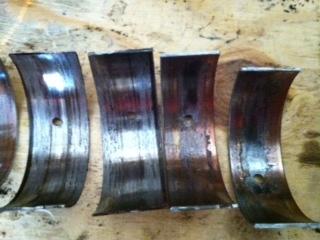

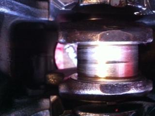

Whew, pulled the main caps and luckily didnt find any that had spun. HOWEVER, holy freakin worn out crank batman....ive never seen main's worn out so bad, original bearings with 242k on them im sure...absolutely cannot wait to get this thing reassembled and running again with some new guts, oughta be night and day difference. Ill post some pics of the crank later.
Aight guys, I NEED HELP. Im gonna be ordering parts for this runner in a week-10 days. Any input would be greatly appreciated. I will be needing : Crankshaft, Rods, Head, Overhaul kit (talked with ted @ engnbldr already about this, he is gonna hook me up). The crank ive found on ebay for $150 (reman) and the rods ive also found on ebay for around $100 (look to be new). Any and all help with this would be greatly appreciated. Anyone think I oughta machine the block (i.e. punch it out, shave the deck, etc). Anyone got any cool ideas for painting the engine? Also, if anyone knows if there is a visual difference between turbo injectors and the regular RE injectors, I would love to know. And the head as well.
