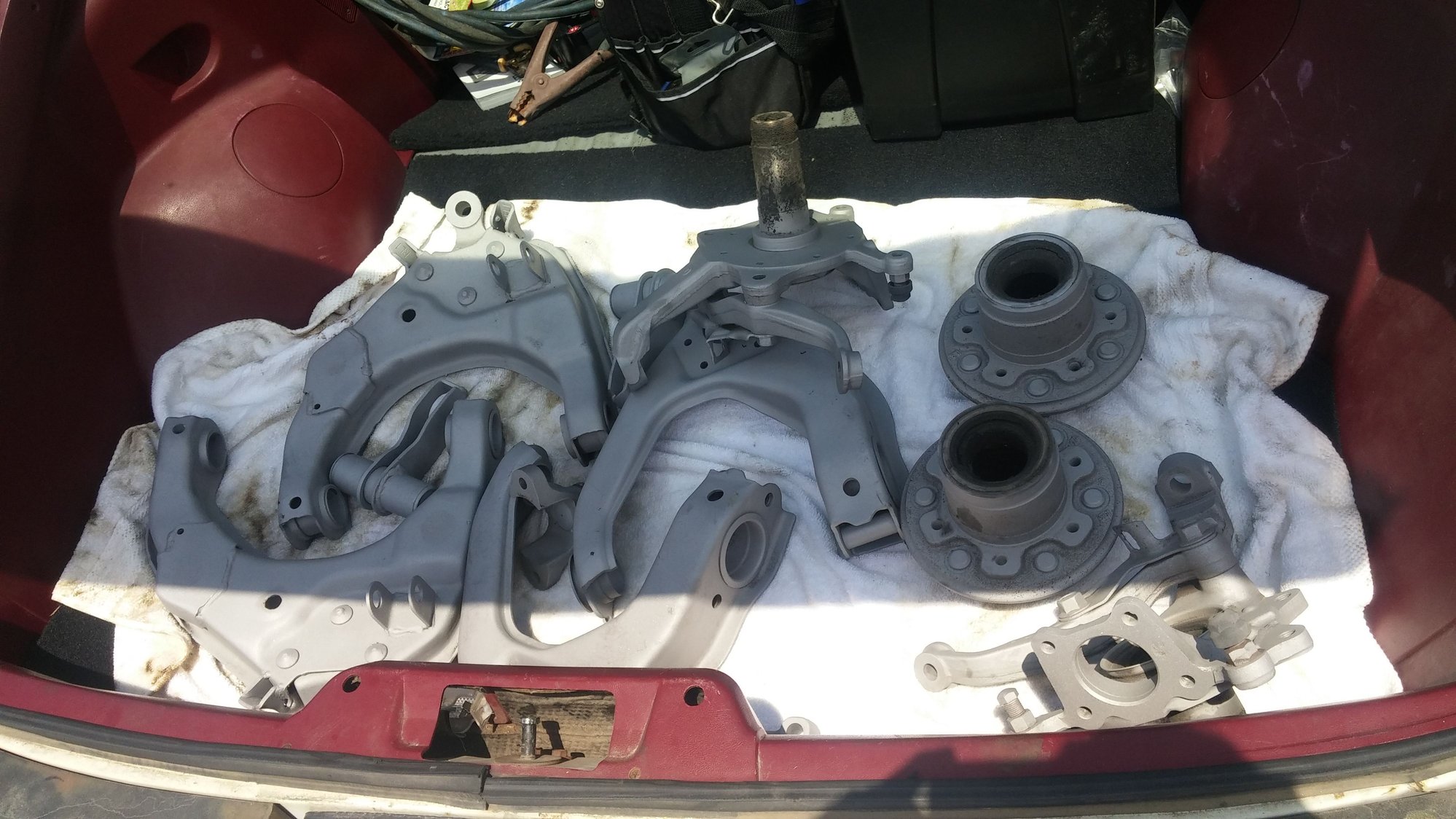

Small update, I dropped off all my front end pieces at the sandblaster today. Hopefully I will get them back pretty soon.

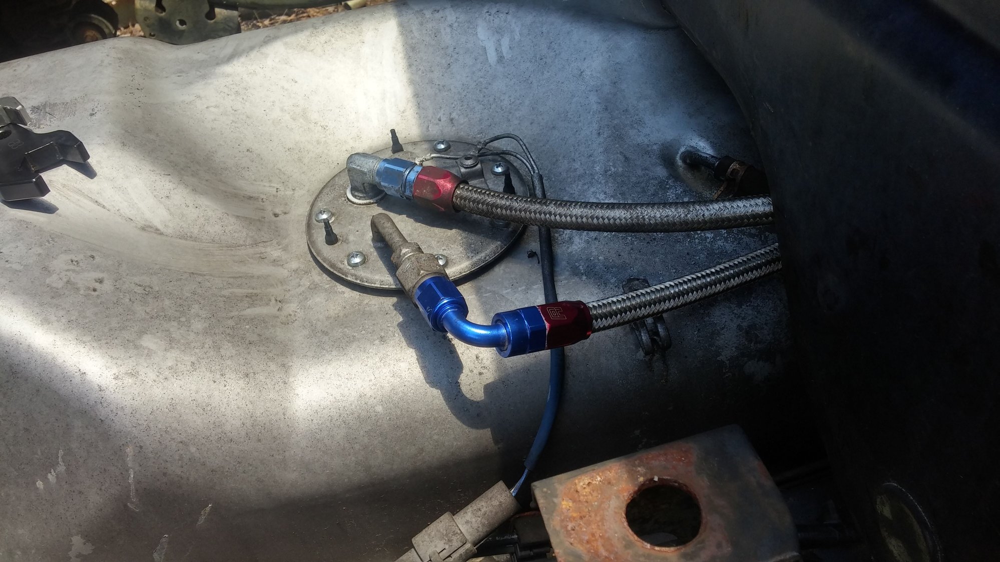

It's finally coming together.
My parts are back from the sandblaster and the fuel lines are done. Also finally got my clutch line hooked up and bled down.
I'll try to post up some more pictures later.

Well, house remodeling slowed me down a bit but I'm getting back to work on the truck.
Hurst shifter installed...feels about like my 6 speed now.

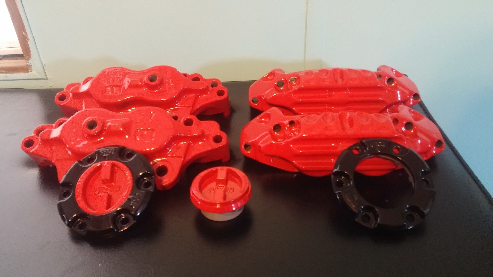

Getting my calipers re-powdercoated
I was terribly dissatisfied with them which was only made worse by the time it took. I'm having them done locally now.

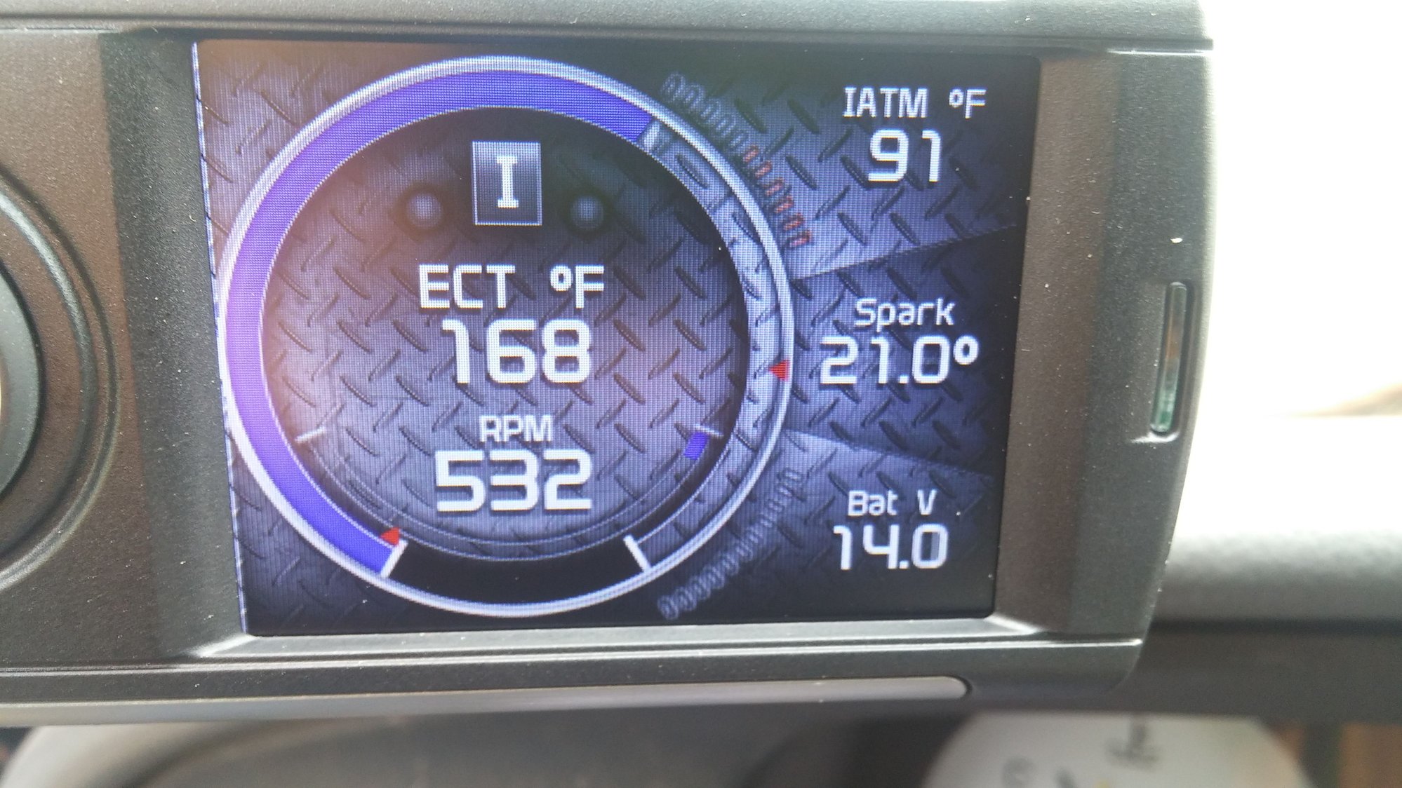

Edge cs2 monitor I got to replace bully dog

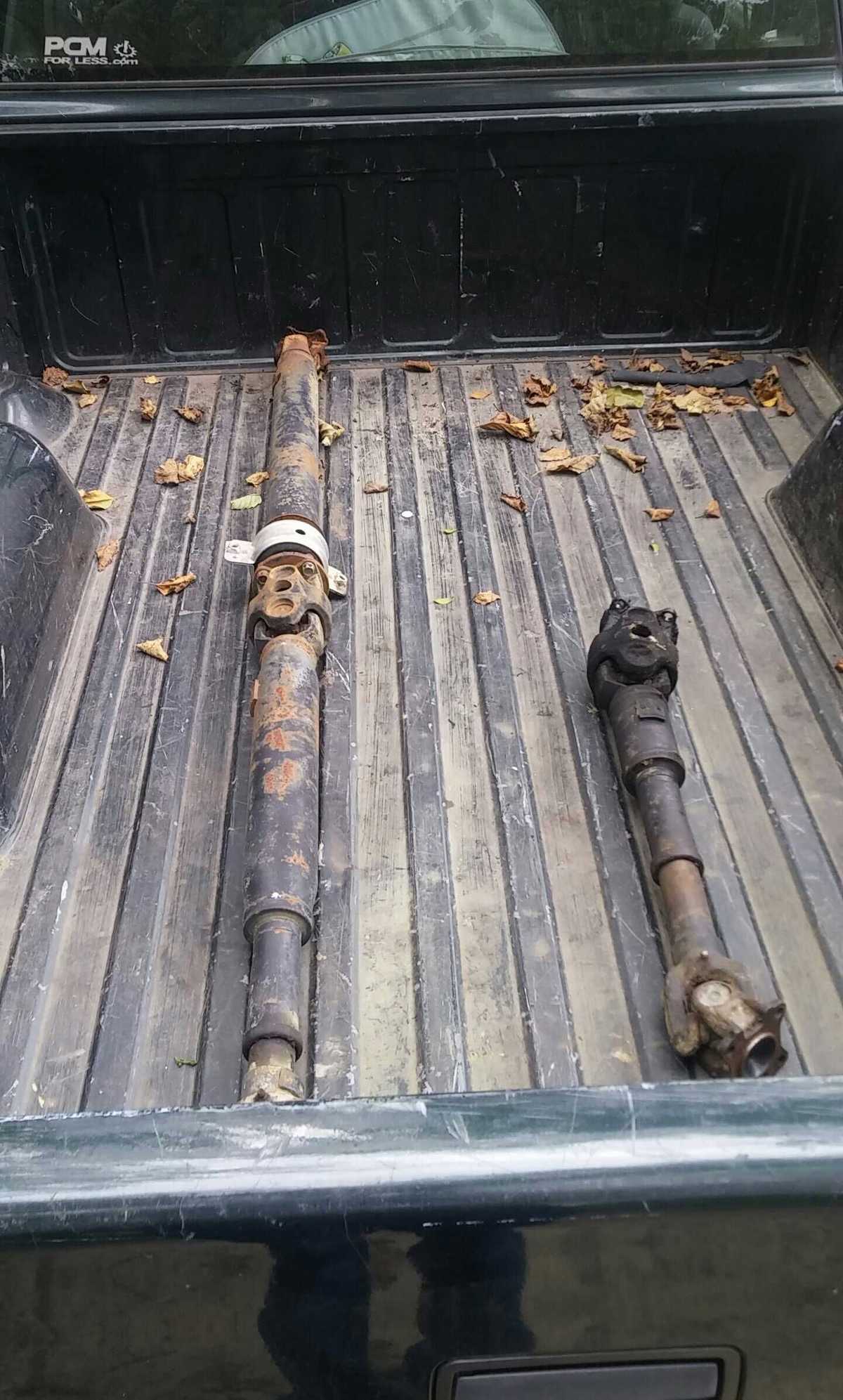

Took my driveshafts in to be worked on, they said they couldn't do anything with the front one so only having rear shortened. I'm going to pick it up Friday

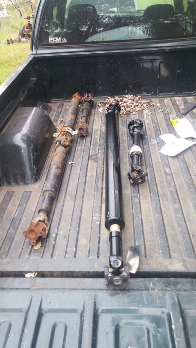

Well, driveshafts were a total bust.
Got two new ones on the way from tom woods.
Old Sep 28, 2016 | 04:05 PM
  #118
skypilot's Avatar
Joined: Sep 2010
Posts: 1,151
Likes: 6
From: Peekskill, NY
From your picture, I would have expected custom shafts. The certainly, nothing there to work with. The rear is probably too short for the front section.
But I'm glad you are making progress, that is a tight fit. Kudo's on getting this done!

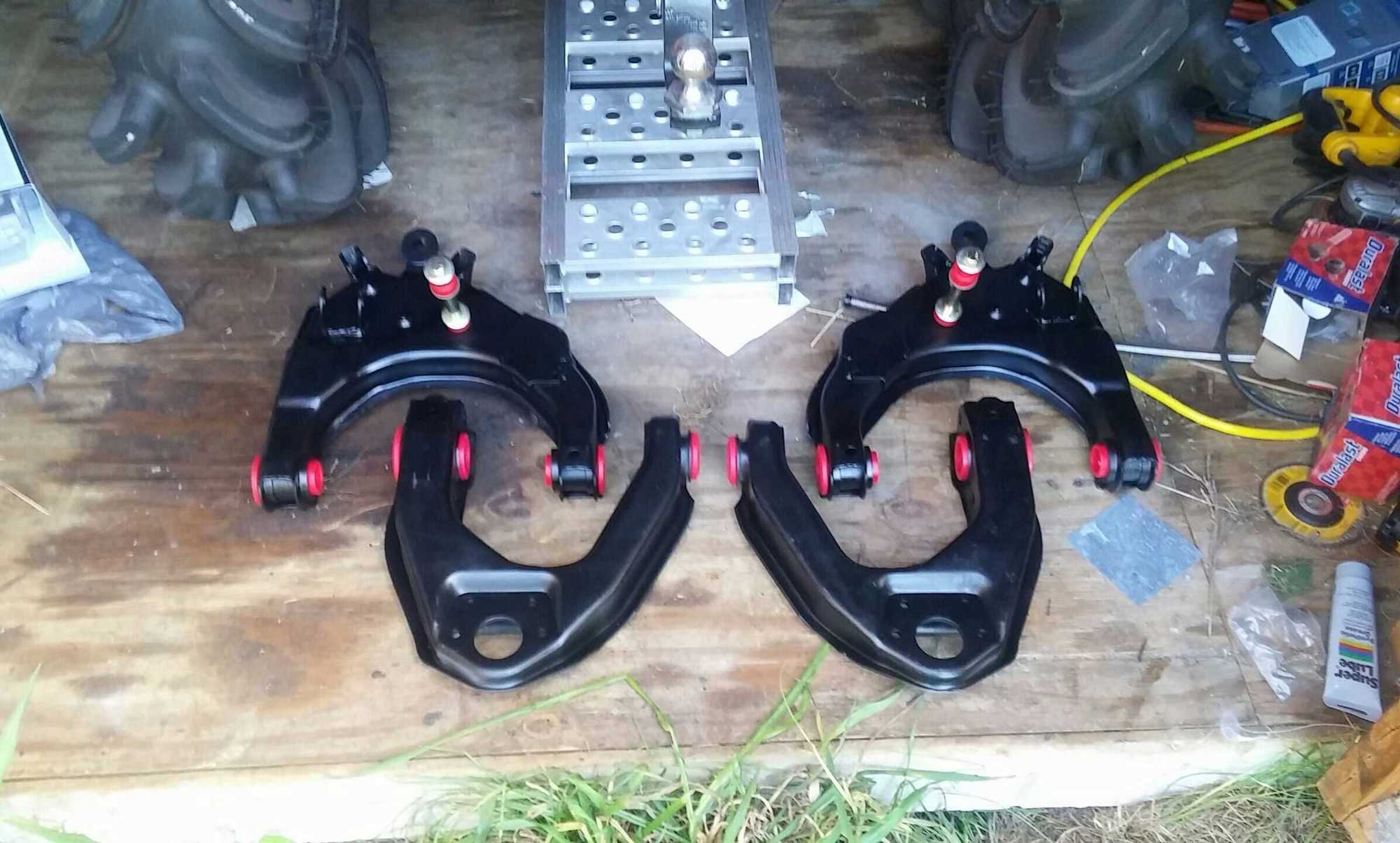

All back from powdercoat and I'm very happy.
New parts came in.
NOW...just need to get the front end back together.
