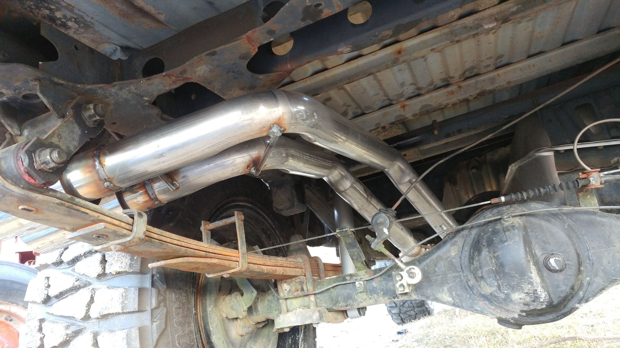

  #133
magpede's Avatar
Joined: Apr 2014
Posts: 81
From: South Carolina
Exhaust is on.
2.5 pipe all the way
This crap happened at the dealership

Old Dec 30, 2016 | 11:32 AM
  #134
vandert's Avatar
Joined: Oct 2004
Posts: 297
From: Ringgold Ga/Chattanooga Tn
those are nice tips to have under the springs and get messed up
Looks like a fun project and can't wait to hear the sound with the Aero's some o the best sounding mufflers out there especially with the headers and I'm assuming no cats
congrats man -
Old Dec 30, 2016 | 11:47 AM
  #135
magpede's Avatar
Joined: Apr 2014
Posts: 81
The tips have a few inches of clearance.
