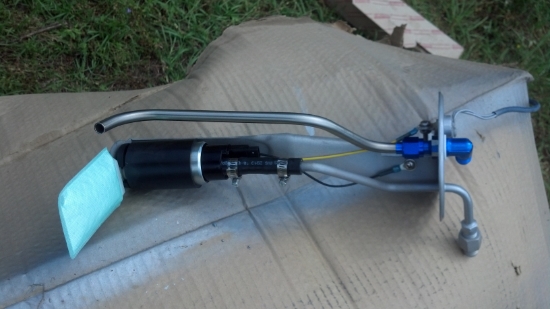

Slowly but surely...still moving along
I tried to bend the new tube up as close to the original as I could
I'm using 3/8 .035 wall seamless, stainless tubing
I'm waiting on my clamps so I can bend up new hard lines and mount them to the frame.

Old May 15, 2014 | 09:21 PM
  #62
HighLux's Avatar
Joined: May 2010
Posts: 2,587
From: Ofallon Missouri
You could have a steady side job making those for people.
Old May 15, 2014 | 09:32 PM
  #63
magpede's Avatar
Joined: Apr 2014
Posts: 81
From: South Carolina
What's that? Modifying the fuel pump bracket?
