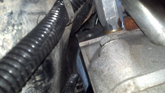

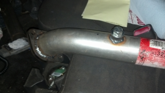

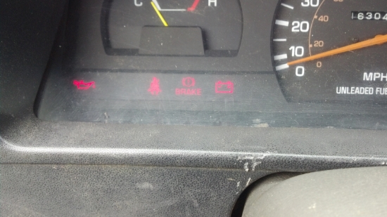

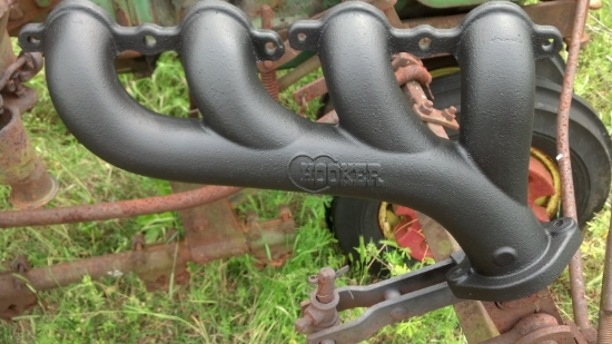

Welllll...first the good news...all my dash lights are now working properly, i got my o2 sensors installed and finally cleaned up my manifolds for some VHT paint

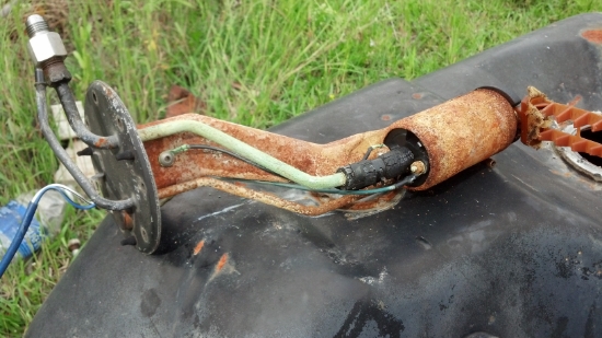

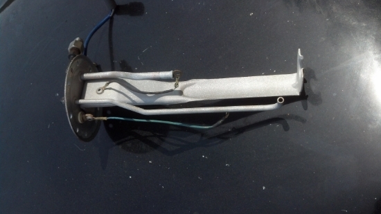

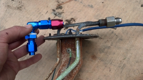

But then some bad news...well...a snag
I went to change out my fuel sending unit and..uhhh

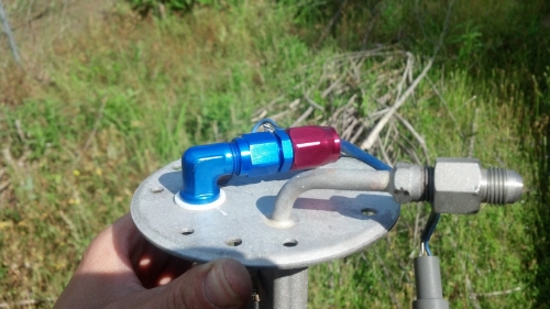

but that's ok...
get that cleaned up...new tank and new pump and i'll be back on my way
i was going to buy a new bracket but that's a bit silly knowing i'm going to cut it up
been working everyday for the past couple weeks..plus it's been raining, so i haven't been able to get much done on the truck

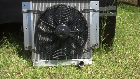

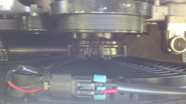

Not a whole lot of progress today due to a late start but at least my electric fan is mounted now. I was thinking about sending the radiator back to be cool to have brackets added but I think this should work just fine.
The fan is 16 inches just in case anybody wanted to know.

Old 05-07-2014, 11:34 AM
  #50
Jthod's Avatar
Join Date: May 2013
Location: Auburn, NE
Posts: 77
Received 0 Likes on 0 Posts
aftermarket universal fan?
Old 05-07-2014, 02:50 PM
  #51
magpede's Avatar
Join Date: Apr 2014
Location: South Carolina
Posts: 81
Received 1 Like on 1 Post
Yes, it's a be cool/spal fan.

I got the radiator back in with the fan mounted
never said there was a ton of room...lol
I plan to add a/c in the future.

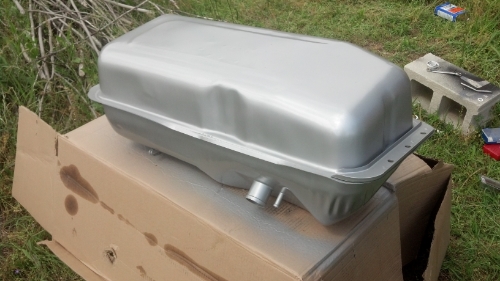

Making some slight headway. I'm waiting for my new fuel pump to come in.
