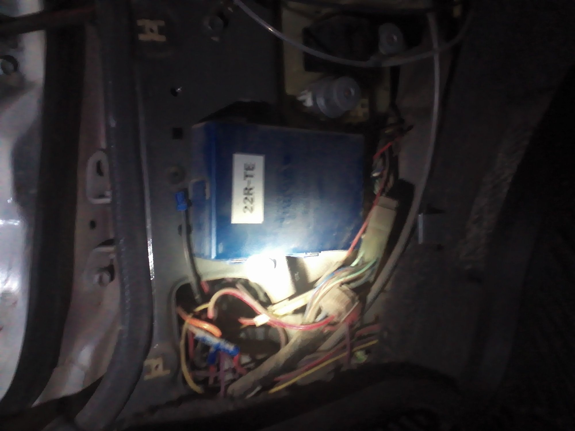

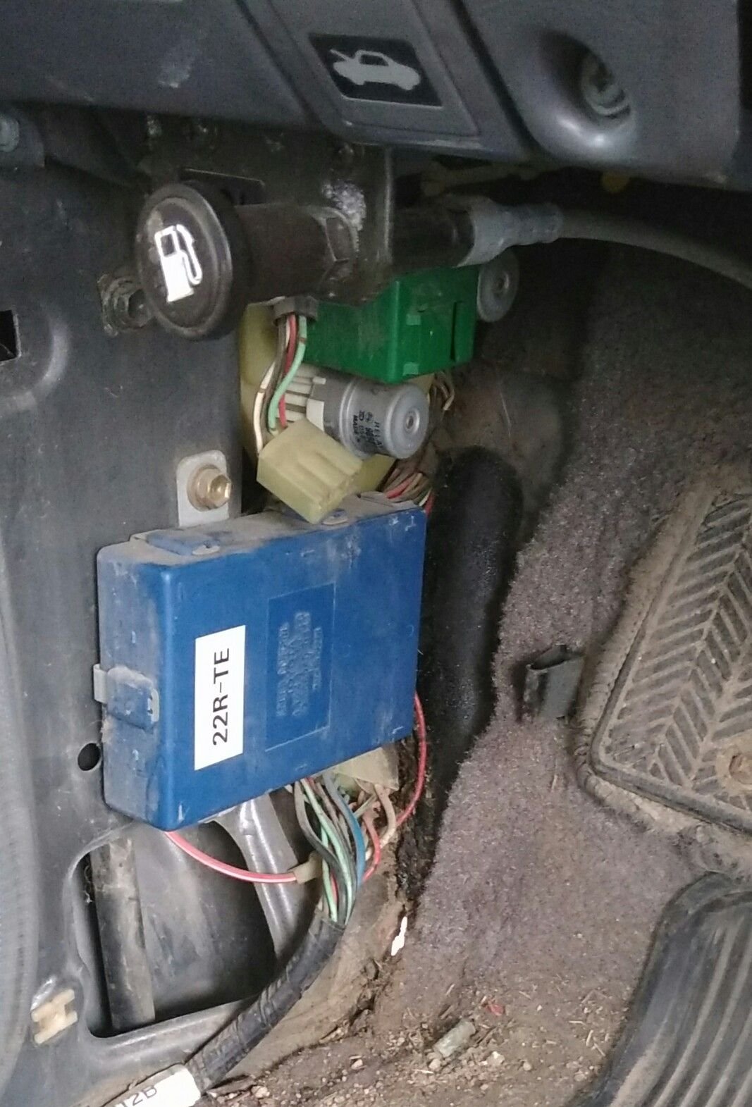

Mystery plug, peep hole on my floor
So I have a mystery plug lurking in the left kick panel. Anyone know what this is?

Originally Posted by Co_94_PU
​​​​​most welcome, sorry I ramble so much about random stuff that piques my interest.
About your new toy, do you know what turbo it has and is it still using the Toyota computers?
Oh believe me it's all interesting and very helpful!
As far as I know it's all stock Toyota parts and pieces. I have the driver's kick panel removed now to check some fuses. I can pull the passenger kick panel and look. It's drivable now except for the seats. The driver's side frame is cracked about an inch and a half due to a screw missing on the back release (wouldn't recline or sit up, I think the PO. Broke the frame pushing on it). Also the passenger seat is missing all of the cables and wires that allow it to tumble and slide. So now I'm looking for someone near me that can weld up the frame for the time being. I'll get seats later. I just need these so I can get back out on the trails!
its likely stock if they didn't use it as a selling point.
do you have that dangling wire also? Maybe power mirrors I'm not really sure, I haven't even touched it, like at all it's right where it was hanging when the cover was opened

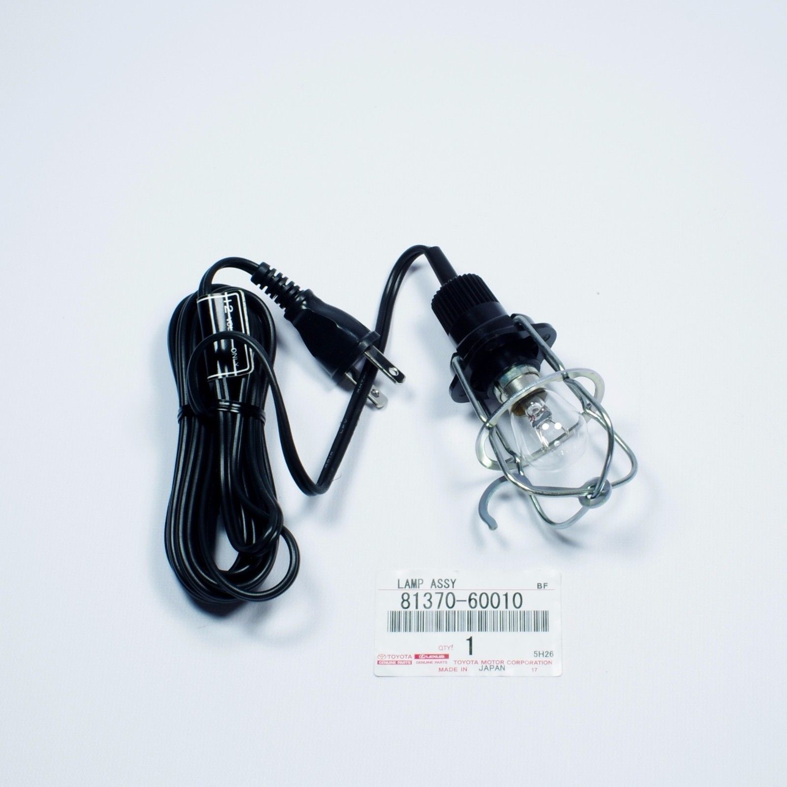

Inspection lamp
Awhile back I asked what the OEM inspection light looked like and was wanting an photo. (I'm not sure where, maybe in this thread?)
Turned up a thread and an image.. a part number and bulb spec
12v 10watt..
LAMP ASSY, INSPECTION.
81370-89101
discontinued for my model but..
Image from this thread.. list price ~40$. Here

I can see that getting plugged into a house plug and getting very bright for a split second!!! Lol
Old Jan 28, 2017 | 09:04 AM
  #172
92ehatch's Avatar
Joined: Jan 2015
Posts: 652
From: Hendersonville NC
i once replaced a 120v oven lamp with a 12v halogen on accident. No bright light just an explosion.

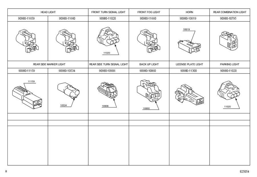

Todo
Convince the local parts counter person to find and print wire assembly diagrams applicable to the early 86 model. (Note: when you see two part numbers listed for your model year it is due to the actual build date, so have the month/year off your door tag handy)
90980 prefix is for wire housings!
Example
