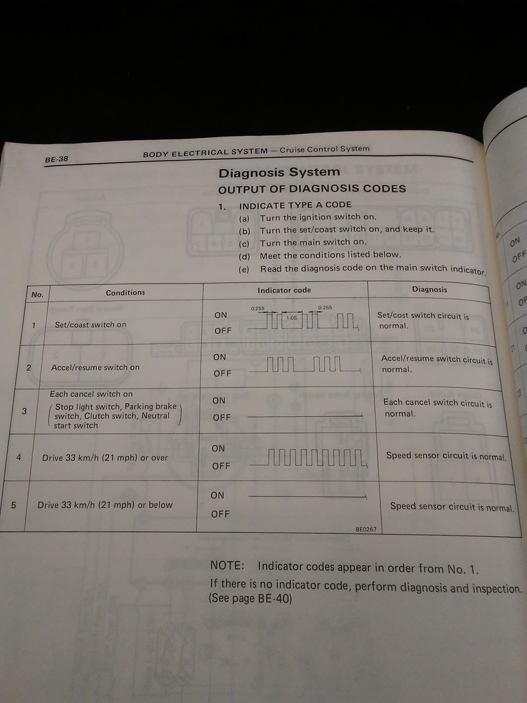

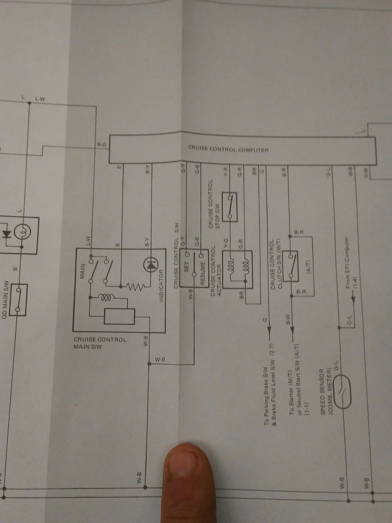

Again with the cruise control, really CO?
Going to be tablet cam I'm lazy today. These are taken from the "Body electric" section of the 88 FSM.
. Schematic
. Inspection checklist
No one answered my question about type A codes. The 85 manual lists the same procedure (key on, set switch on and held while activating main cruise switch) so I'll just roll with that I guess the 86 is the same.
RAD/Ray in the upper right of the schematic above is what I was wondering about (Re: the PM). It ties into the charge fuse. Is that so it is deactivated when the battery is low or something? Guess I should reread the charging circuit explanation

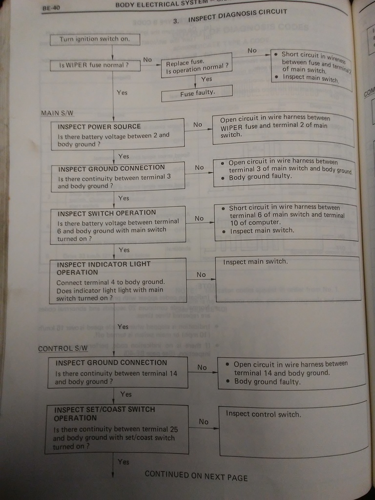

I am going to see what else I can find in the FSM for Cruise Control
BE40
BE 41
Thank you sir!

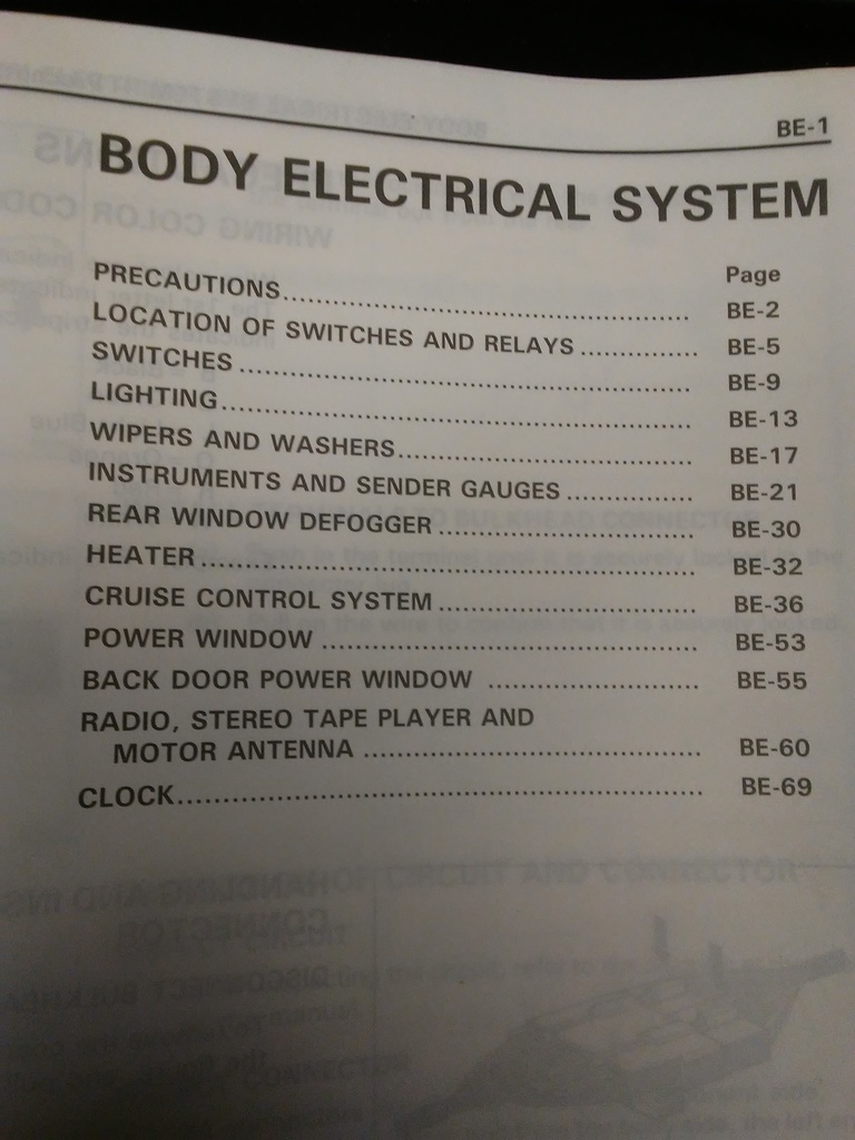

can you provide the following 86 FSM pages from the "body electrical systems" section?
Index for reference, cruise control starts at BE-52
Schematic with interconnects
Type A codes and diagnostics entry method
Type B codes, and entry method
Trouble shooting check list
Inspections.

Millball, you can get yours into type A by that method listed above? (Key on, set on and held, mash main switch, release set. Then it will respond with the type A checks, accel and coast flash codes as above?)
Comparing the image Terry supplied with the 88 shows the same entry method, it's maybe worth noting the later model books say to hold it for 3seconds and the indicator is supposed to start blinking to confirm its in mode/type A output. I think I've held it that long or longer and it never flashes and didn't confirm the switch signals as it should and jumps right to type B when toggling "set" three times.
If you look above where I posted the inspection sheet I had about 9-10 volts coming from the STOP fuse which was pretty low. So low the I'm not certain if that or the cold was causing the main switch to not stay on.
There is also black box showing in the 95 cruise relay I'm not sure about, could be a regulator or just a distribution block. I wish they had a good upull yard up here it would be worth the entry fee just to get a look inside that relay.
Actually I just noticed the same box in the 86 main switch and an odd interconnect to the number 6 and 4 pins on the switch. Since the courtesy lamp for the ignition key is burned out I'll try to get a look at it.
Sorry, just saw this.
Yes, when Charge Light is on (Alt pin 2 is low or close to ground), brake fluid level switch closes, or brake switch closes that point on negative side of diode (same as Cruise Control pin 12) goes low. Pin12 going low is what disables CC when tapping the brake pedal. Charge fault will also disable it.
