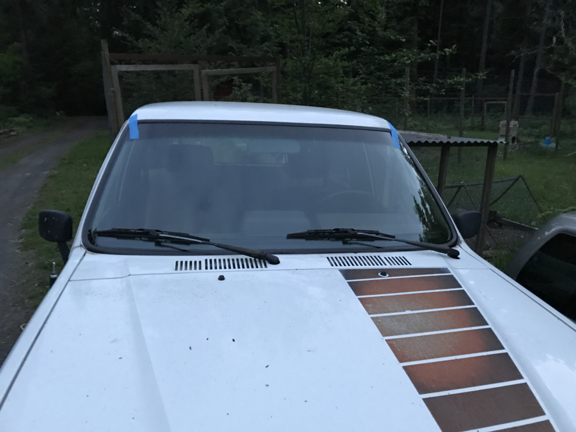

Edit: Been busy but hear is a pic.

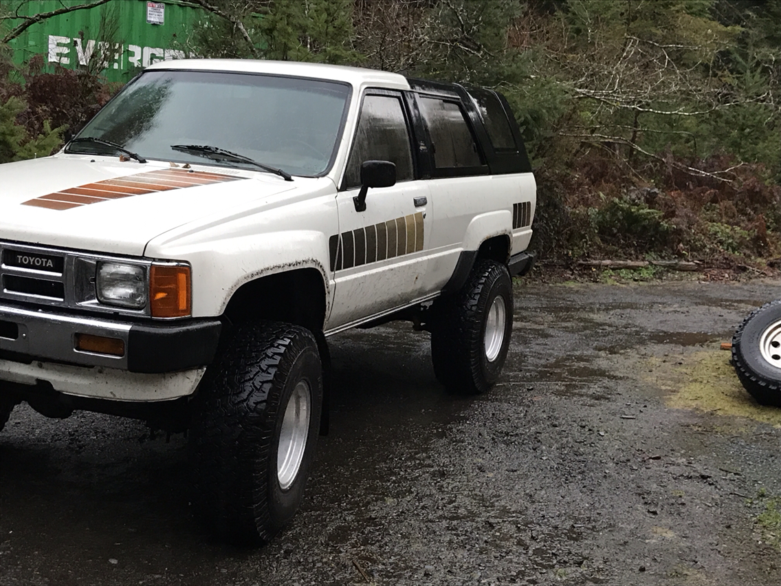

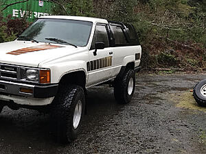

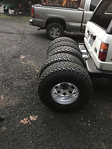

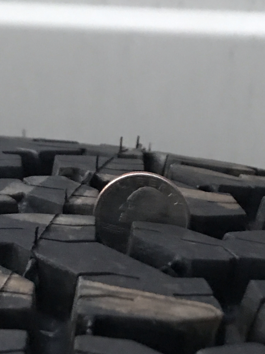

Ok so long time no update. Life happens and toys take a back seat. However when life happens again it can put them back up front. My wife's 98 3.4 snapped the crank near the fly wheel. That has caused her to drive my chevy and me to get the runner back on the road again. But I have found an IFS rear end that I am going to press new bearing in to before install. But today I just got a set of new to me 33" BFG's. They wont fit until I install my lift. So thats a bonus... i just have to install my lift now. Darn!
I am going to need to have new Ujoints installed on the rear driveshaft. But they look due anyways so cool!!!
Hopefully updates will follow more timely.
Obligatory pics of new tires. And a big thanks to mytruck for the great price on the tires.

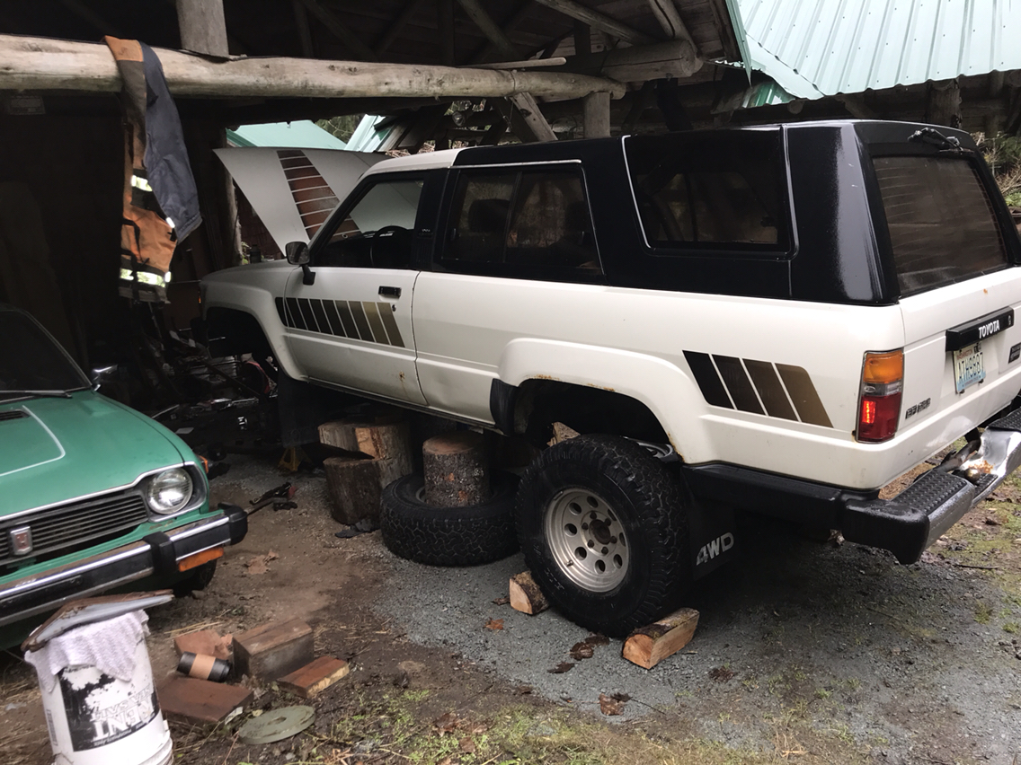

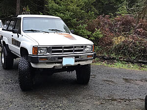

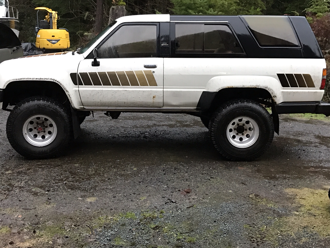

Ok picture of my glacially slow install. Rears installed and still on. 31's
Ok on the front do I need to disconnect the torque rod to get the springs on them reconnect it? When I take the jack stand out from under the passenger side it wont drop far enough to let me get the spring in. I am going to try and monkey with it tonight again. Only get an hour here and there to work on it. I got the front spring pin thread fixed. So ready to go forward. Just kinda stuck. Need a winch for me.
85 4runner, OME Dakar heavy springs,stock hangers and shackles.

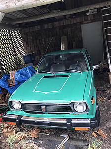

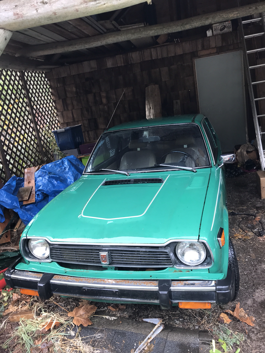

Do I spy an adorable little Honda next to your awesome 4Runner?
Old Dec 7, 2019 | 04:12 PM
  #73
thefishguy77's Avatar
Joined: Dec 2011
Posts: 2,179
Likes: 62
From: sammamish, wa.
Yes you did.
Its a project for sale .

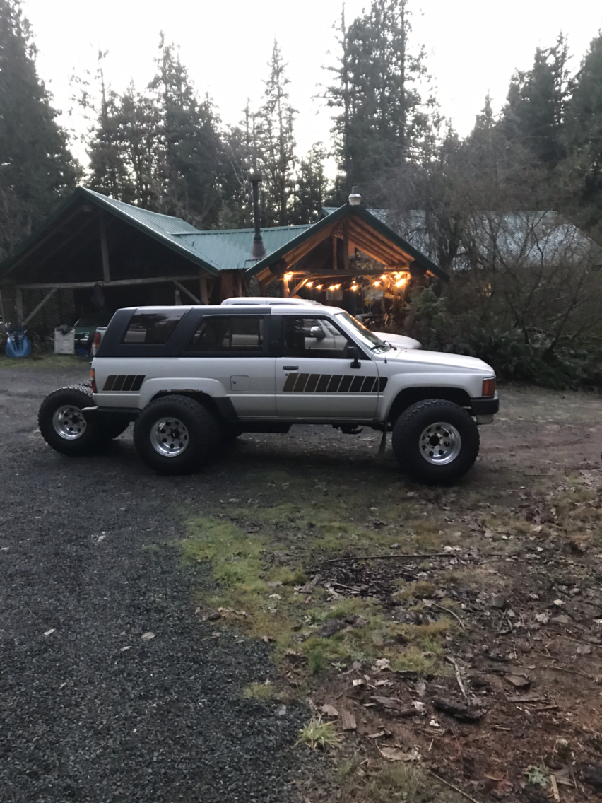

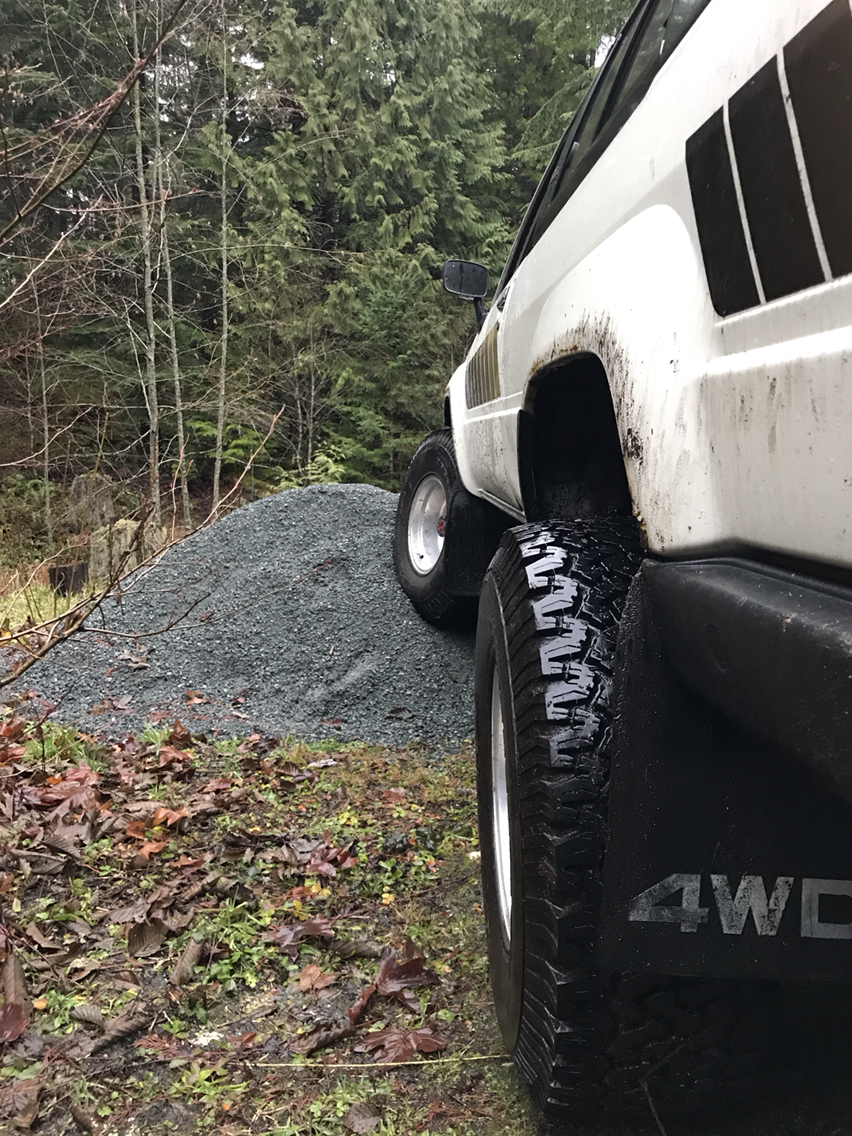

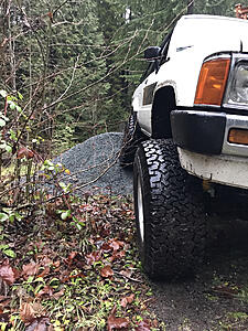

Ok so I am calling it done for now. Springs and steering seem good. Bounced around my driveway and property a bit. First impression is it went from jarring to controlled rebound. I am going to do a retorque at 50 150 500 miles. Be interesting to see what the 33's feel like with 4:10's on the road. but now I can in theory wheel again.

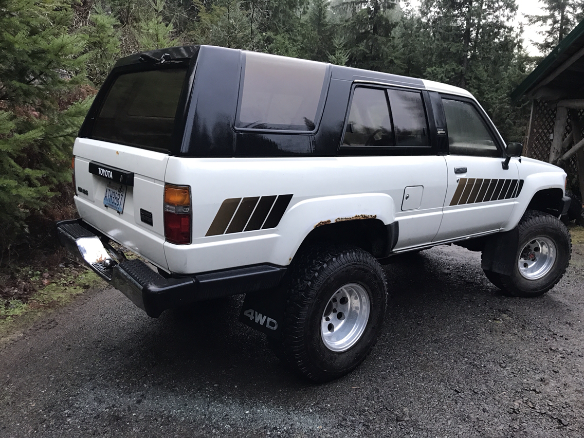

Ok so got the first 70 ish miles on it. I really like it but am going to fully go through it before I drive it again. Its going to be my DD until I get my Chevy rear end replaced. When 10 bolts come apart for me they come apart well.
Thats custom bro.
