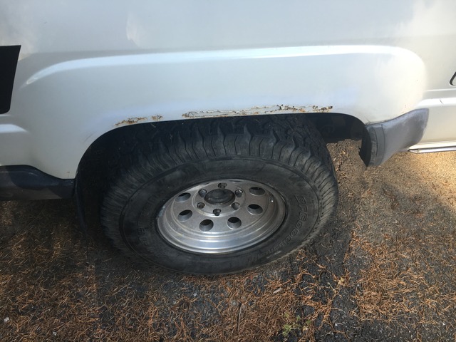

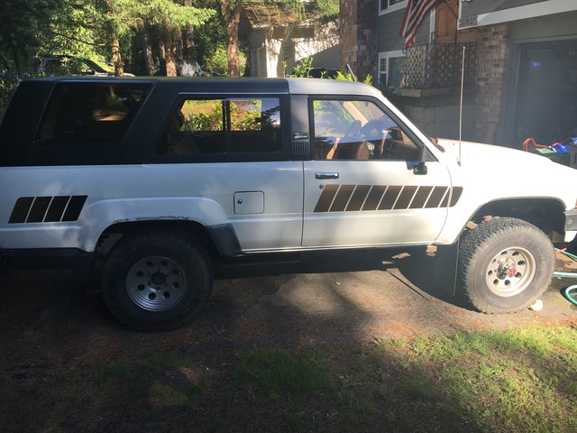

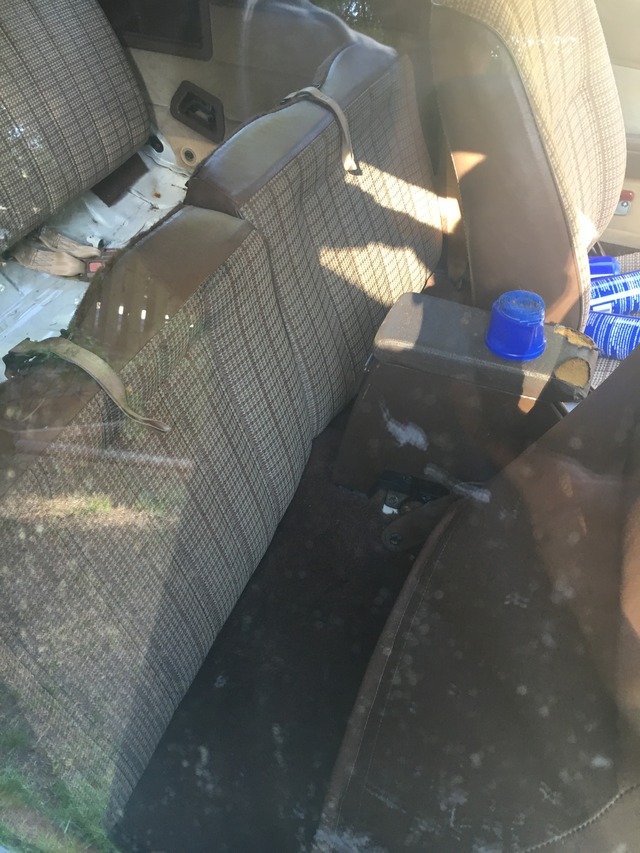

4Runner pics per request
Only real rust

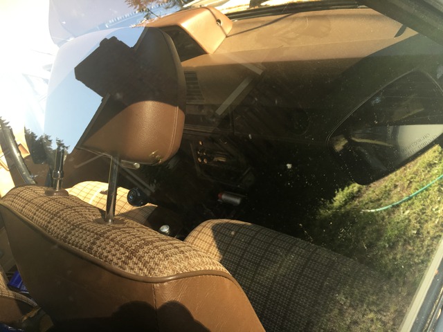

Sorry about the reflection. I was greasy and didn't want to open it up. She's really clean on the inside

Wow, that's a nice looking runner! Interior looks really nice, like the exterior stripes too!

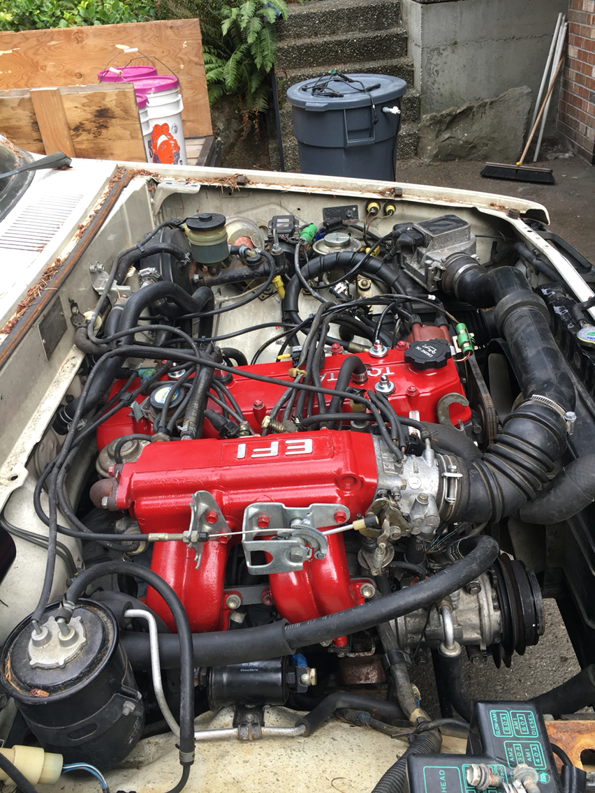

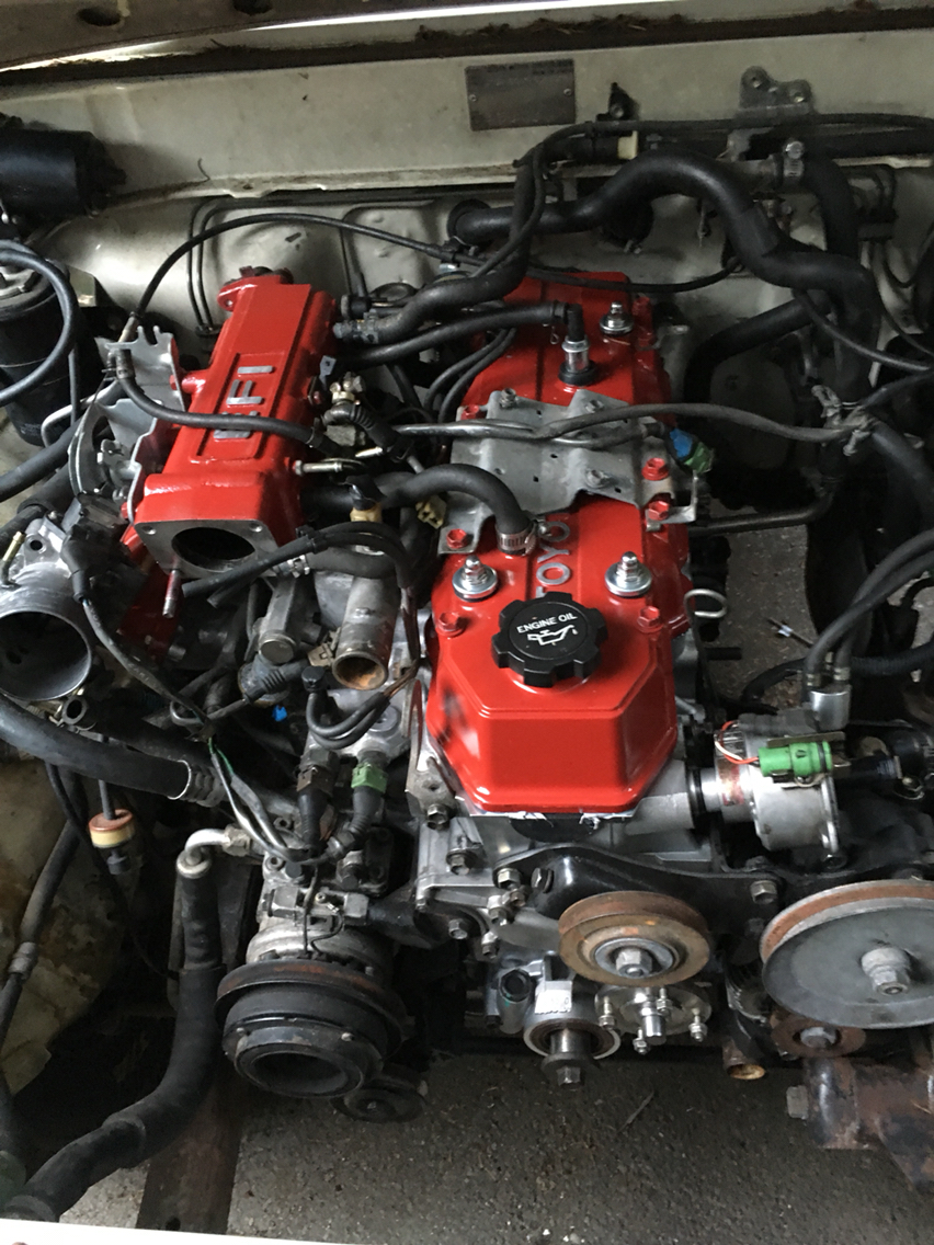

We need some engine bay pics now that you got the 22re back in! Also, are you just going to be running OME's stock length shackles?

I will try and take some fresh pictures today. As far as shackles go I am undecided. All I have at the moment are the springs and bushings. So everything else is negotiable. My one concern is I have seen a lot of these lifts that have a contact issue near the gas tank. If longer shackles would prevent this then I am all for it. However I am only going to run 33's on this rig. Gears, lockers, and armor will make up the rest.

Well found some older pictures. It's been in the high teens low 20's for a few day and I don't want to spend anymore time than I have to outside.
Got to get her loaded on the trailer yesterday. I just can't get these electrical issues figured out. She's going back to my buddies shop. Everything is harder when it's frozen. Hammers and torches make things move when they don't want to.
Attached Thumbnails thefishguy77's The Car Seat Crawler-photo720.jpg   thefishguy77's The Car Seat Crawler-photo618.jpg   thefishguy77's The Car Seat Crawler-photo714.jpg
