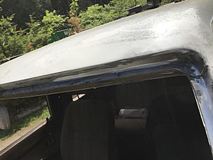

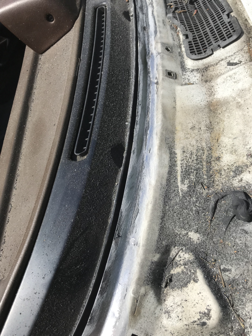

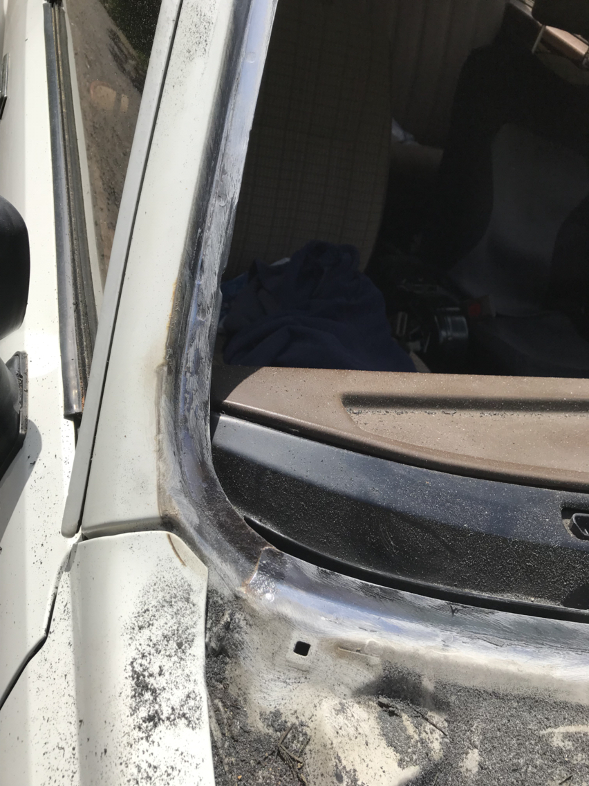

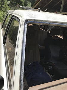

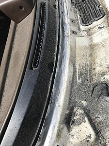

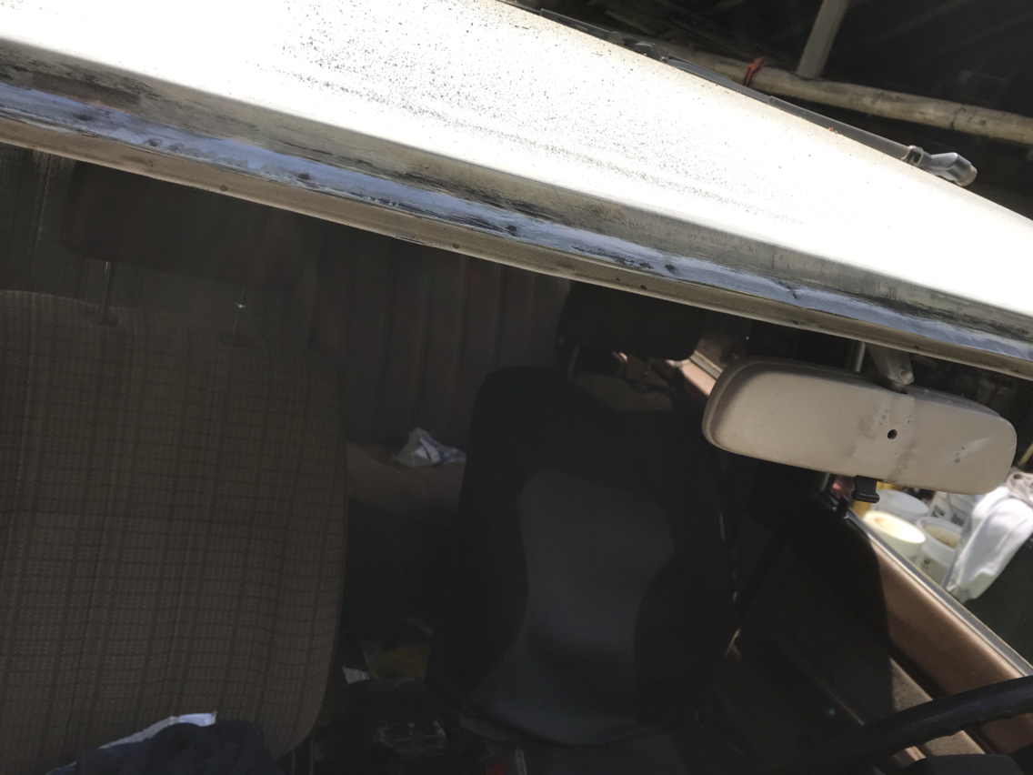

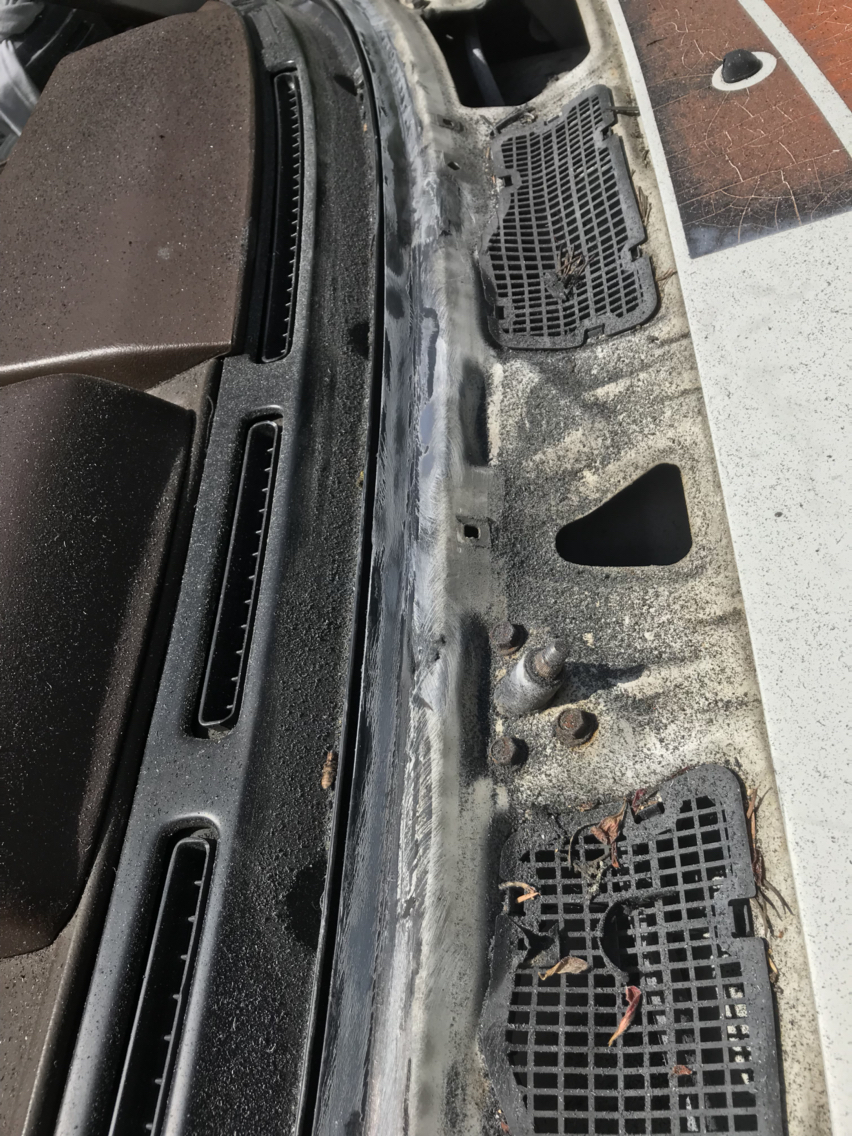

Got a new windshield today. Pulled the dreaded chrome trim of and expected to find a disaster. Instead the were to areas with some pitting but no major rust at all. Replace the chrome trim with a rubber gasket. Got lucky.
Attached Thumbnails thefishguy77's The Car Seat Crawler-photo686.jpg   thefishguy77's The Car Seat Crawler-photo366.jpg   thefishguy77's The Car Seat Crawler-photo478.jpg   thefishguy77's The Car Seat Crawler-photo62.jpg   thefishguy77's The Car Seat Crawler-photo64.jpg
