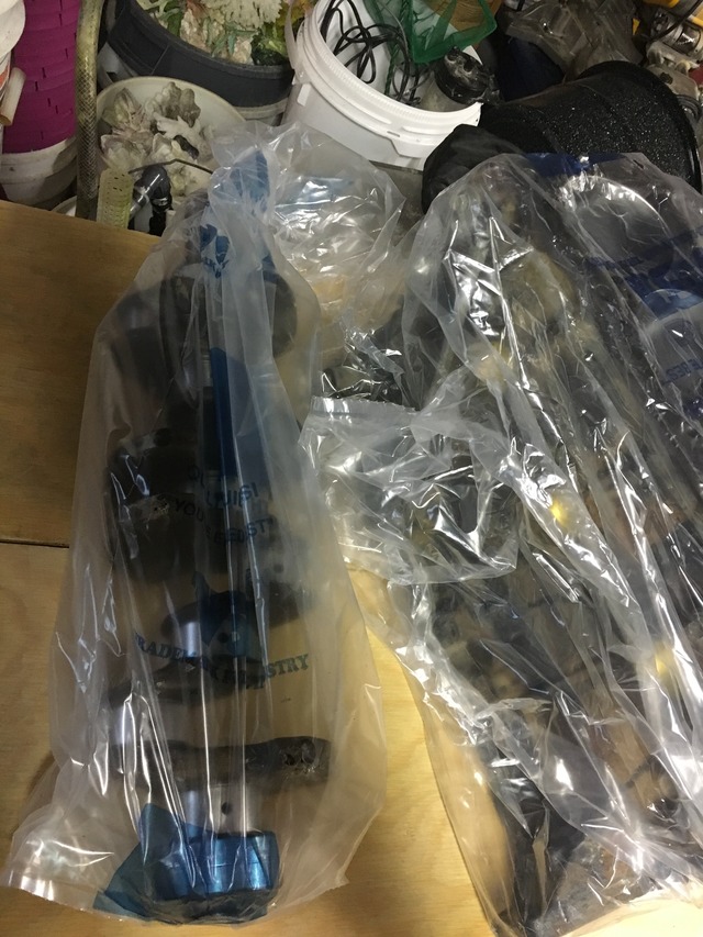

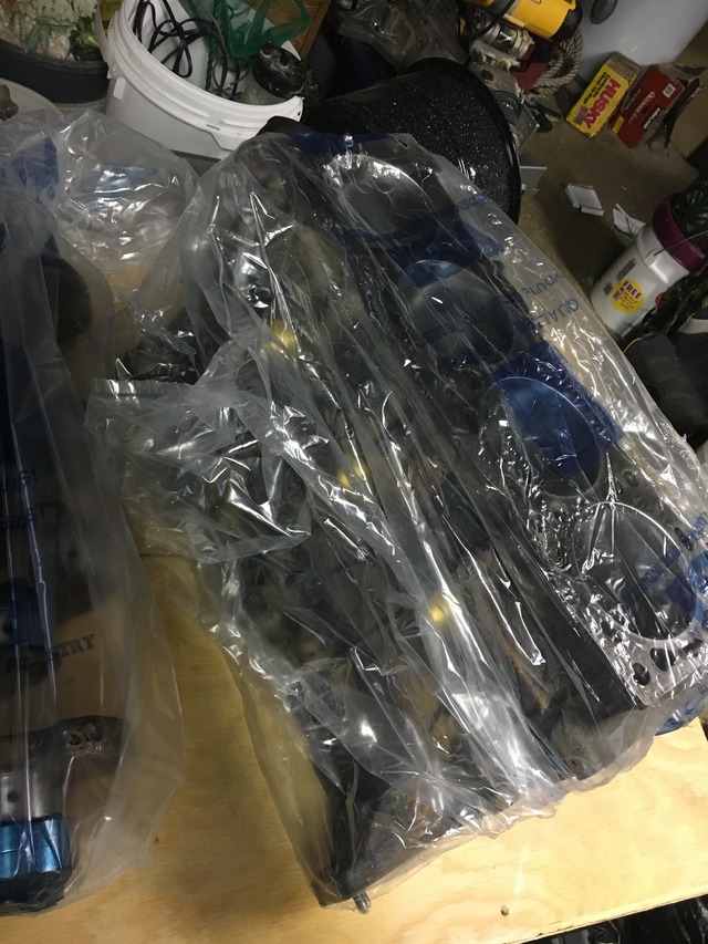

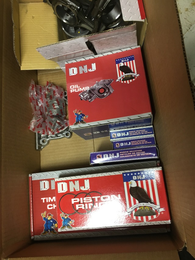

So it's been so long I couldn't find my build up😔. But GOOD UPDATE!!!!! Motor parts are here. Thank you very much Engnbldr and Marlin crawler for the great quality parts and work. Now it on me. I know pics or it didn't happen so here you go

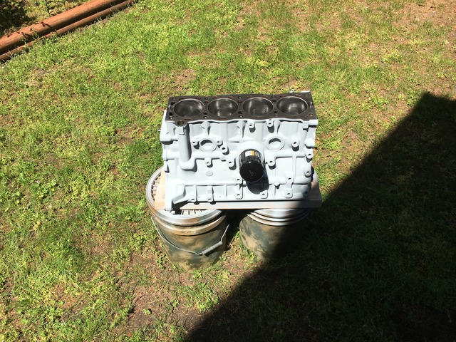

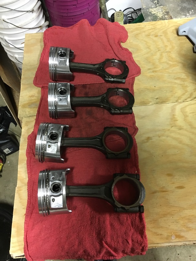

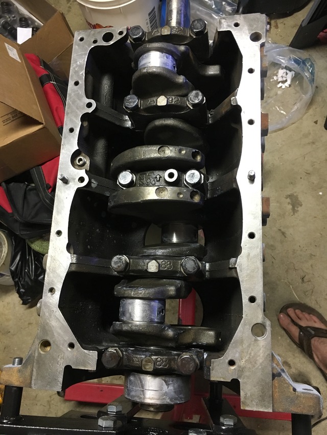

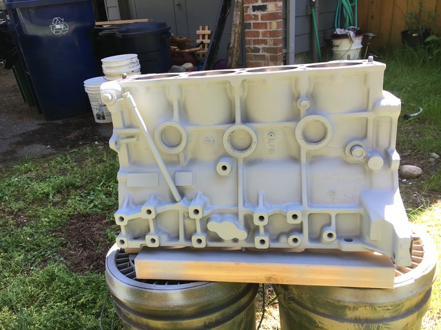

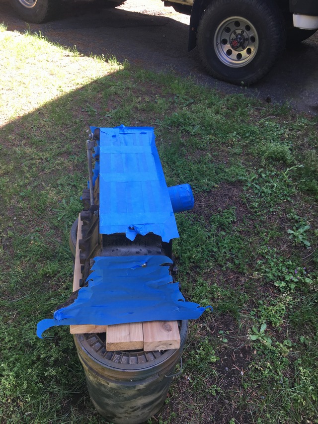

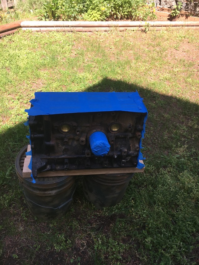

Got the block painted and the bottom end together. Started pulling the bad motor apart in the 4Runner so I can make sure I have the correct timing chain and cover bolts.
More pics

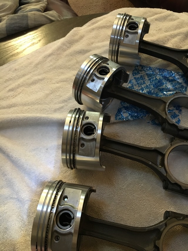

Rings all clocked

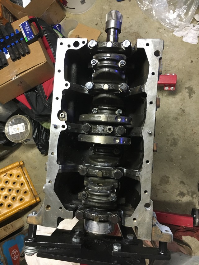

Crank bolted down

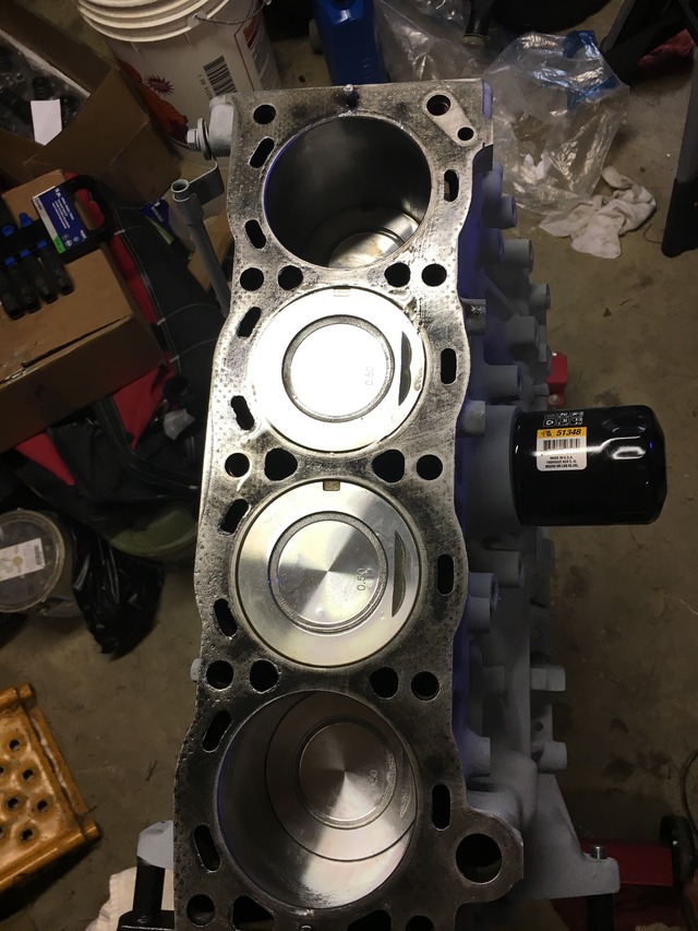

Pistons in
Rods bolted in
More pics tomorrow
Going to put the new head on and get it bolted down tomorrow timing chain on and hopefully cover on as well. I am using white lithium grease as an assembly lube because she not going to get fired right away

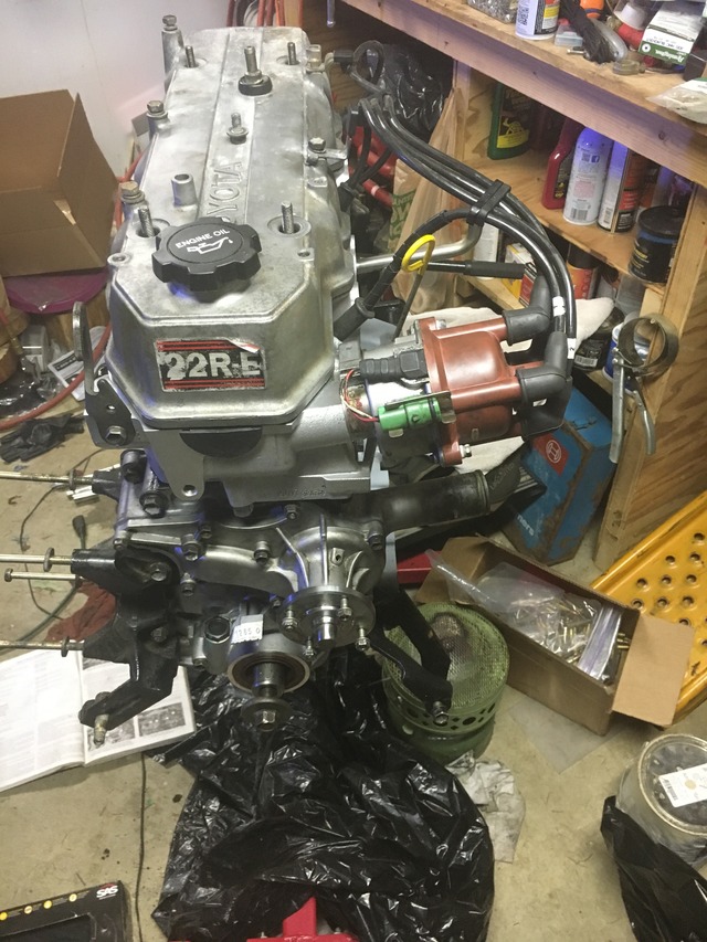

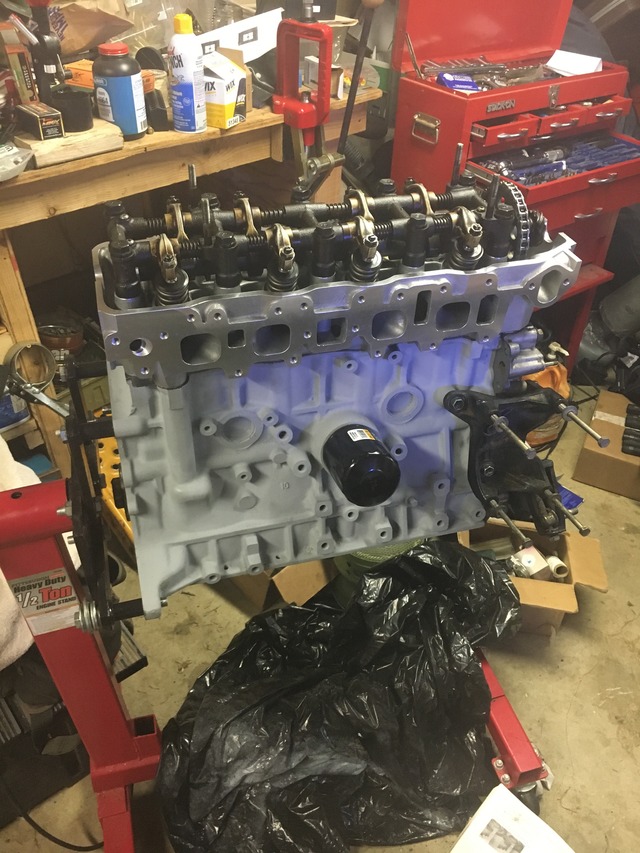

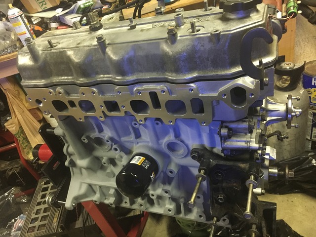

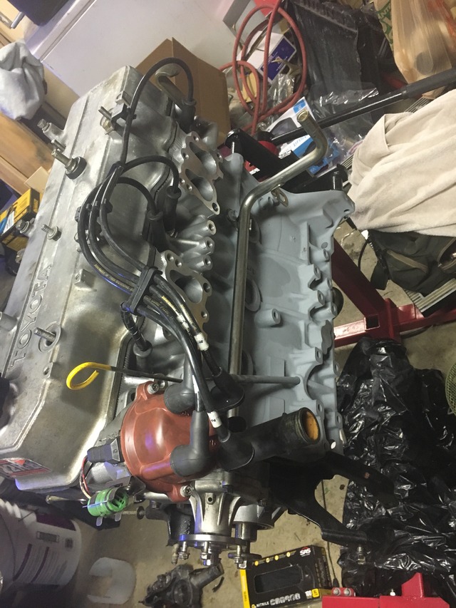

Ok so pretty much have a long block now. Timing chain, cover, oil, water pump on. Need to pull my other oil pan as its been recently cleaned. Dropped the valve cover on and mocked up the distributor for pics. I have that plat that sits on the back of the head soaking in odorless mineral spirits because it was very clogged. Probably pull it out tonight and give it a rinse. Need to go buy exhaust studs. (Can't believe I forgot about those). Then start unbolting the other motor in the 4Runner I have a spare set of motor mounts that I'm going to use.
But my question is do I paint the valve cover, intake and plenum. I have heard it traps heat in the valve cover and that's not good. But so many people do it so what do you think.
On with the pics
