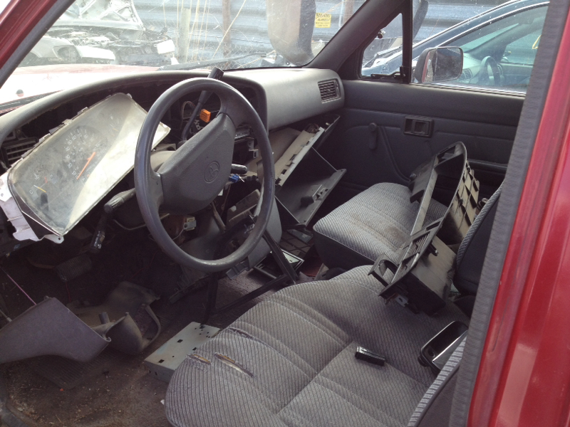

Well I made it out to the two u-pull it yards here in Omaha yesterday morning. Sadly there weren't any 1st gen 4 runners or 2nd gen pickups. Only a few 3rd gen pickups that were either picked over of destroyed by idiots pulling parts.
I managed to get the egr temp sensor piece and a tps for one of my students (91ncarman).
Nothing frustrates me more than when people deliberately destroy perfectly good parts just to get at what they need. Check this pic out.
Totally ridiculous!! They literally ripped the dash out and broke it all to pieces. Ripped the radio trim out and broke it in half!! I can't tell what they were getting at. But really hate to see this.
I always take my time And remove other components that are in the way so I can access the parts I need. I even go as far as to put back what I removed. Just invade someone might need it.

It is frustrating when they do stupid things like that. When I can, I disassemble one when I can just to keep it from being destroyed and to keep in practice on disassembling mine. If I owned a yard jack butts like that would never get let back in.
I wish I could catch someone doing that to one while I was there. I have been looking for a good 3rd gen radio trim for one of my students for a few months now and every single one is trashed because they wanted the radio, or a wire behind it. So they just ripped it all to pieces.

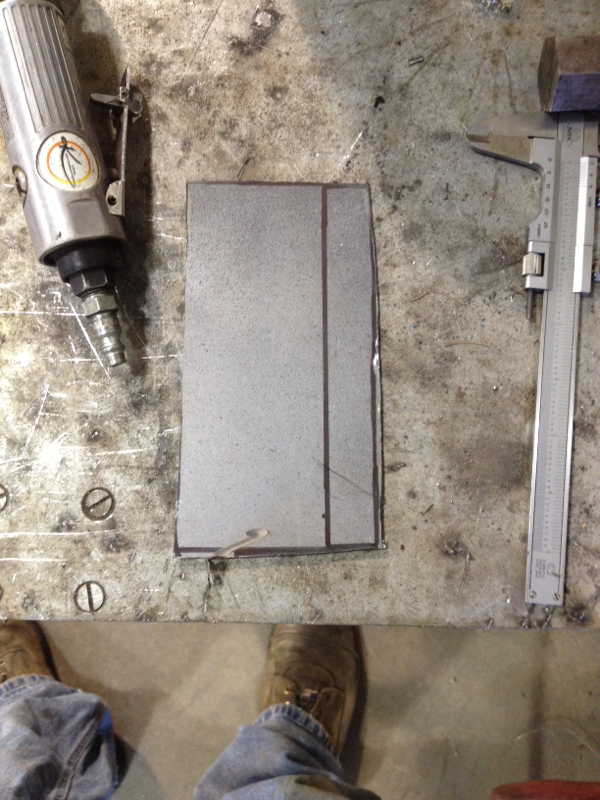

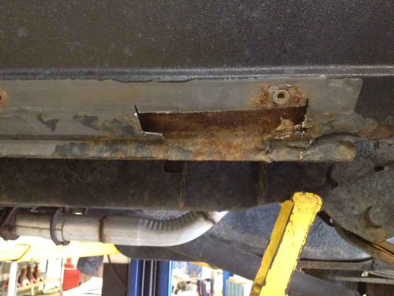

Found a little rust this morning. Well I guess I should say that I caused it. Saw some surface rust and decided to hit it to see if it would rust through. I ended up opening a 6" piece.
And I also made a template to put in out of some scrap I had laying around. Got it tacked in before work was out today. Seam sealed it, and going to out some filler Over it tomorrow. Then bedliner it.

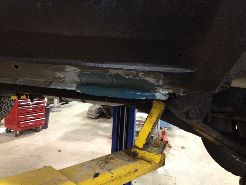

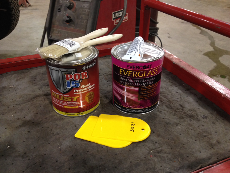

Picked up a few supplies this morning. I sanded down the rocker after I stitched in the replacement piece. Then applied some of the filler and letting it setup.
I think I am going to POR15 the entire rocker

have you tried anything besides por15? some friends swear by this. ive never heard of it.
http://www.tptools.com/U-Pol-Raptor-...-Kit,2600.html
Old Apr 23, 2014 | 01:03 PM
  #498
Gizler00's Avatar
Joined: Aug 2007
Posts: 3,276
From: Pennsylvania
Originally Posted by kelvinb
have you tried anything besides por15? some friends swear by this. ive never heard of it. http://www.tptools.com/U-Pol-Raptor-...-Kit,2600.html
Yes I have tried a lot of other things. The only reason why I thought por15 is that at Auto Value right now they stock it, so I can actually buy it on my school account. The raptor liner is what I used to spray on my lower half of the doors, and in the bed of the runner when I get the rust repair.
The raptor liner is really great stuff. There also is another good stuff made by Eastwood industries which is just like that POR 15
Old Apr 23, 2014 | 01:04 PM

The evercoat body filler is really good stuff. And very easy to work with.
