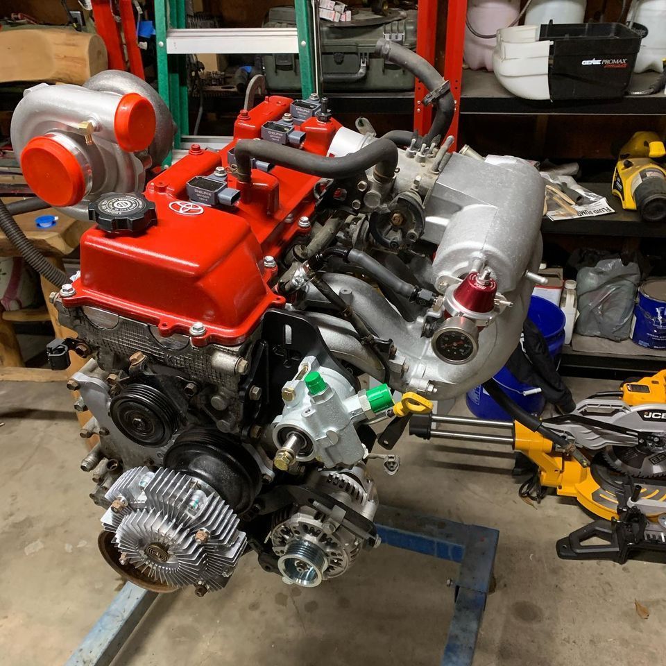

I changed my mind yet again on a new motor. Had a buddy let this 2RZ go for a great price and decided to start building it since it will mate up to my A340.
Rear Sump conversion, PSC TC pump, new Delphi Ignition coils, new alternator, new seals, gaskets and hardware.

Rev 9 Turbo 57mm, GLF turbo manifold, New OEM Pink top injectors 330 cc, Turbosmart 7 psi Wastegate, Turbosmart FPR 800.

Got the 2rz in and running. Still working out some of the small details.
