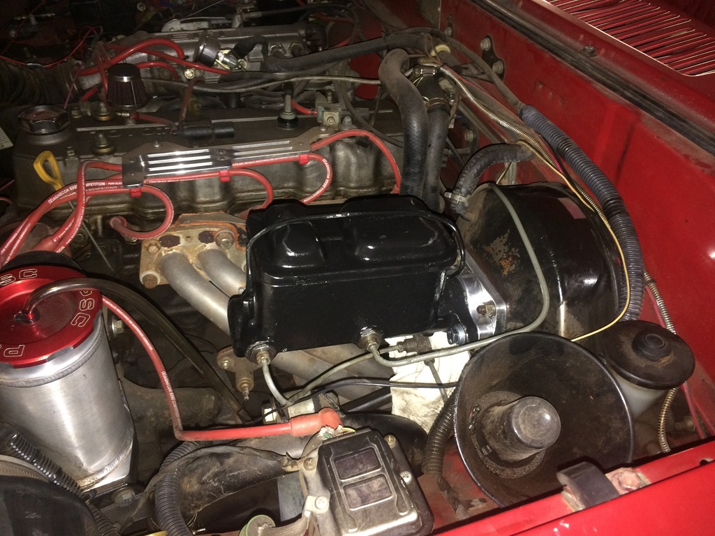

Finally installed my 1 ton MC. I ended up replacing the rear OEM brake line with a -3 SS line to remedy the leaking one.
Added some fluid and got them initially bled. I just have to tuck all the lines away. Then on to a test drive.

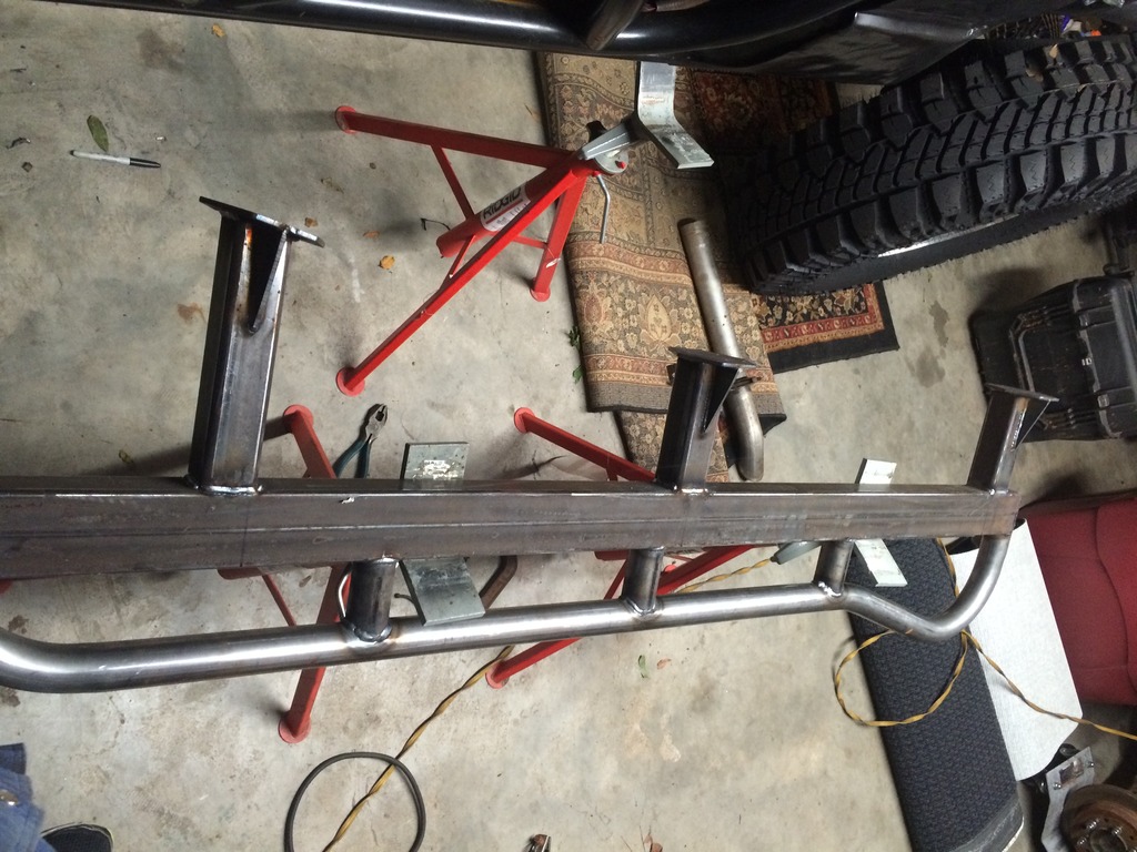

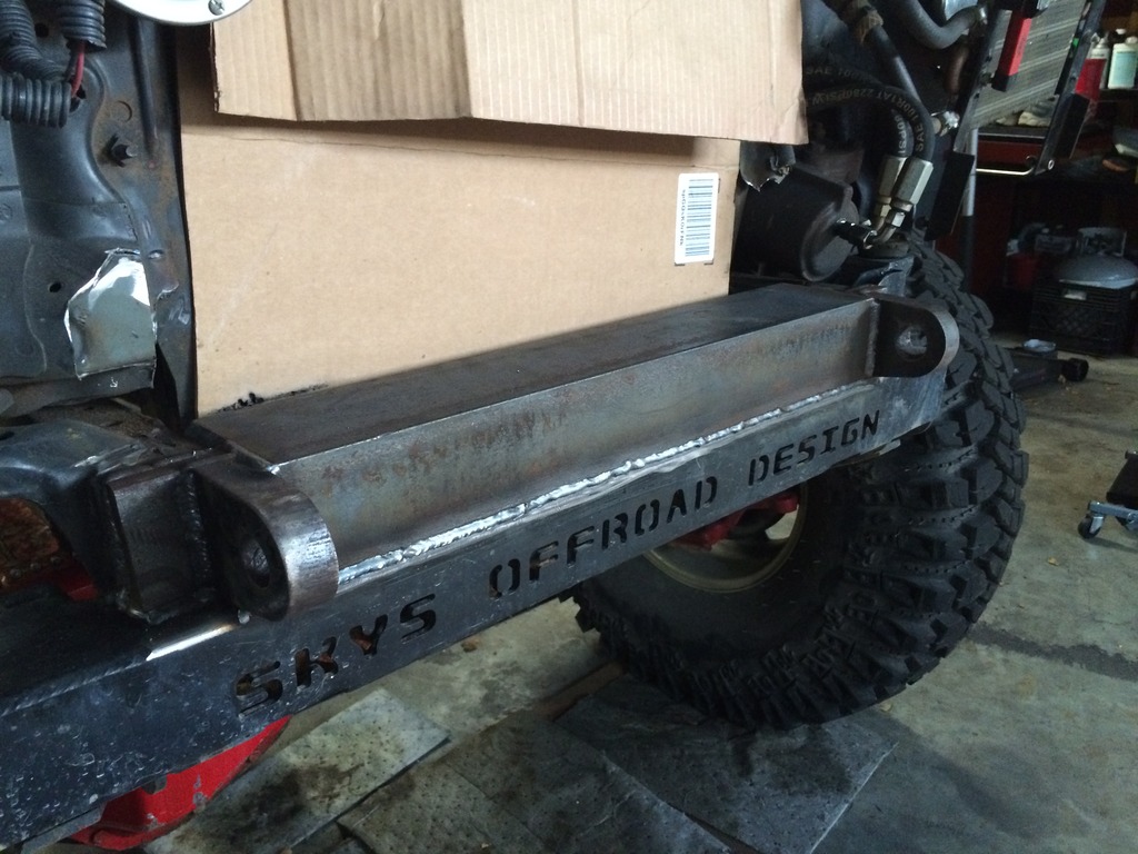

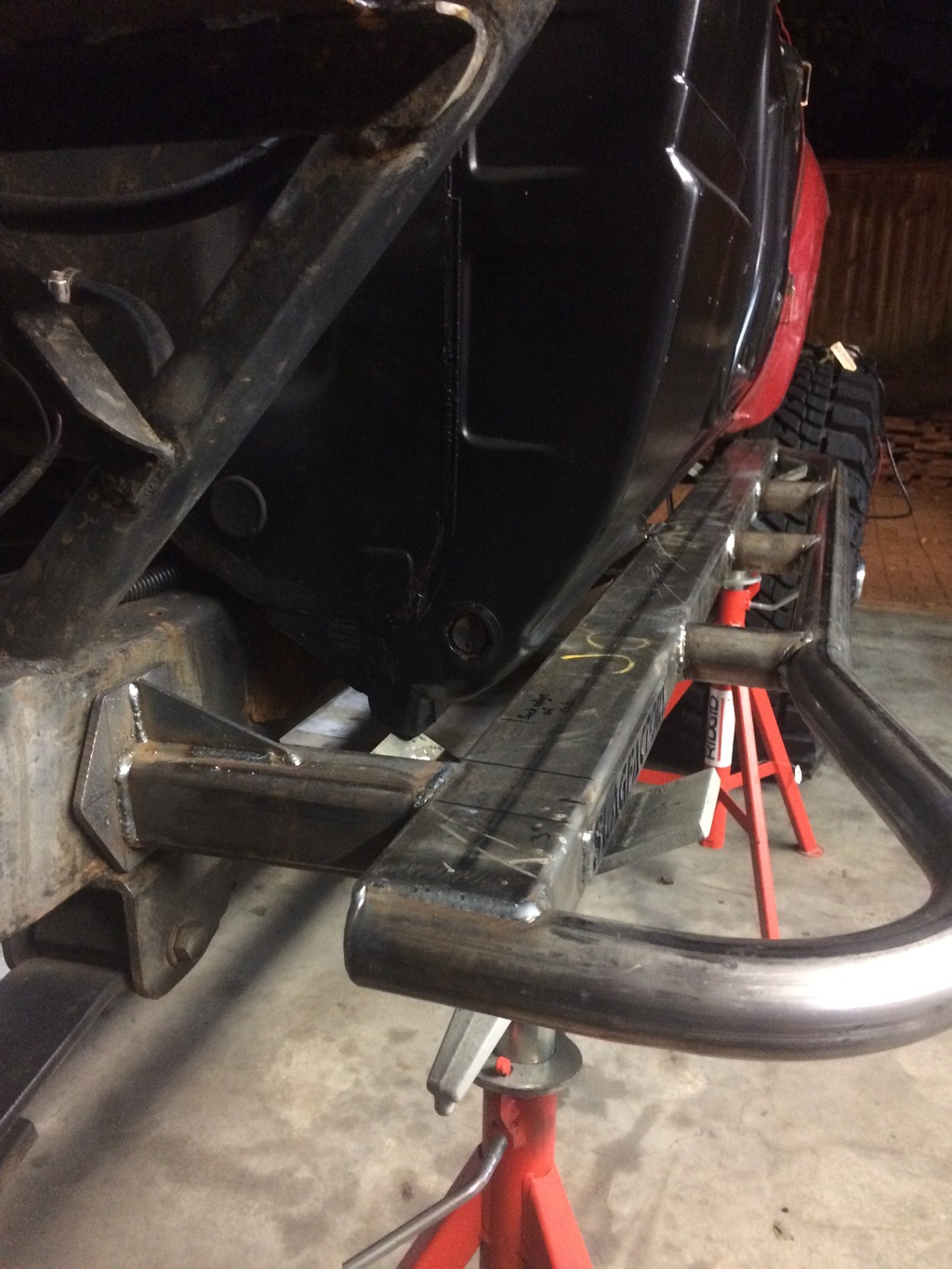

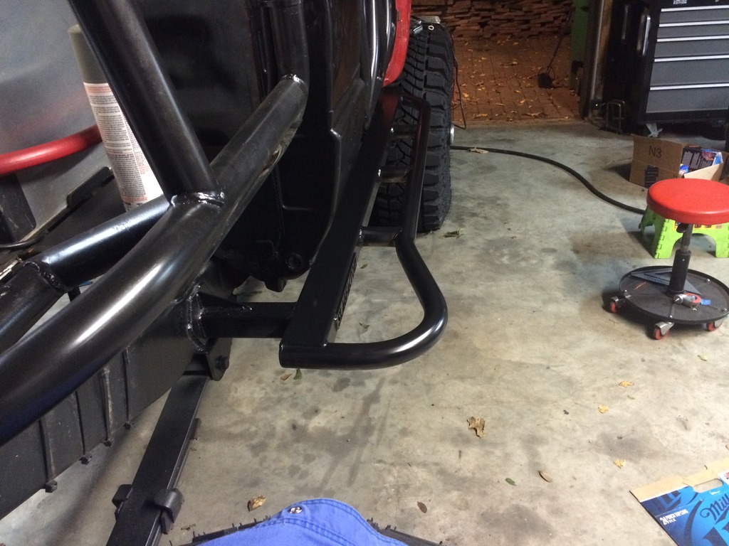

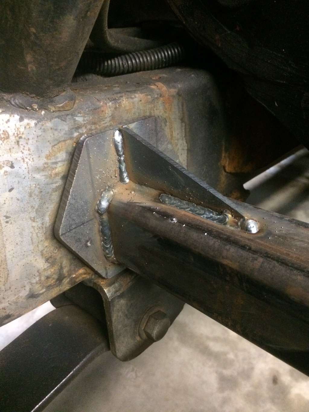

Started mocking up my sliders tonight. I found them online from a shop called Slag Factory. They are 67" long with a kickout. The main tube is 2x3 with 1.75 outers and 2x2 legs. Scab plates and gussets were also included. They seem to be built well. I'm leaving the 2x3 tubes out a bit in order to be able to tie some tube into. Time to bust out the chop saw tomorrow to get the other legs cut and burned in.
Scab plate and gusset

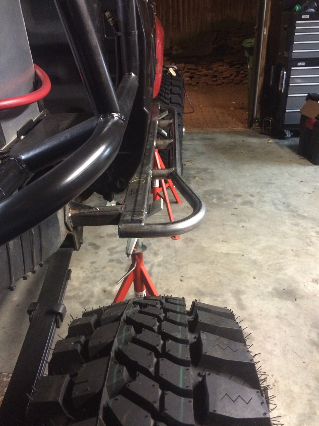

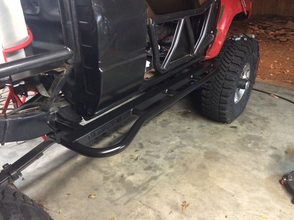

After running out of wire and gas for the welder I finally got my sliders burned in.

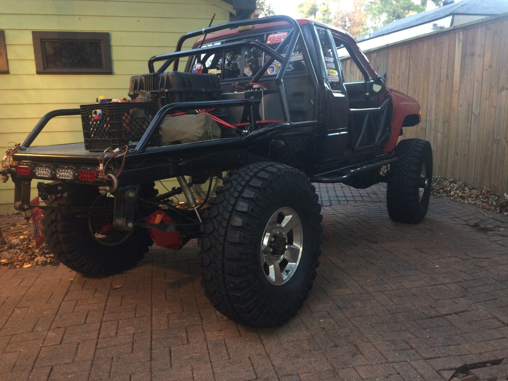

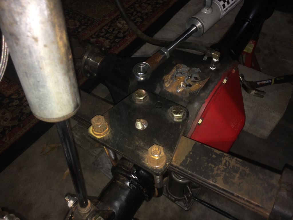

I've been working on a few things over the past week.

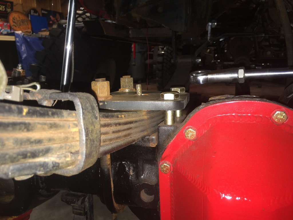

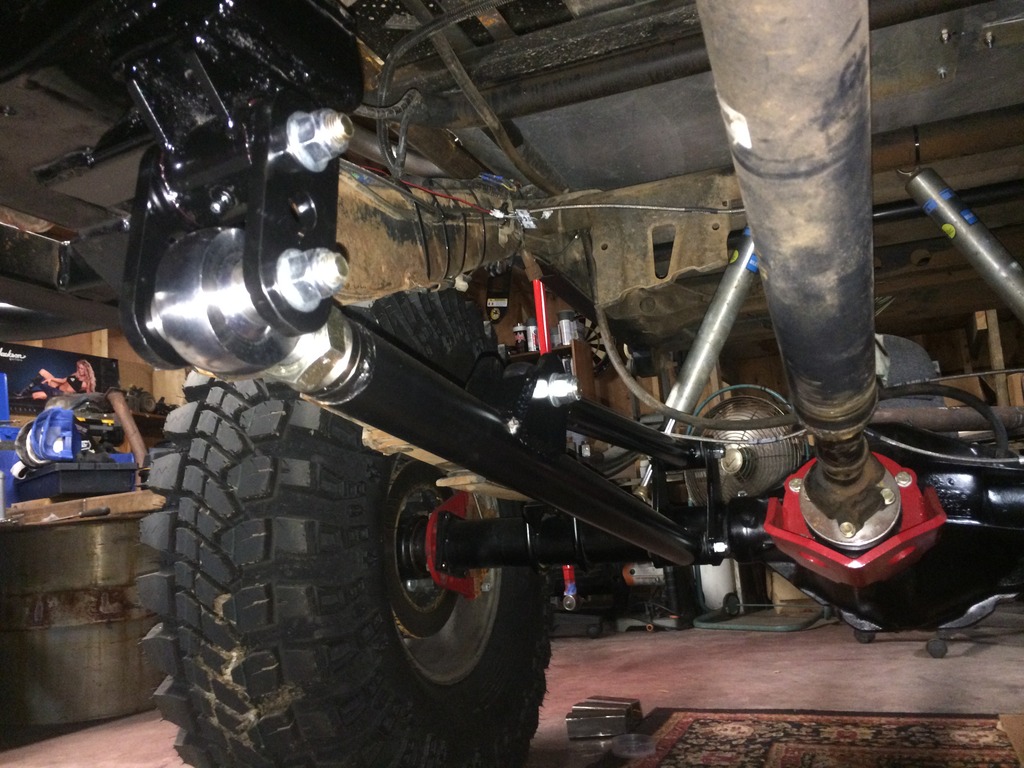

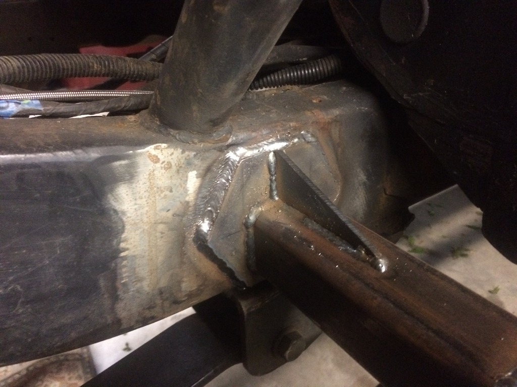

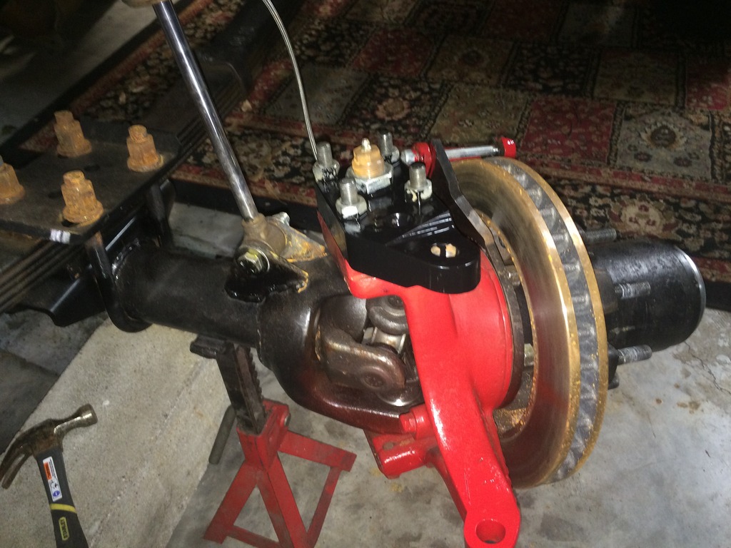

Addressed my pass side spring perch and got it all torqued down. I had to trim the inner 5/8 bolts to fit correctly to keep the spring plate on evenly.

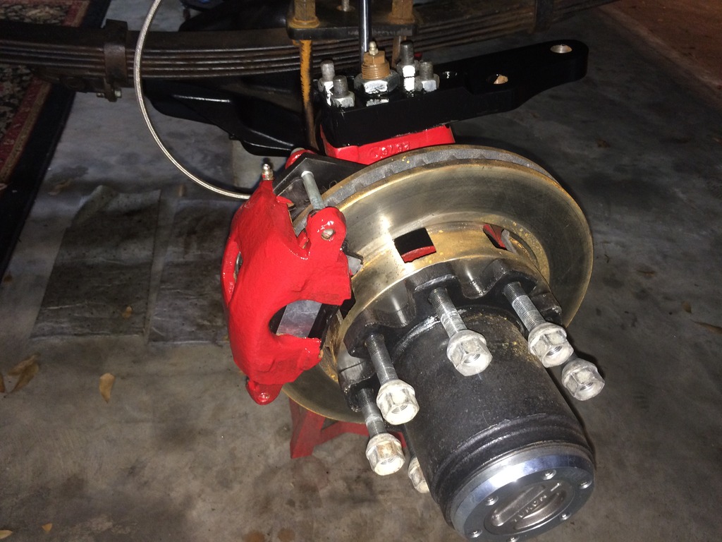

I painted the front calipers, high steer arms, and steering linkage. I should have painted all this before in installed it the first time.
Just waiting on the paint to dry. Should be back in this week.

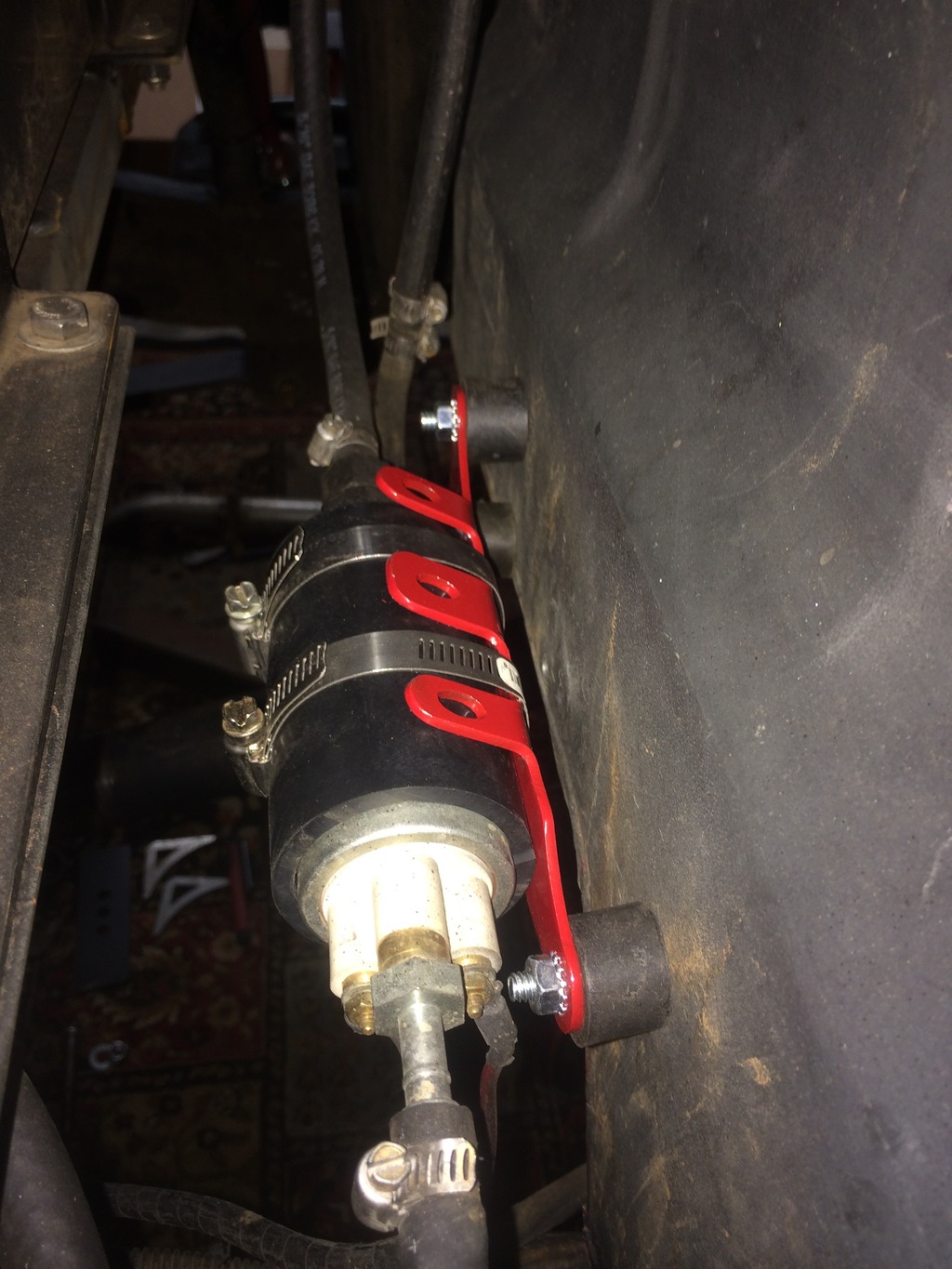

I installed a new fuel pump mount on the back of the cab just slightly lower than the fuel cell.
Finished up my anti wrap bar

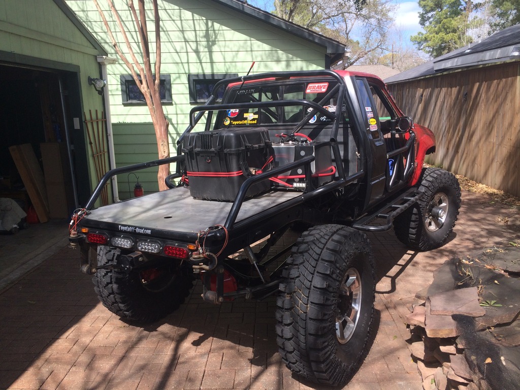

Truck is ready to wheel as of this afternoon. I made a few hot laps through the neighborhood.

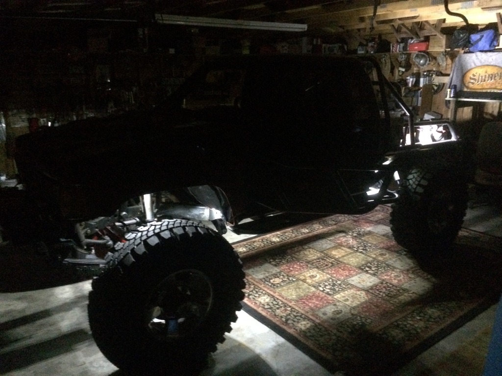

Rock lights are done.

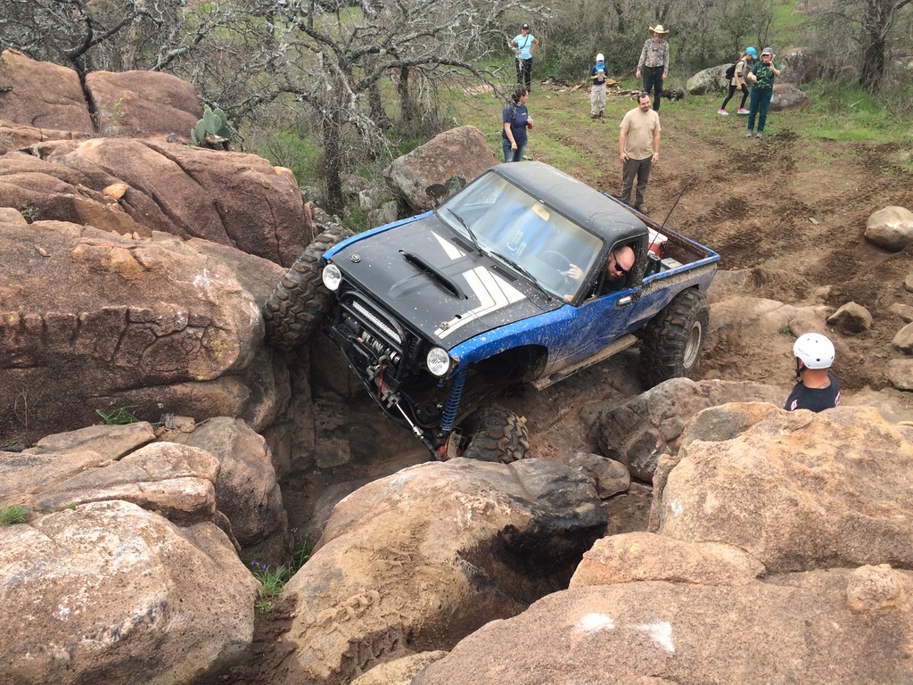

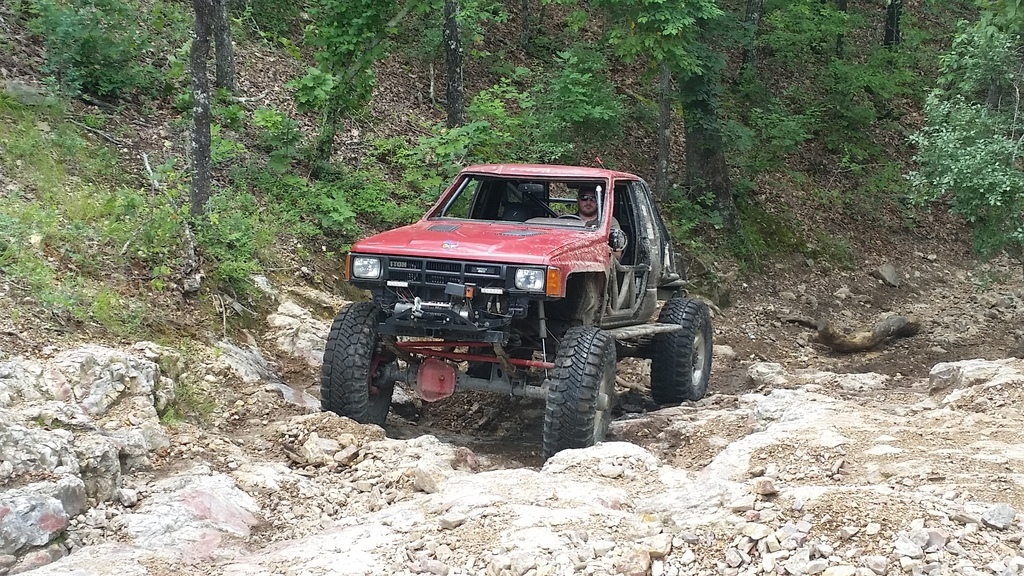

I've been out of town since getting back from K2. It is truly an awesome park to wheel and is definitely hard on your rig. I think once the tire break in they will be awesome. Issues that I found: I need to clearance both front fenders, cut off about 2 inches of slider in the front and rework my winch situation. My tires eat into the sliders and fenders when stuffed and my approach angle is horrible.
On to the pics..
King of the Hill
My tires hit the leaves a little.
Daniel losing his idler and steering pump pulleys on Smoking butthole.
Alex on Crazy Wabbit
Ron doing his thing on Dolphin
Guy named Rob with a sweet fj55 buggy and a hot 5.0 under the hood
Ryan's Twisted Customs buggy on Kiss My Grits
Ron on Hanibal Lecter
Exit on King of the Hill
Weather was perfect for wheeling.

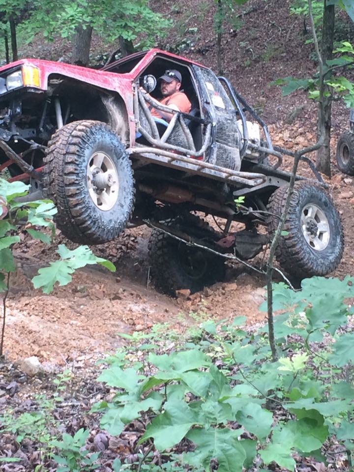

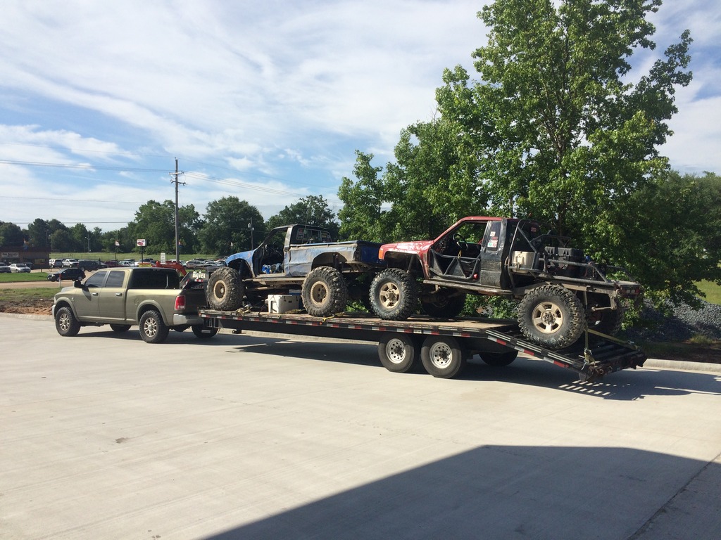

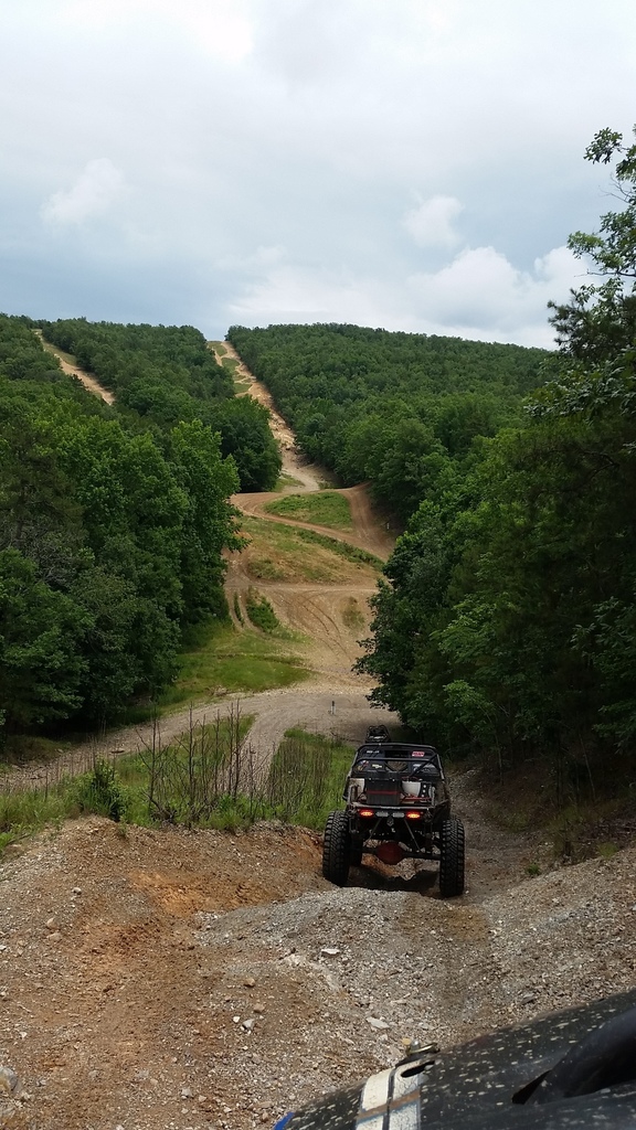

Alex and I hit up Superlift ORV in Hot Springs this past weekend. This park is awesome! There was some rain and it was slick.
Horsepower Hill wrapped out at 5500 rpm!!
Alex took a harder line and was a little more impressive than mine
Daniel warming up his tires
Got 2 tires off of the ground on Schaffers
Hills galore
Our group for most of the weekend
Alex on Pinion Hill
Red doing work
RTI still had a little to go
headed home

I cut the outer rail and Kickouts off of my sliders. They stuck out way too far and were more of a hindrance than a blessing on my past few trips. I will refit the Kickouts to reweld to the rear of the sliders. I also trimmed another 2 inches off of the front of each slider. The 40's kept digging into them at full stuff and on hard turns.

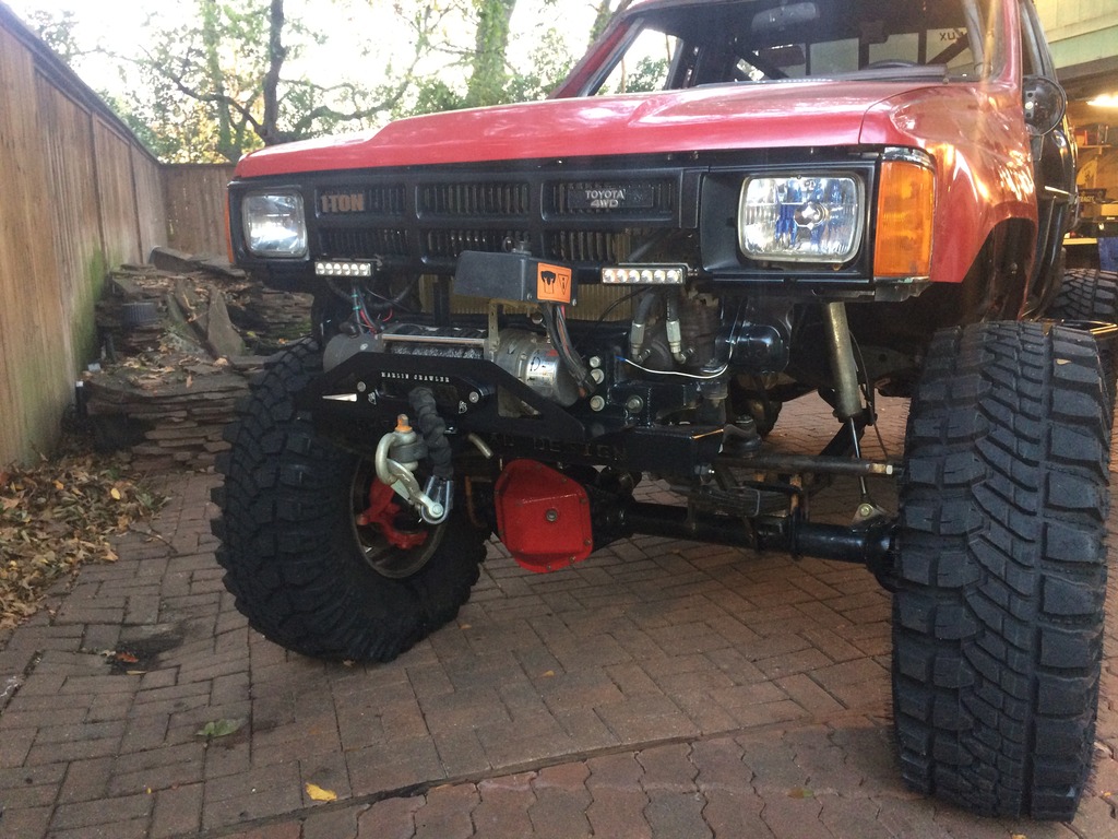

Almost have my winch mount wrapped up
It's tucked in a lot better than before.

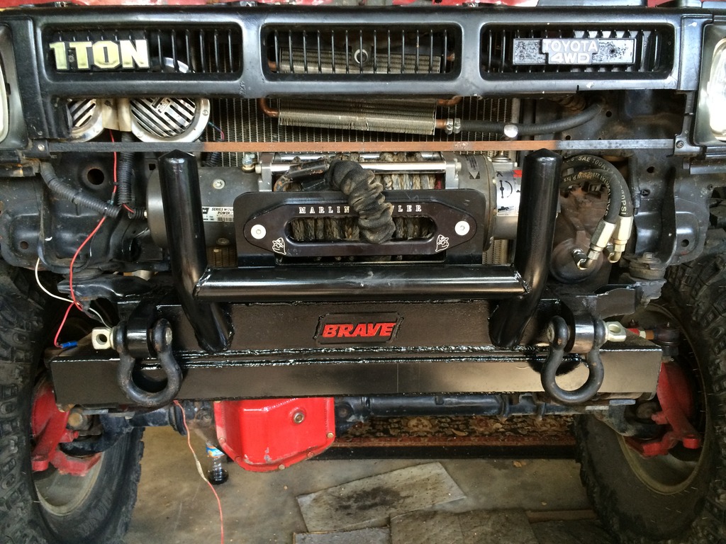

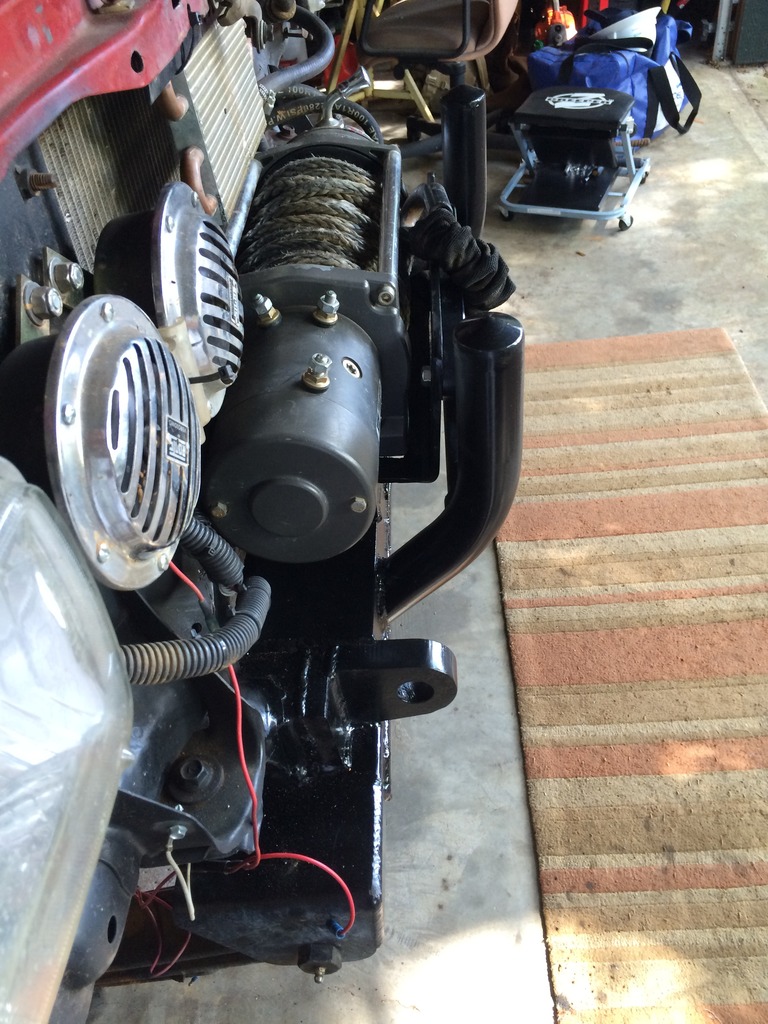

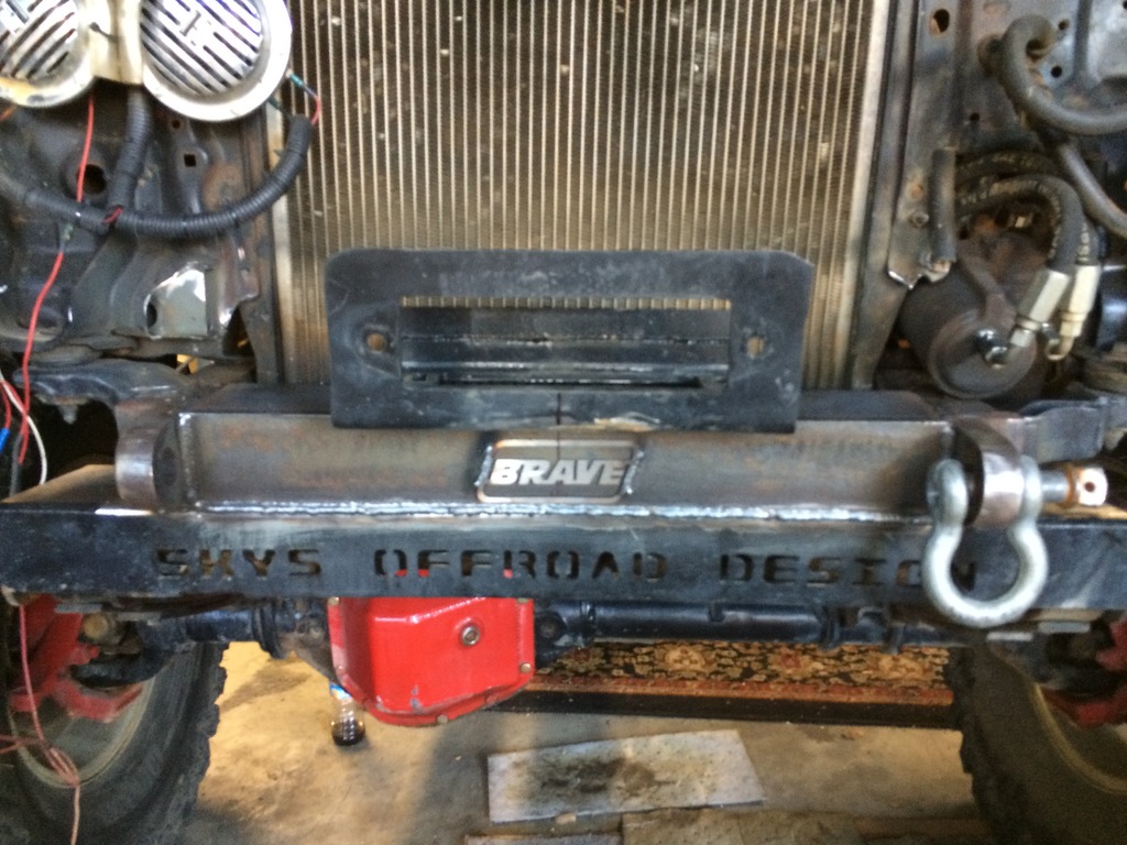

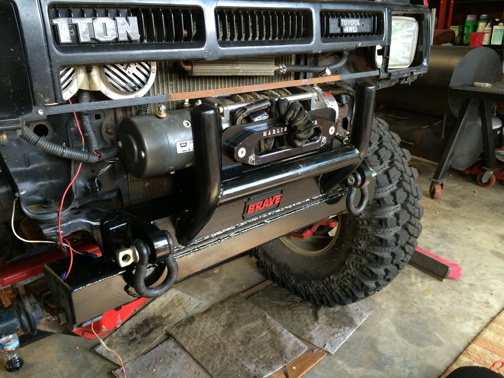

I finished up my front winch mount. I used a piece of 4" channel iron for the winch base instead of the 2" square tubing like i originally planned. I had to use 4 socket head grade 8 bolts instead of the regular ones due to space constraints. I also trimmed the front grille to fit around the winch. I still need to fab up a mount for my steering cooler and run the wording for the winch but other than that it's done.

I also finish welded the trimmed down kickouts on my sliders and capped off the front of them where I trimmed them back.
Plan for tomorrow is to fire up my new to me smoker and drop the transmission.
