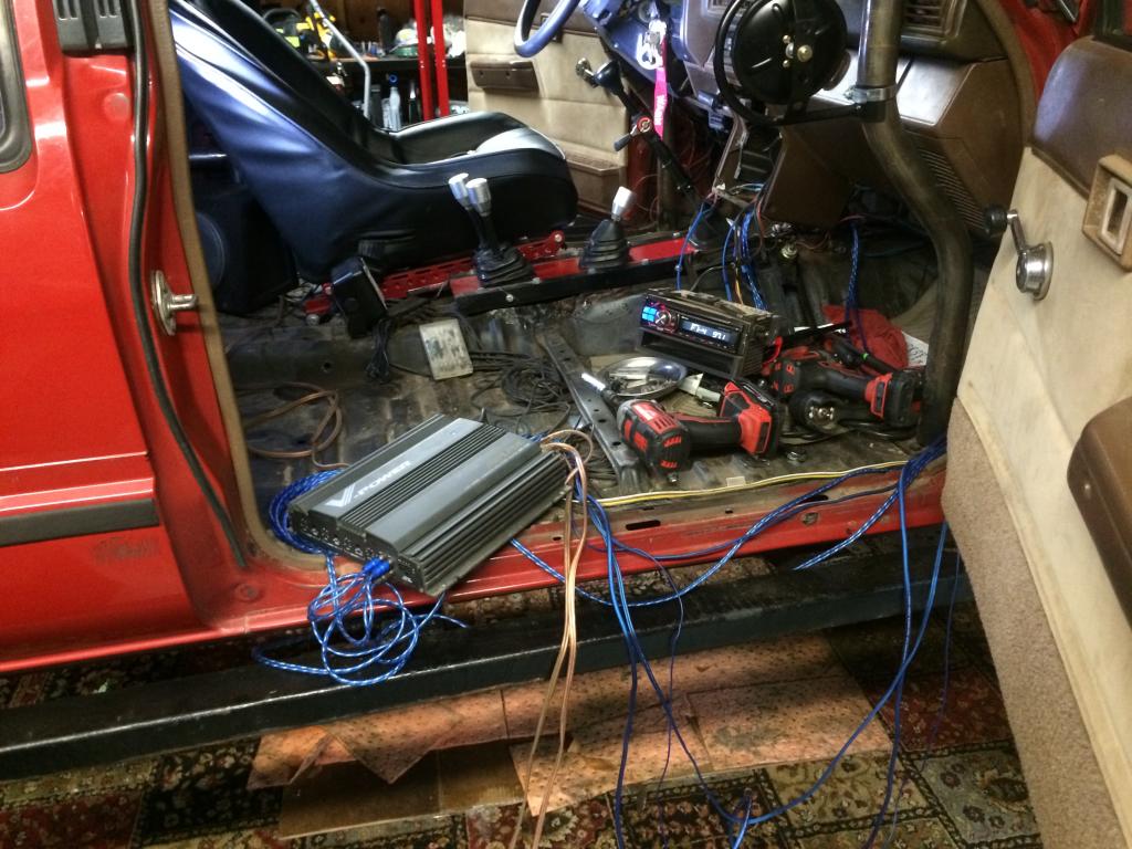

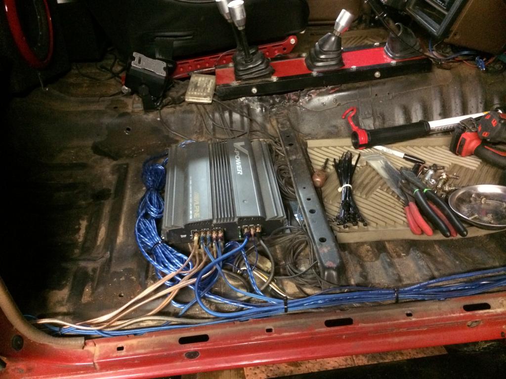

Added a little boom to the red truck over the weekend. A single Punch 10 and an older Alpine 5 Ch amplifier.
Cost = free.
Sounds pretty decent. I need to play with the settings on my head unit some more tomorrow. It's a little late to be bassin in the garage.
Everything worked on the first try.
Initial test
Cleaned it up a little

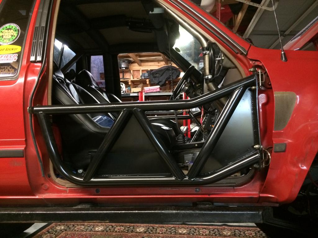

Got my tube doors painted and did the quick release pins in the hinges to make swapping doors easier.

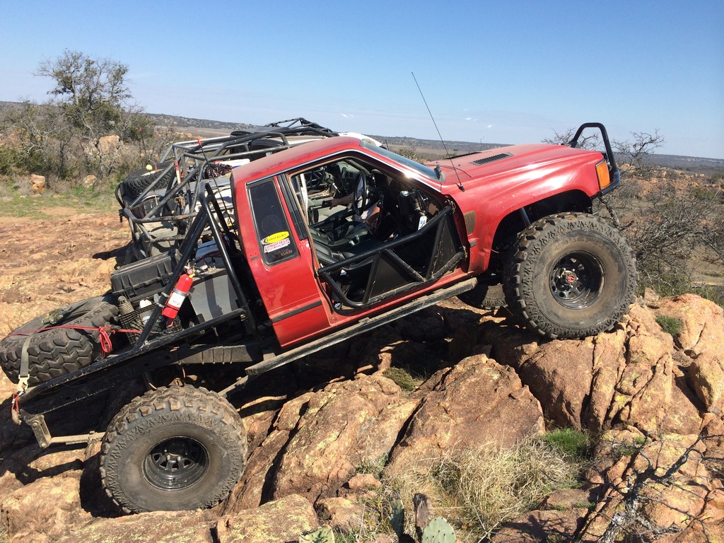

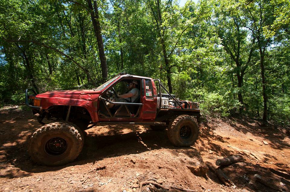

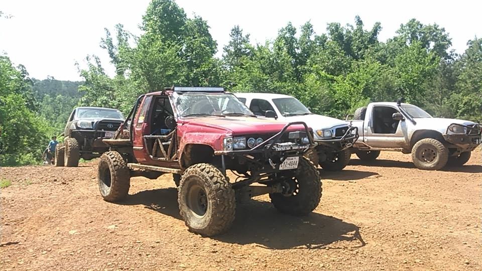

Here are a few pics from K2 this past weekend. I managed not to survive unscathed except for a driveshaft issue. This park continues to impress with some great wheeling!

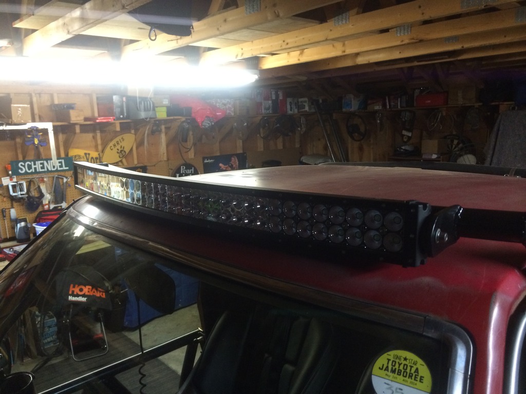

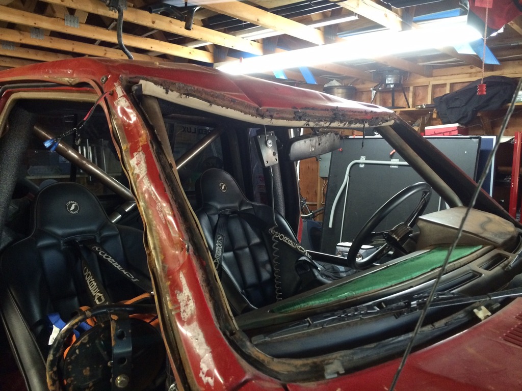

I have been slacking on pics as of late.

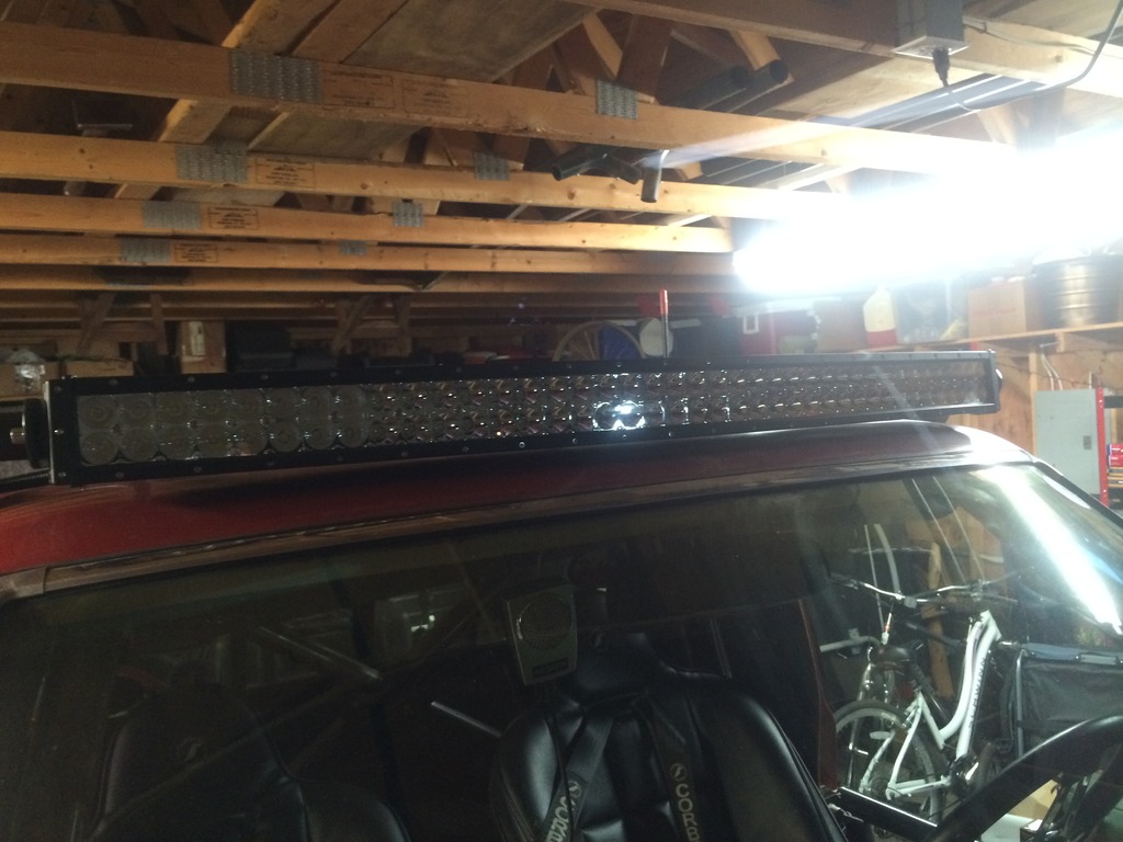

Got my light bar finished and painted. I picked up a 42" radius bar on Amazon that didn't break my wallet. I ran the wiring up from under the hood and up the A-pillar to supply power for the light. I used grommets and some clear poly sealant to seal everything up. I have about a 1/4 inch gap between the bottom of the bar and the roof. I also moved the mount back further to reduce any unwanted glare off of the hood and windshield.
Some Wheeling pics from Lonestar Jamboree 10

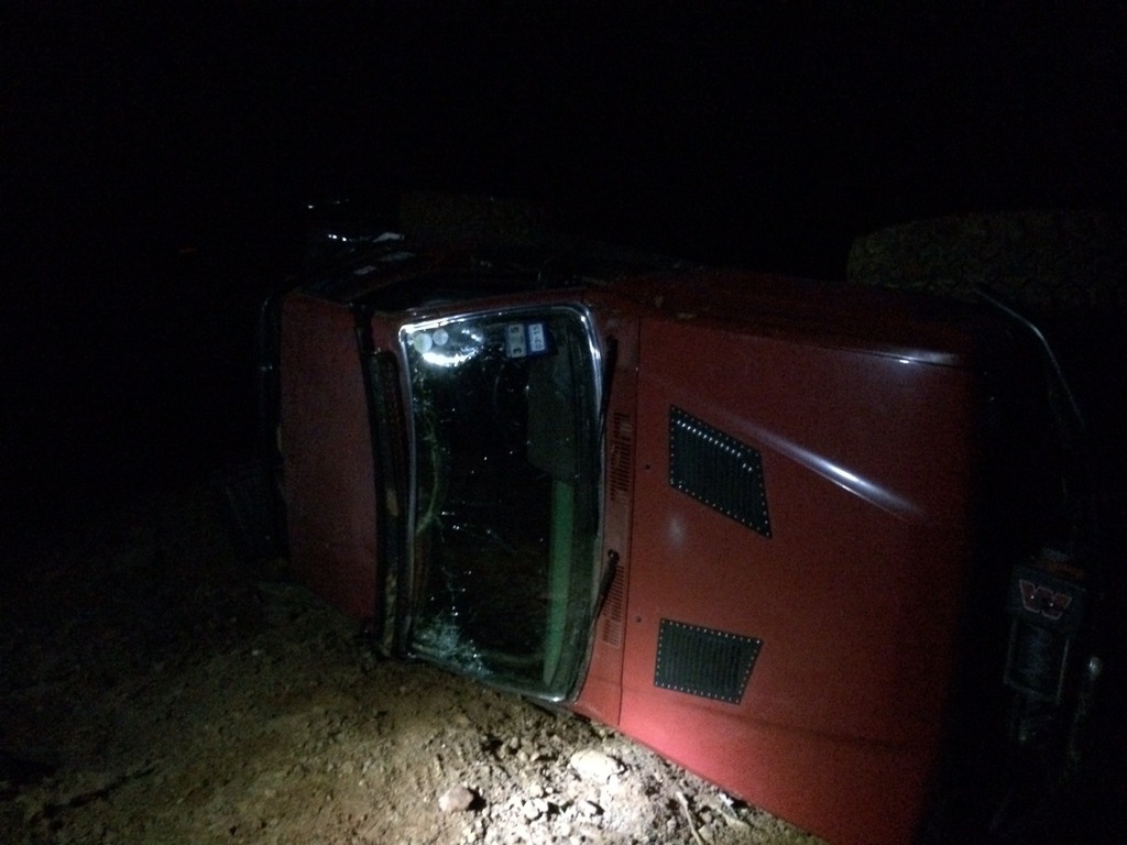

So I finally got around to putting all of my pics together.

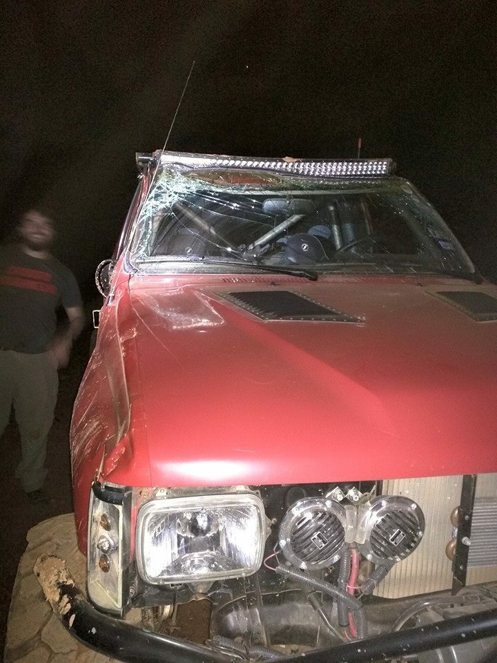

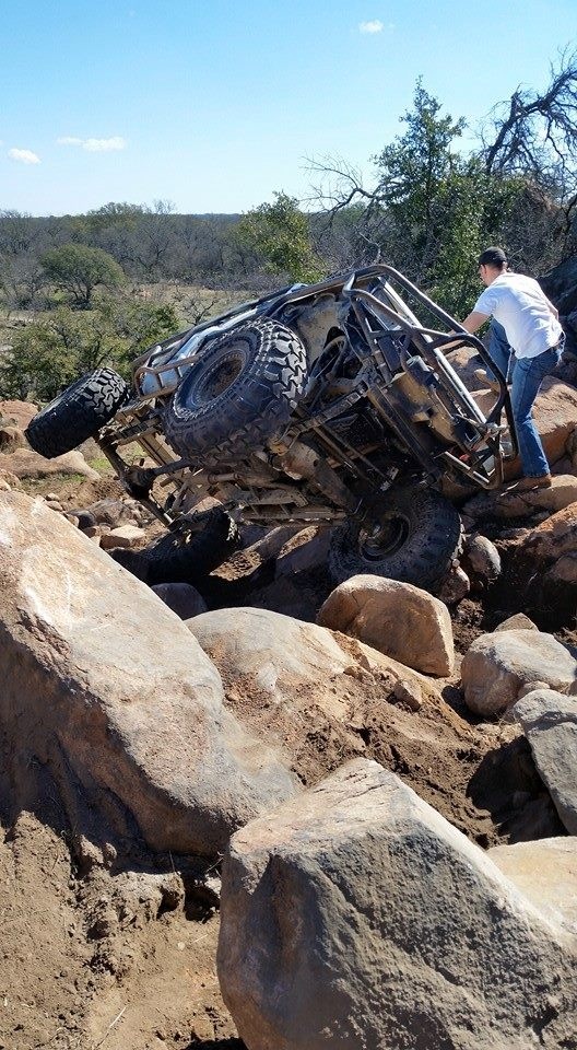

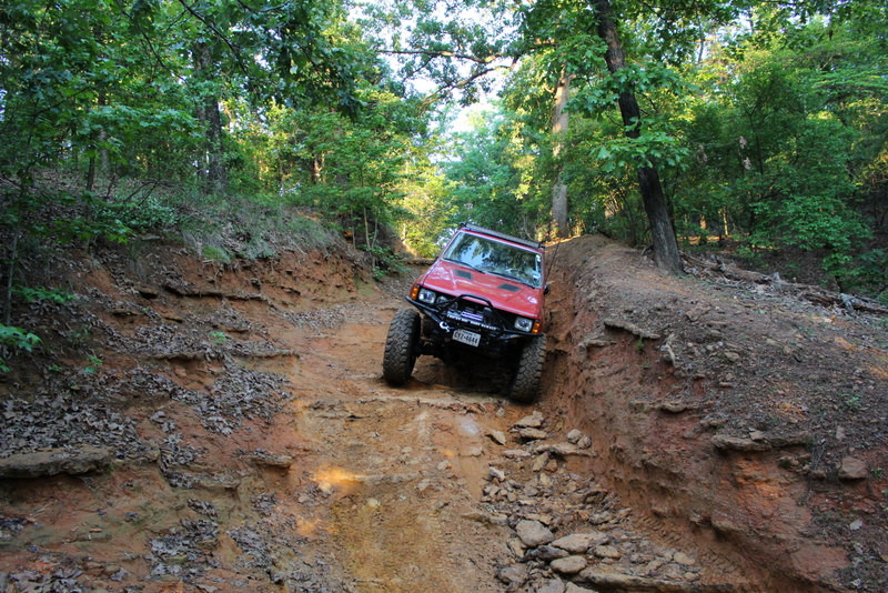

Started off on with a little hard luck on Thursday on JB Turnpike.
Video of turning it back over
https://vimeo.com/126571049
Aftermath
Thank god for the cage. This is the most damage I have had ever in one weekend.
Got it recovered and wheeled the rest of the weekend. I think I spent more time fixing trail damage than wheeling but that is part of it. I still had a great time.
Now it's time to do a little body work and get on with the axle swap. Lots of work ahead.

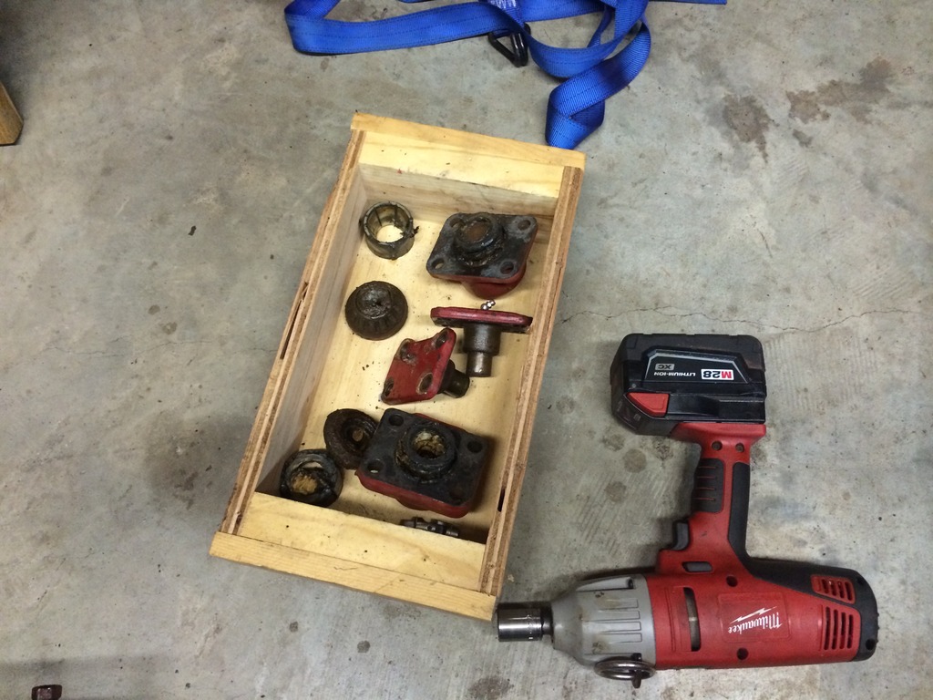

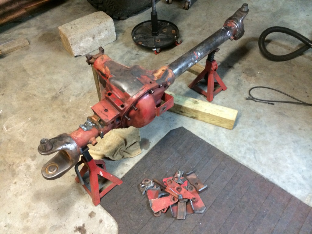

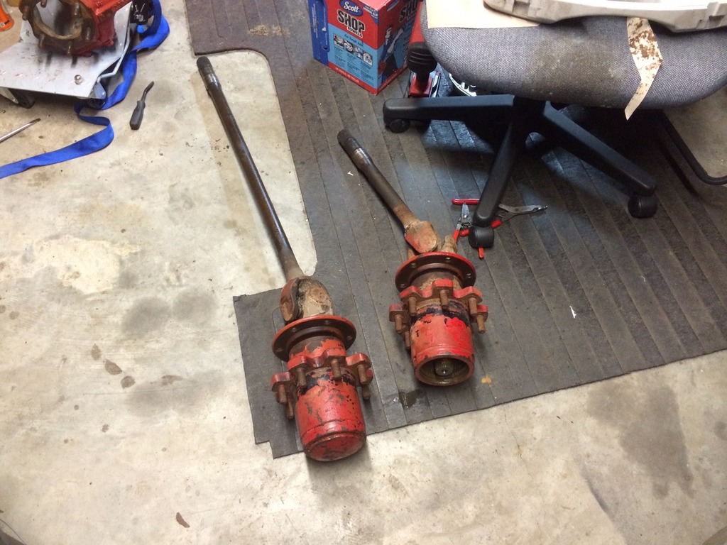

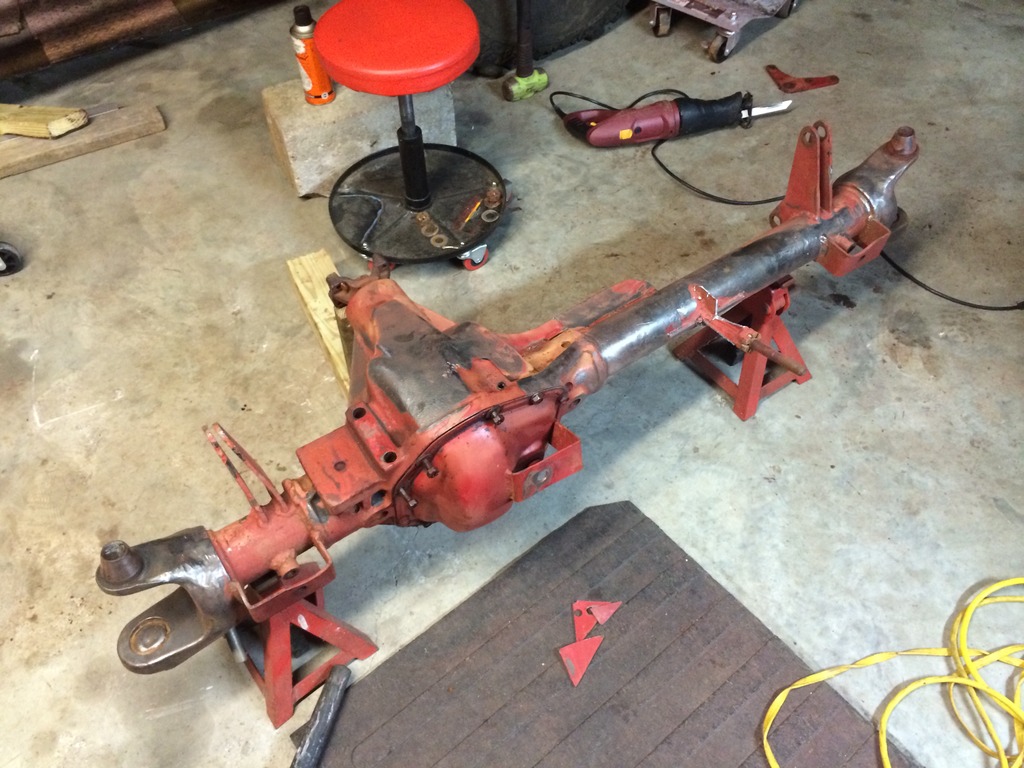

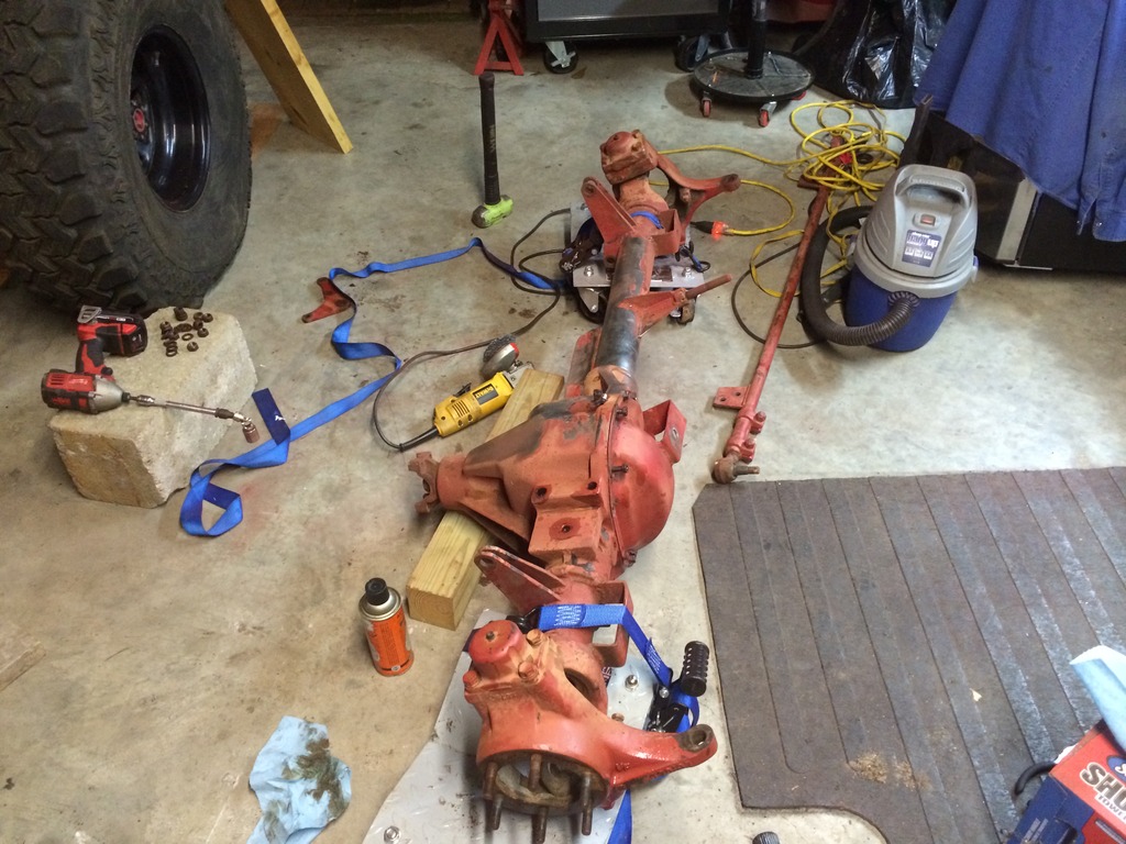

I picked up my front axle over the weekend. Got it unloaded and started tearing it apart this evening. Turns out the axle has drive flanges. I removed the tie rod and pulled the axles. Looked ok. Had a couple of areas that looked like they were starting to wear a little. I also pulled the cover to verify what gearing I have which is 3.54. Now I know what gears and locker I need to pick up. Looks like the BOM# is no more. I'm pretty sure it's a chevy axle though. This is one heavy SOB. I'm picking up another set of jack stands and an engine hoist this week so I don't have to work on the ground. Then I will start burning off the all the unneeded bracketry and clean the axle up some more.

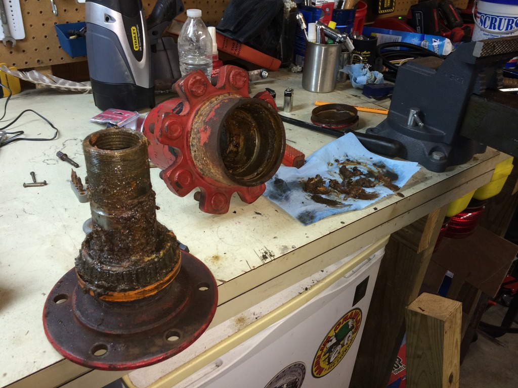

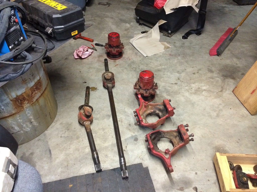

Then I got the knuckles and hubs pulled off and apart. The lower kingpin trunnions need to be replaced. The king pins look good. I'm going to order the bearings and seals tomorrow. Then off the the blaster to get cleaned up after a little more trimming.
Just a little more grinding to go.

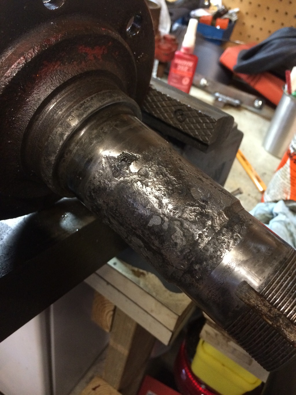

I figured out why the passenger side hub didn't want to turn.
Time to find a spindle and order some bearings and seals.
