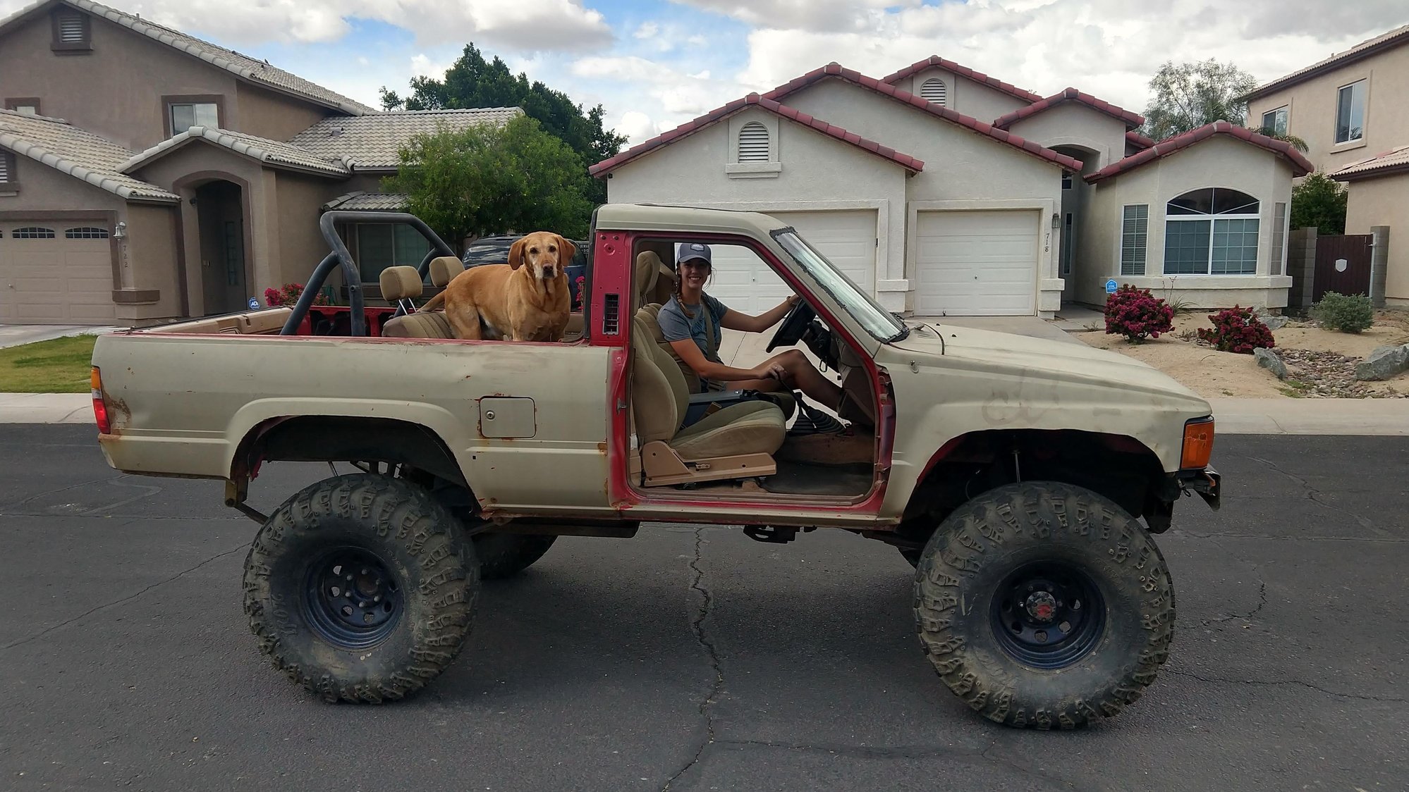

I bought this truck back in 2016 with every intention of making it into a full blown crawler.. while working at a mountain bike shop and living paycheck to paycheck. Needless to say it didn't quite go that way. I took it out to the sand dunes with some friends on some brand new 37s, a spool, and factory steering. Plenty of beer and getting in way over my head didn't do it any favors and I limped it back to the flatbed, got it home, put a marlin crawler high steer on and knuckle rebuild, and there it sat until about two years ago when I finally started to work on it again (read. SLOWLY)
​​​​​​I hope to use this thread to post my progress, receive some feedback, and keep myself motivated to see it on the trails some day soon. I have a grown up job now, but much less free time. My wife and I just welcomed our first daughter into this world a week ago, so between that and work I won't have a ton of free time, but I'm hoping to make good use of the time I do have. Finally, if this is the wrong place to post this or I am violating any posting rules, please feel free to remove. I am a big time forum lurker but not a big poster so please bear with me.
Ok enough of all that, here's some pics of the rig.
The one and only dune trip above. Can't say we didn't have a good time though.

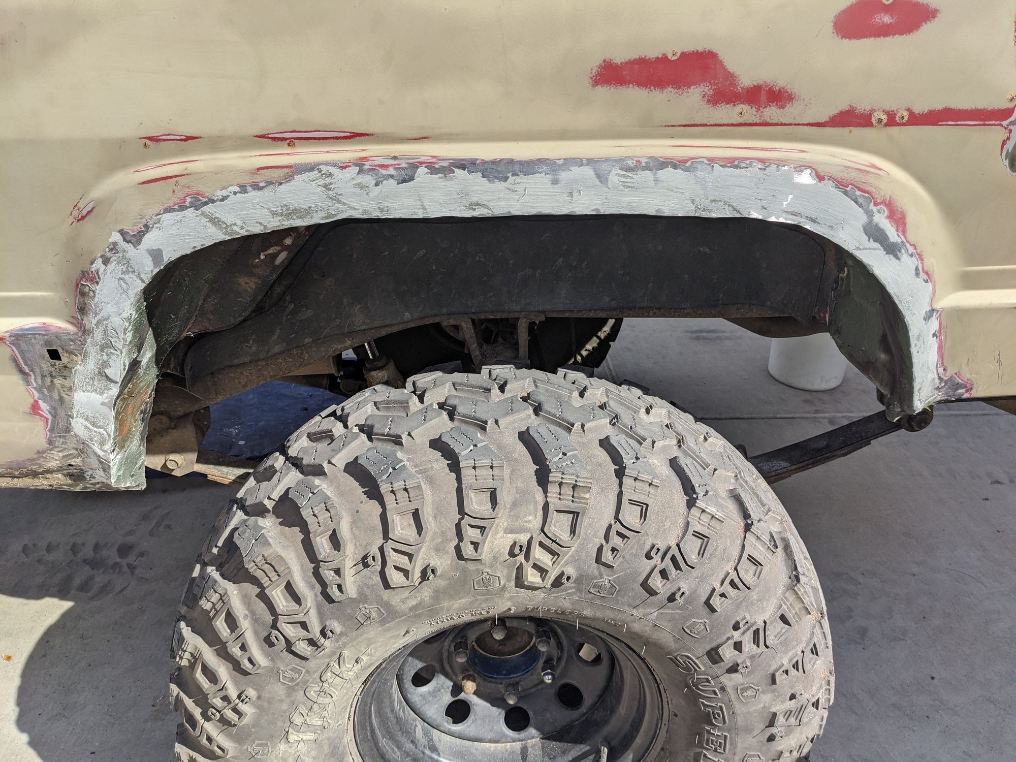

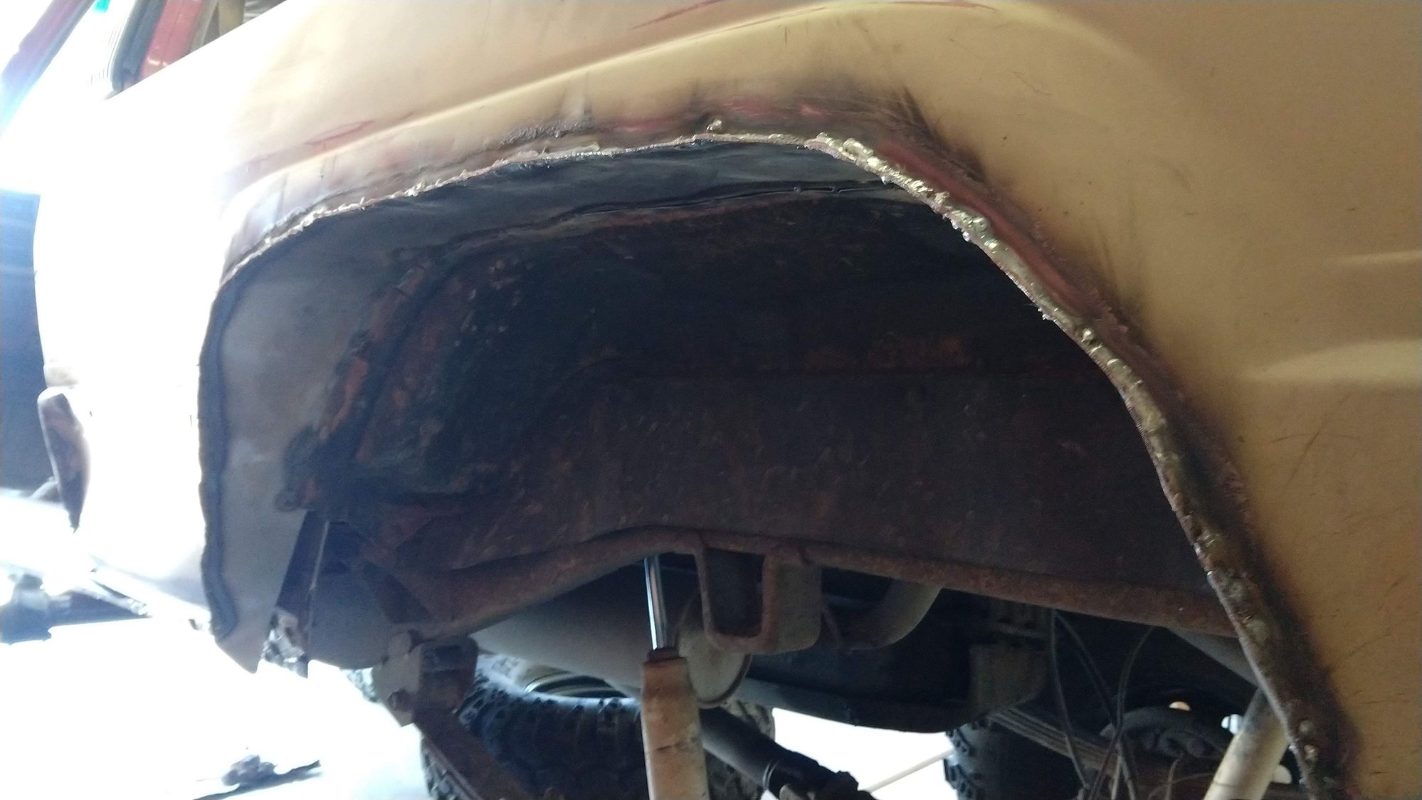

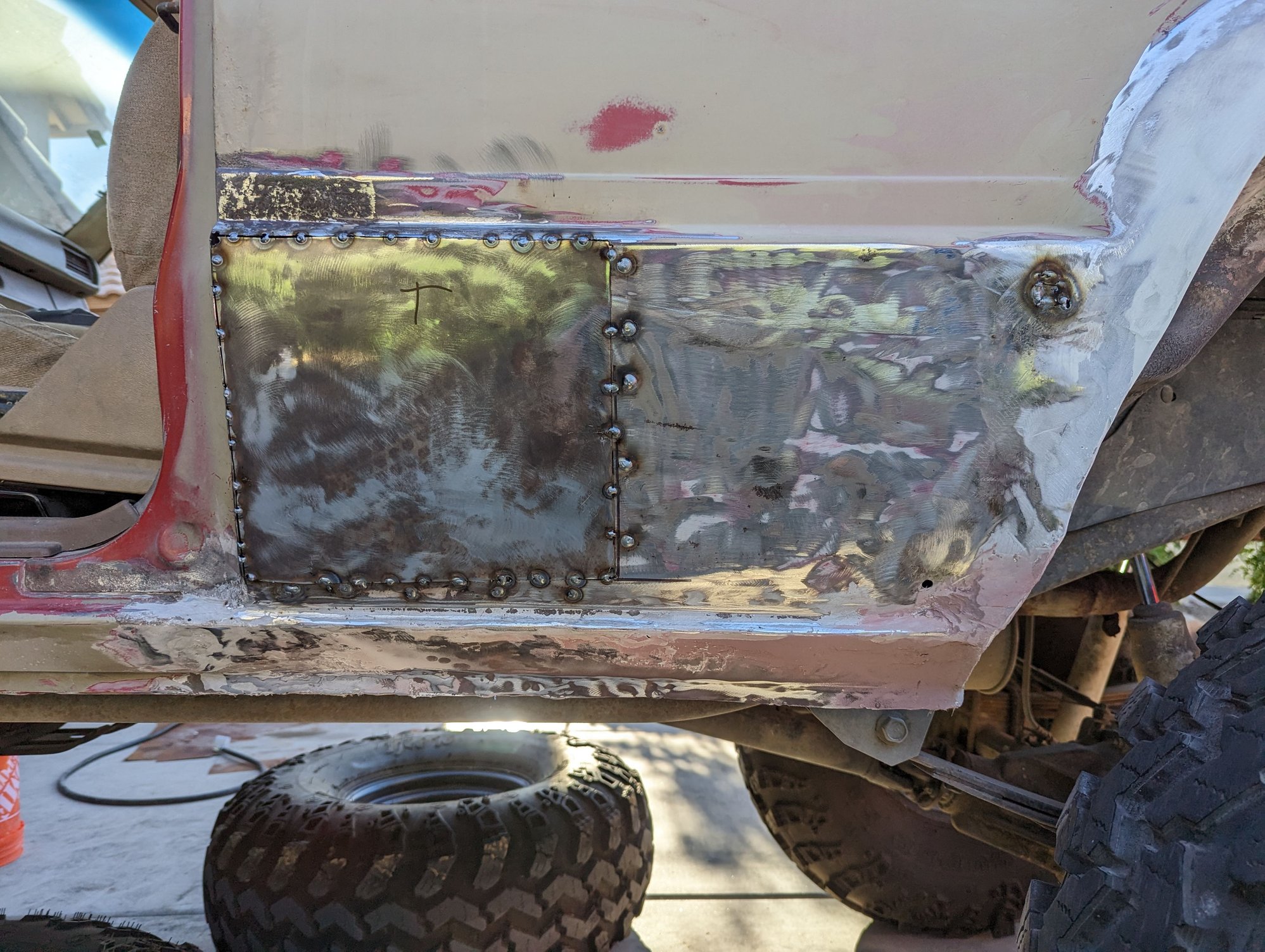

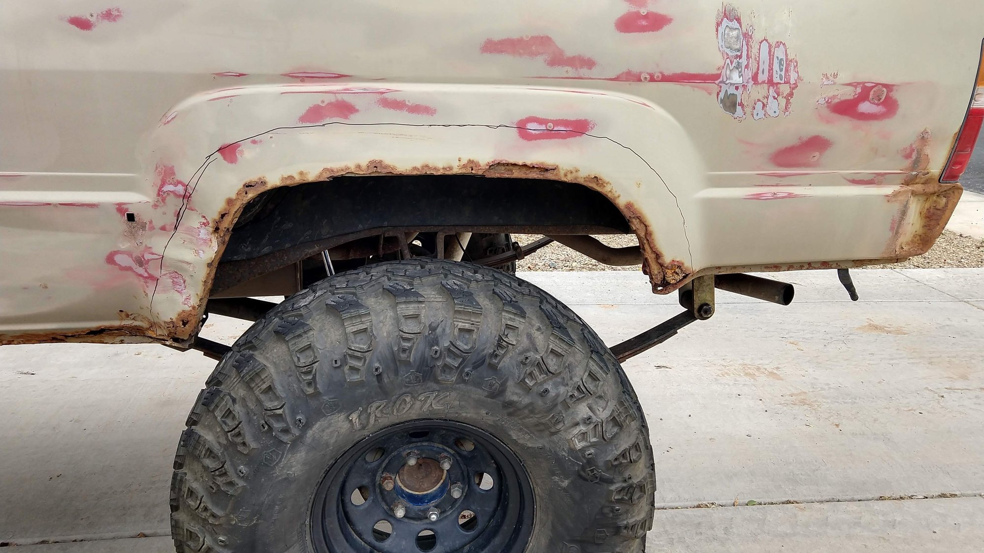

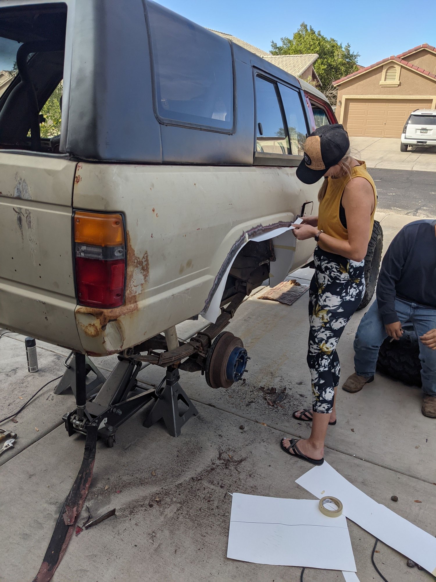

No shortage of rust. I decided to cut these out and weld in some sheet metal.
Wife helping make the pattern
Once I started I figured may as well fix some other spots while I'm at it
Ready to trim
Some Bondo glass to seal it up

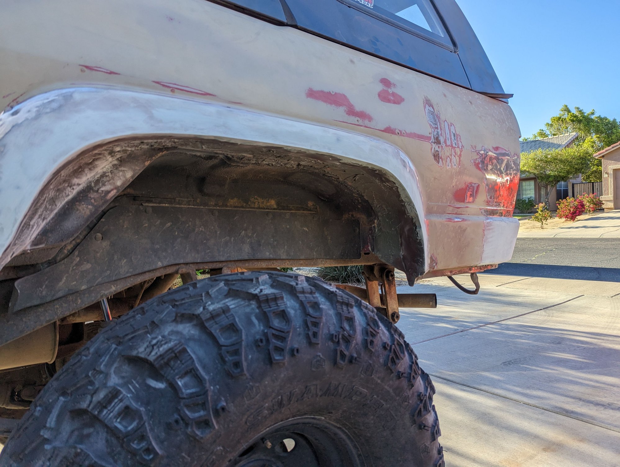

Fenders turned out pretty good!

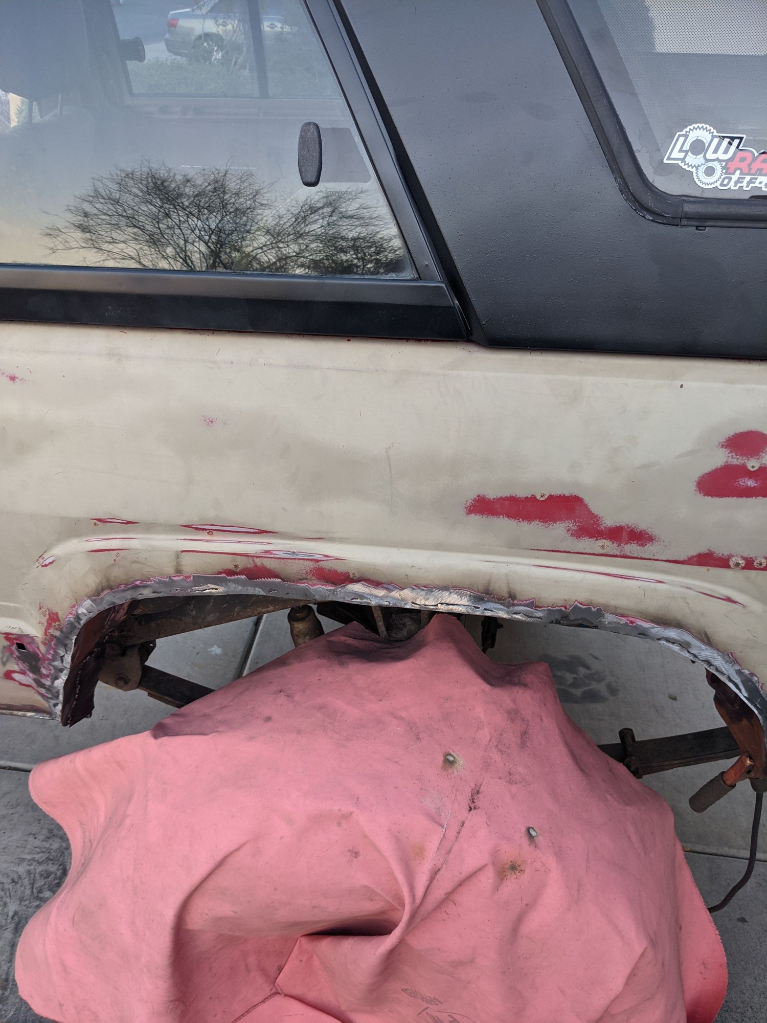

More body work. These corners were crushed and rusted out. Welded in some new sheet metal and then my father in law did the Bondo. He's much better than I am.
More patchwork started

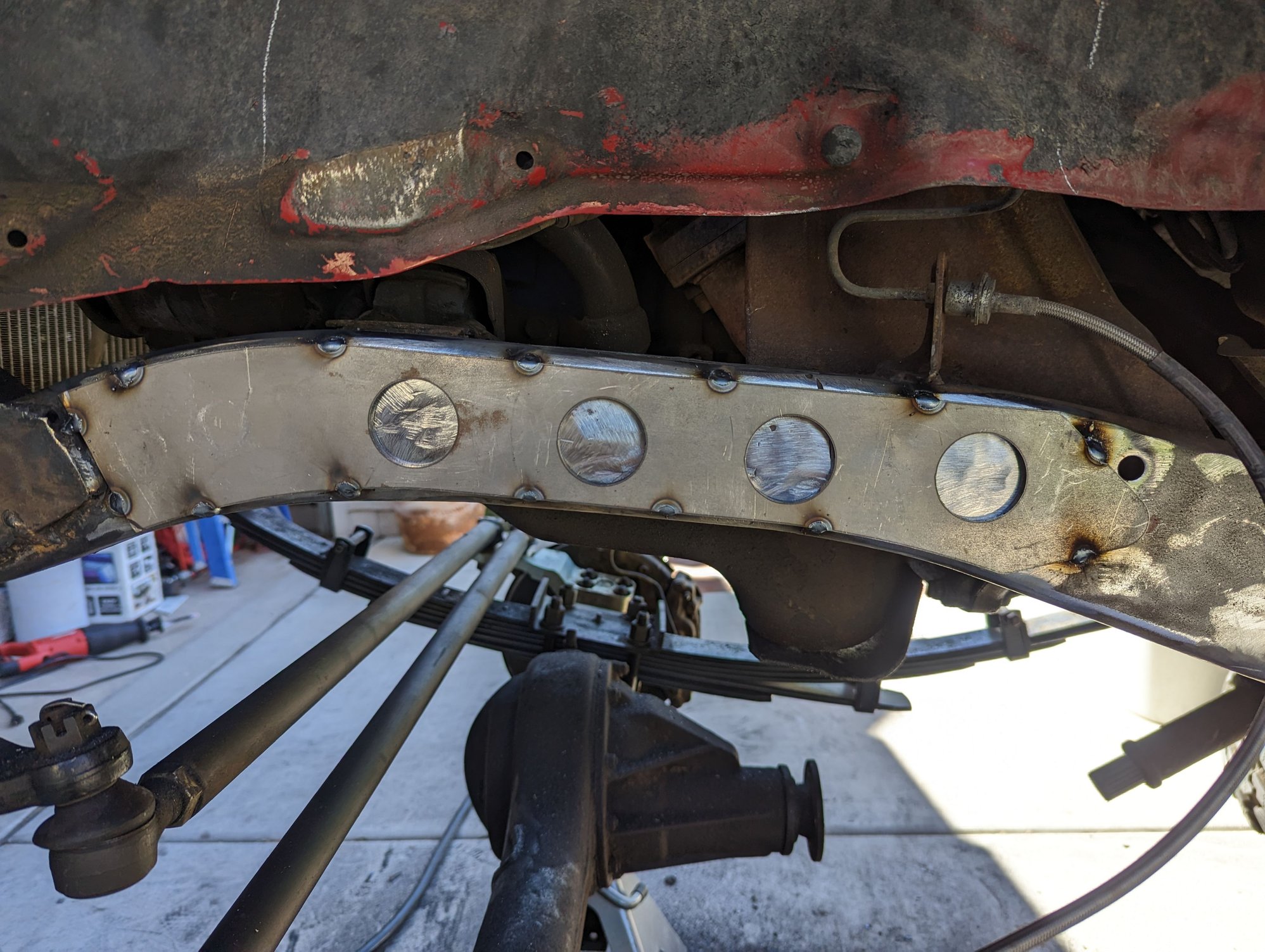

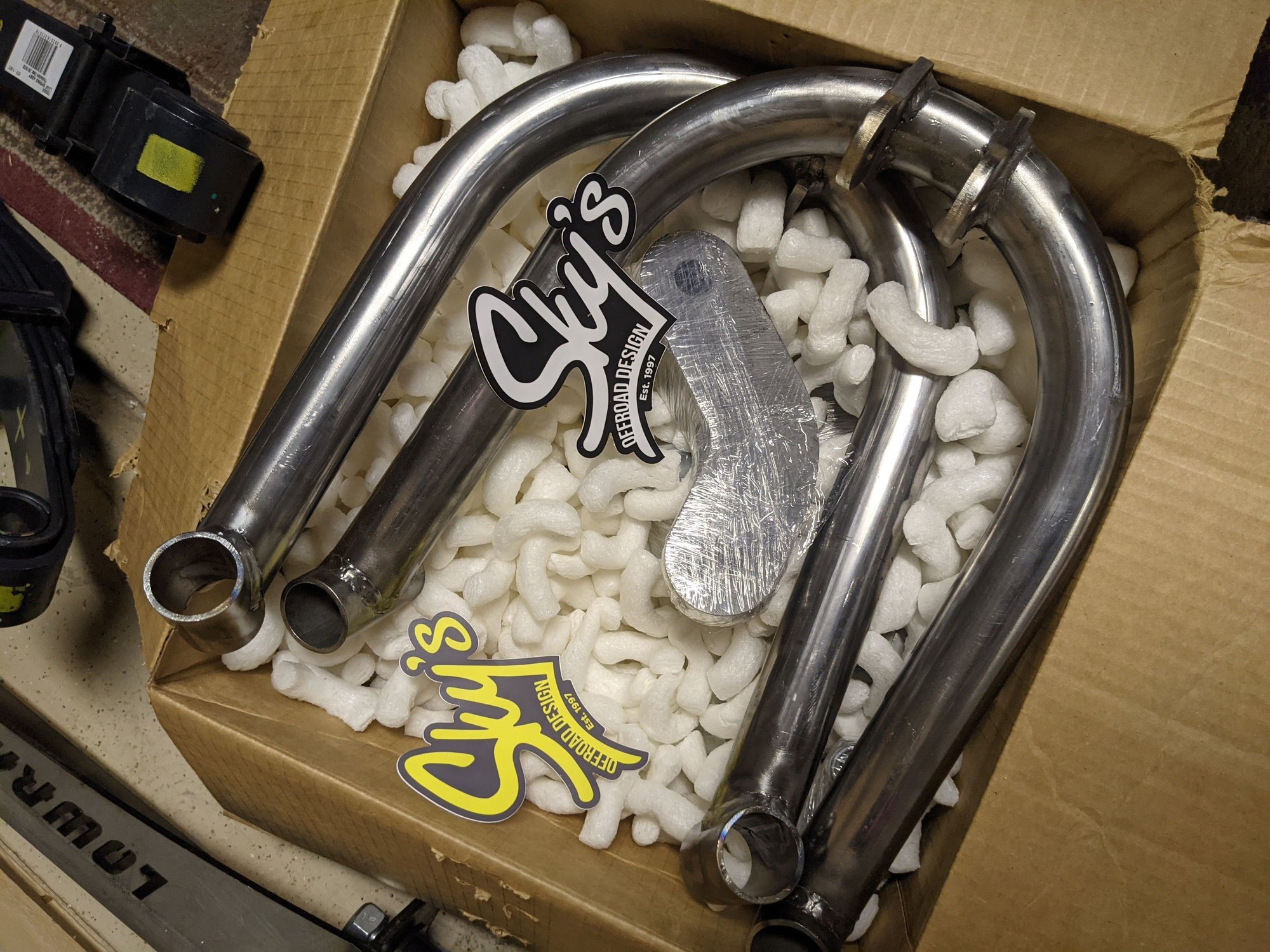

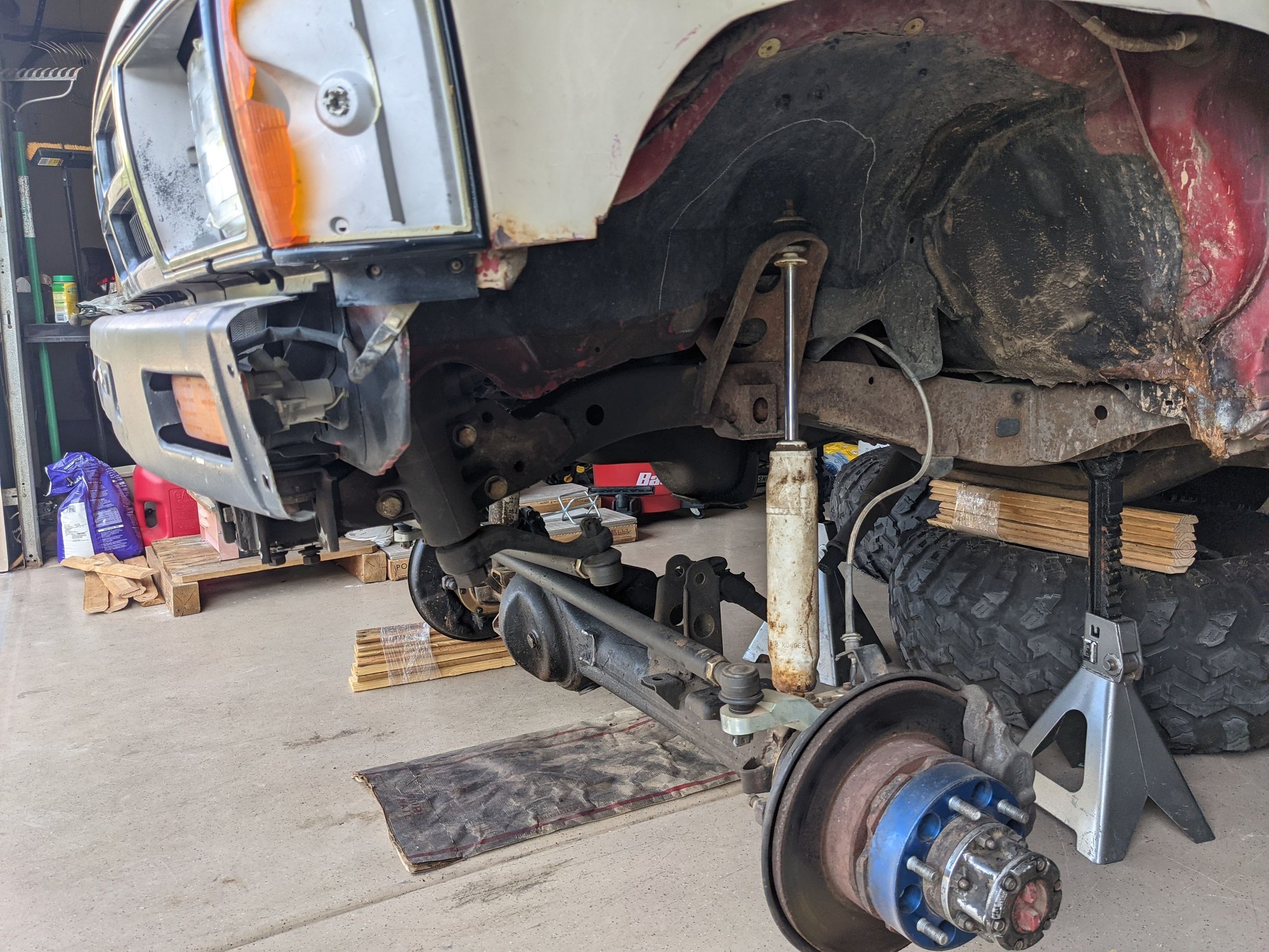

After lots of reading i decided it was time to upgrade the front suspension from the crappy blown out pro comp springs the previous owner had put on. I decided to do the RUF swap and went with some Old Man Emu CS009r springs, a Low Range Off Road front hanger, and some Sky's Off-road boomerang shackles.
Used the tow hook bolts to mock up the front hanger. Shackle angle is a little on the steep side but I think it will get better when the springs settle.
Also snagged some Sky's shock hoops. Top quality stuff

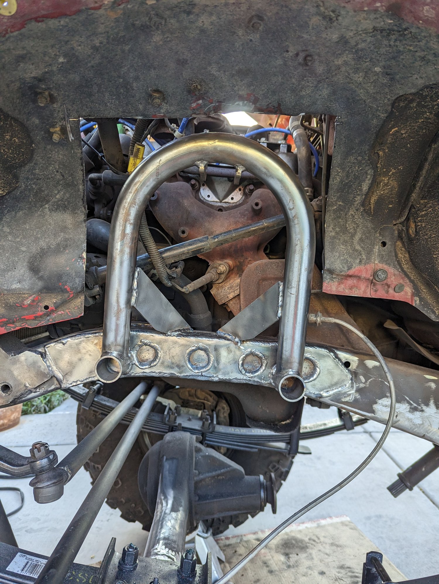

Started cutting off the old shock hoops and unnecessary brackets from the frame to prep it for the frame stiffeners and shock hoops
Cleaned up
Tacked in
Driver's side welded out
Passenger side welded out
Shock hoop welded out and braced

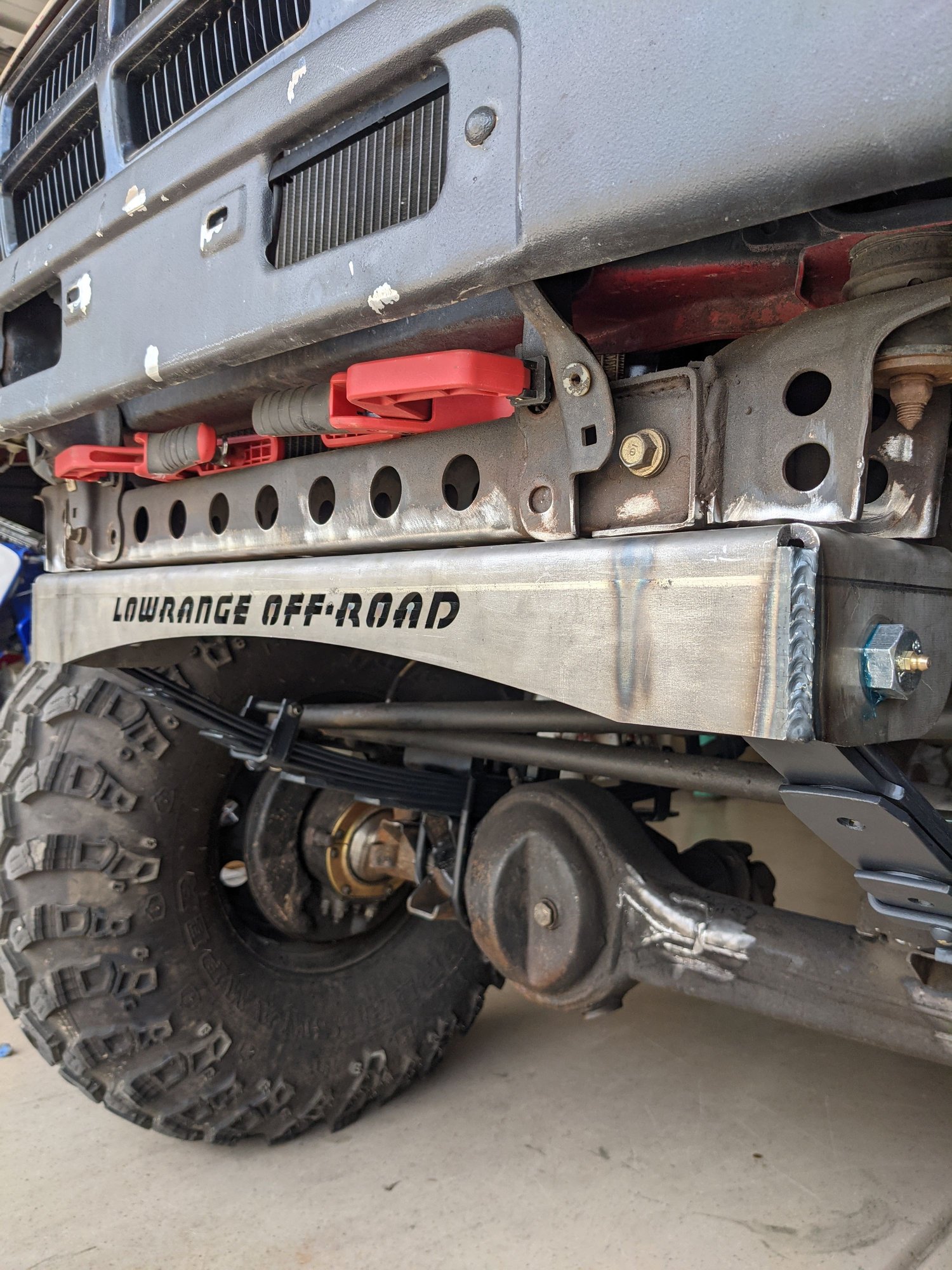

I ordered these knuckle gussets from slag factory off road. Tacked in for now
Some good ol Rust-Oleum on top of it all

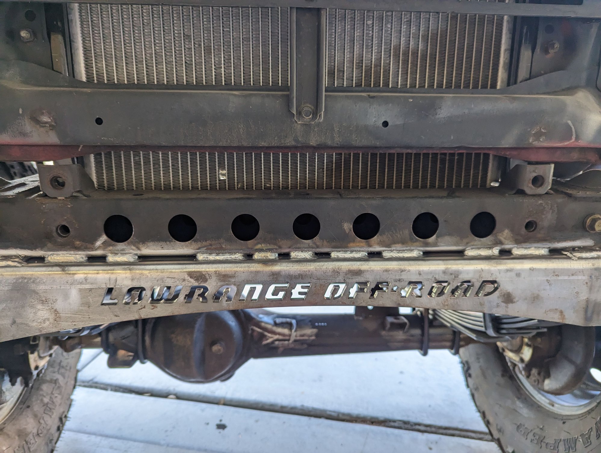

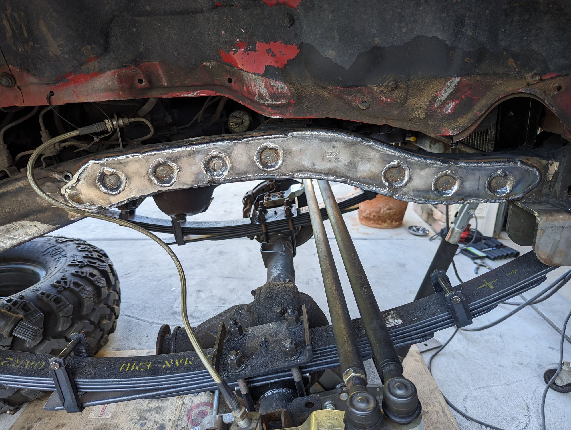

Also started welding the front truss from Ballistic Fabrications
Front hanger welded out

Finished welding out the truss and upper shock mounts/gussets. I went super slow to avoid getting anything too hot. Hoping to start the Chevy 63 swap in the next weekend or two.
