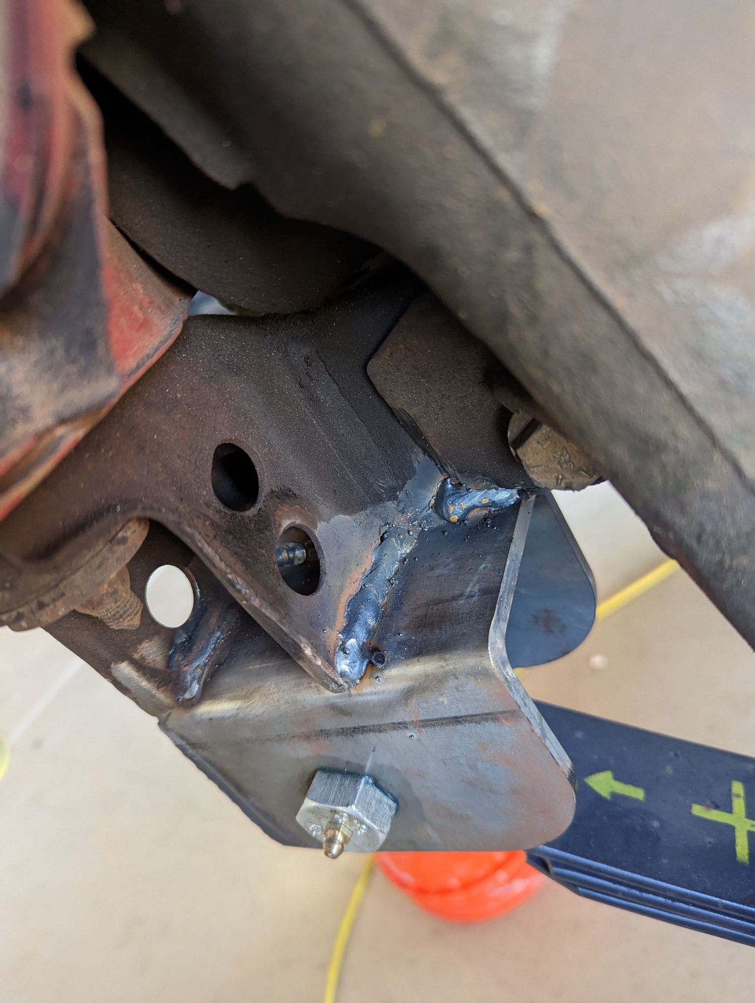

After lots of reading i decided it was time to upgrade the front suspension from the crappy blown out pro comp springs the previous owner had put on. I decided to do the RUF swap and went with some Old Man Emu CS009r springs, a Low Range Off Road front hanger, and some Sky's Off-road boomerang shackles.
Used the tow hook bolts to mock up the front hanger. Shackle angle is a little on the steep side but I think it will get better when the springs settle.

Got the hanger where I wanted and started to weld it up
Not so pretty but it'll hold. I also welded the bottom where I could.
I did short stitch welds on opposing sides to keep it from getting too hot. I haven't decided if I want to leave it stitched, or if I should weld it out the rest of the way. Open to feedback

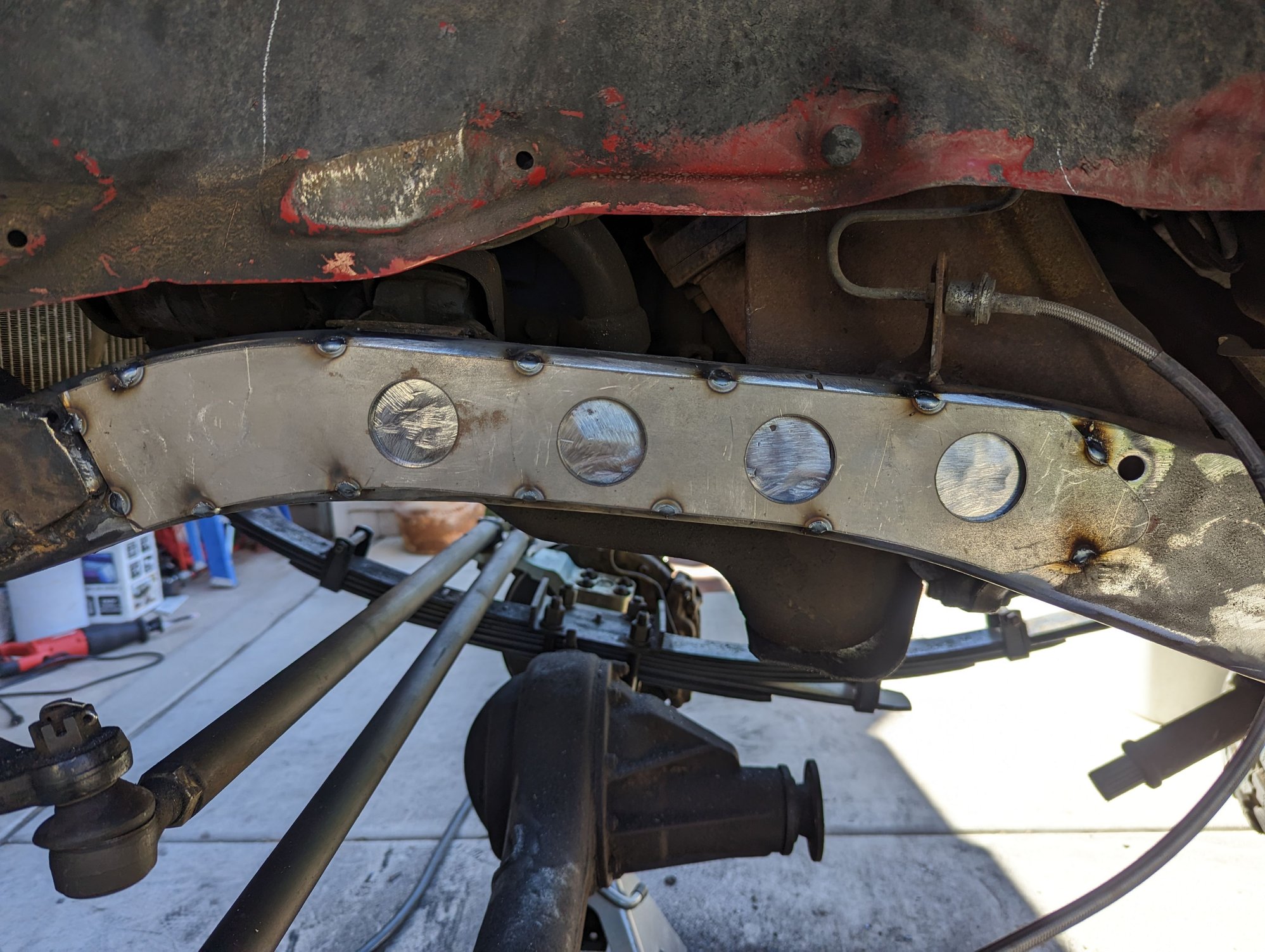

Getting ready to mount the shock hoops.I bought some frame stiffeners from Trail Gear that I figured would give the shock hoops something to bite on and reinforce the frame a little. Started cutting off the old brackets.
Cleaned up
Tacked up
These took way longer than I anticipated. Again not the prettiest welds but not the worst 🤷‍♂️
How she sits currently. Hoping to get the shock hoops on this week.

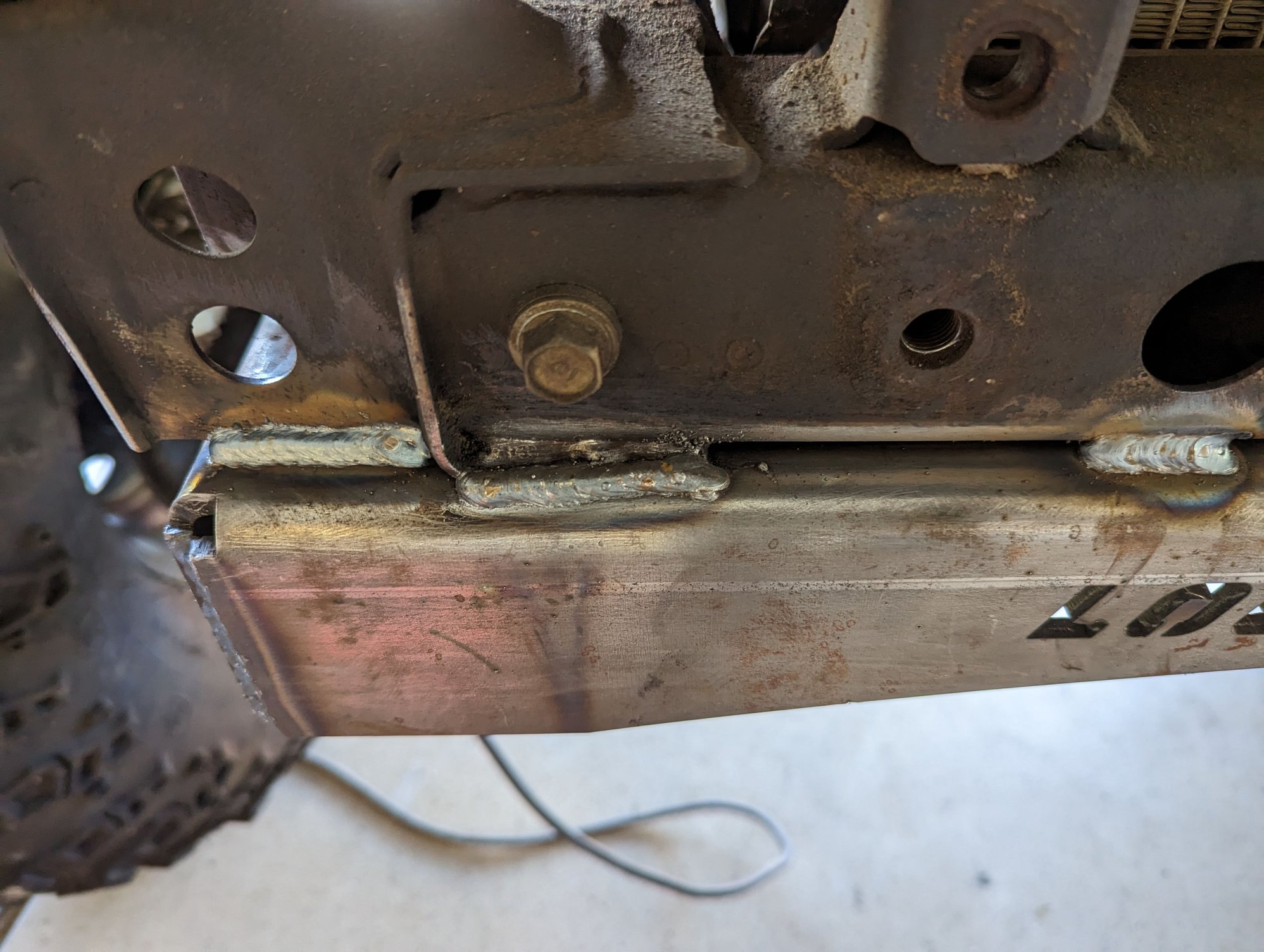

Start welding the front hanger out
I tried to weld these wherever possible. Not the prettiest weld ever.
Stitch welded the front but debating on welding it out the rest of the way. Any feedback is welcome.

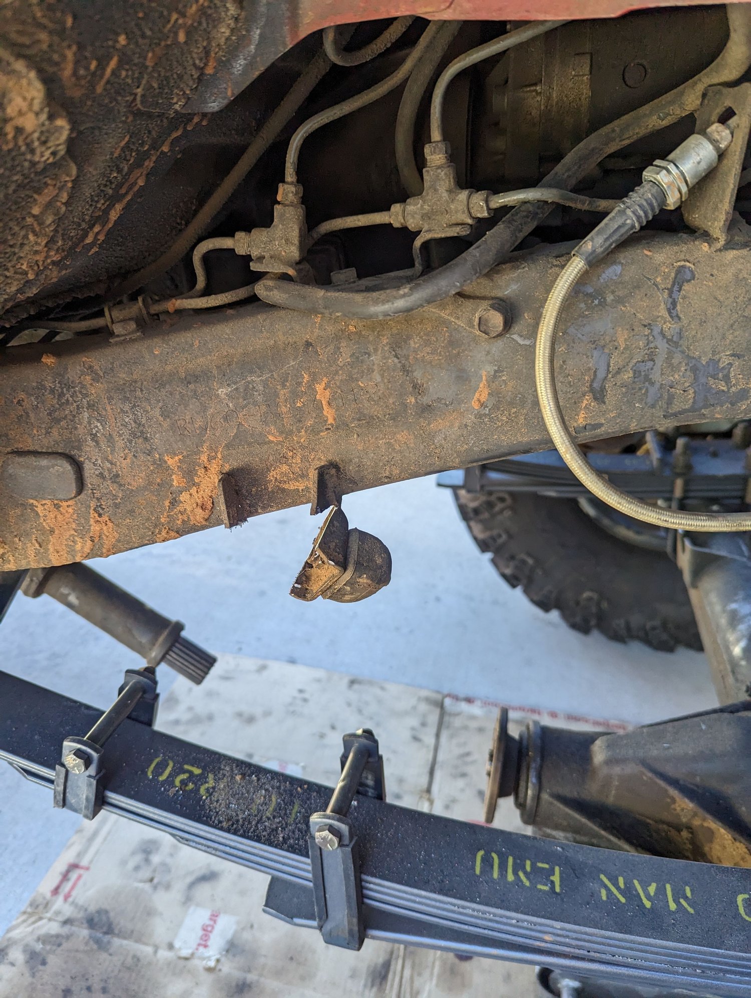

Cutting off the unnecessary brackets in prep to mount the shock hoops and some Trail Gear frame stiffeners
Prepped

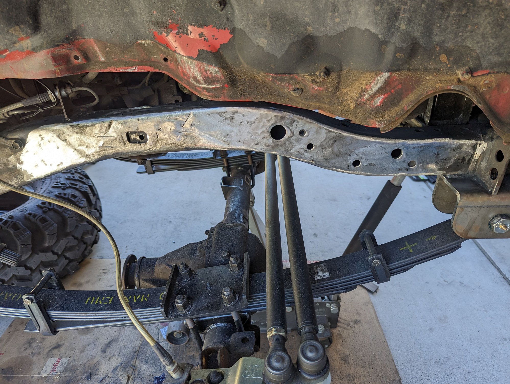

Tacked up
These took way longer than I anticipated. Not the best not the worst but it'll hold 🤷‍♂️
