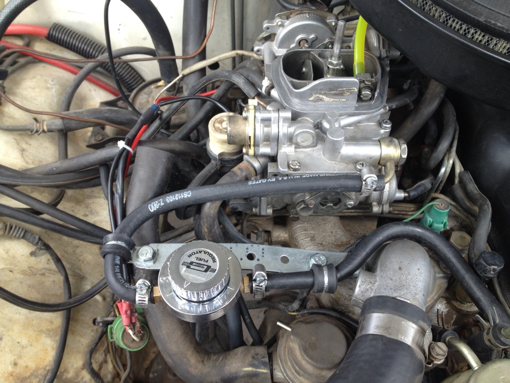

Well almost a year without any work done I finally started to get some motivation . Before I got into more fab work I decided to do some fine tuning on carb and ignition . Got the choke / high idle / low idle / air fuel dialed After dropping the float level quite a bit and adding a adjustable fuel regulator with a few more degrees ignition timing she's running smooth as ever. Fuel set @ 2.5psi for regular driving, and turn it down to 1-1.5psi for low speed steep angle stuff. Also vented the bowl overflow outside carb to help with flooding on angles.
30$ fpr
Bracket mounted and easily adjusted without taking cleaner assembly off.

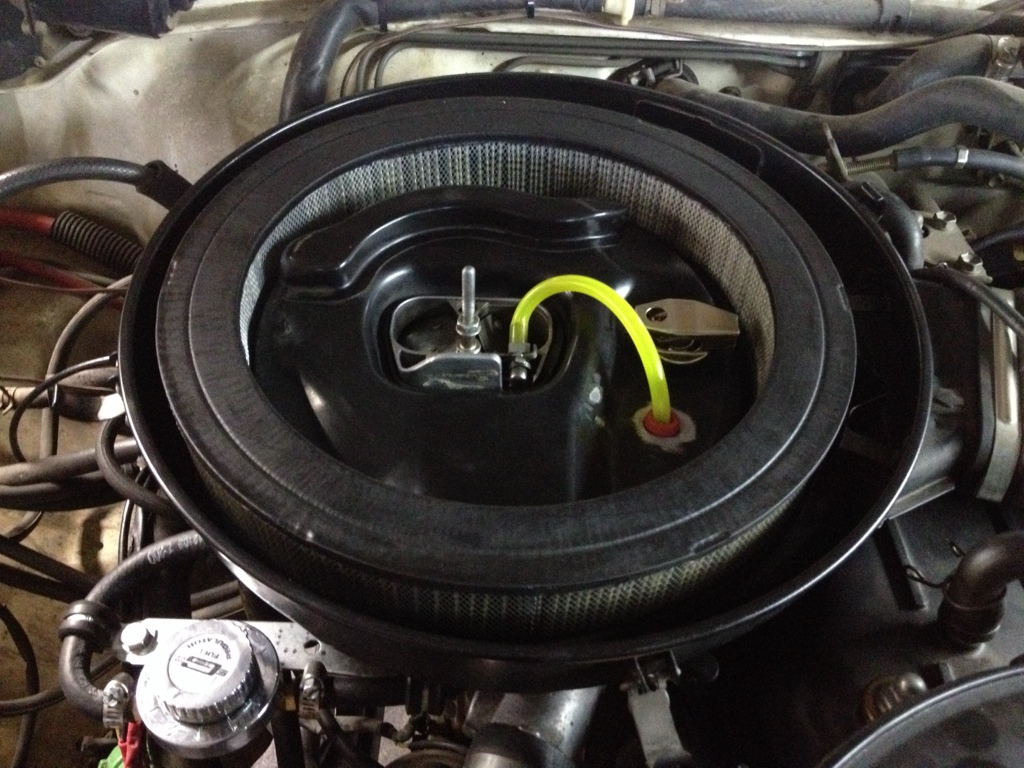

Overflow tube . Simple 3/16 motorcycle fuel tube and a rubber grommet . Drilled hole in air cleaner housing and ran it down the side of the block.

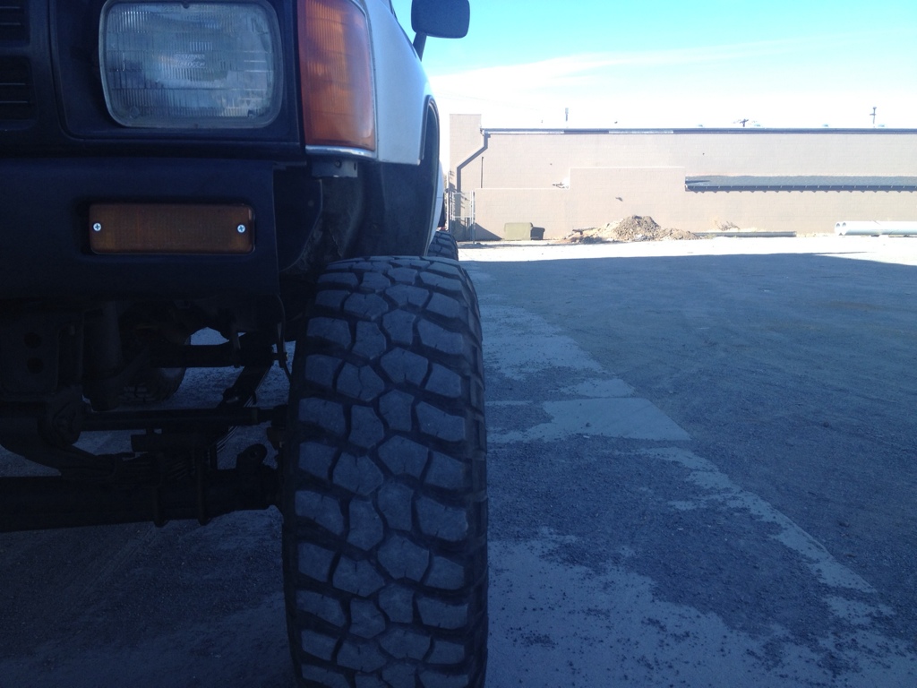

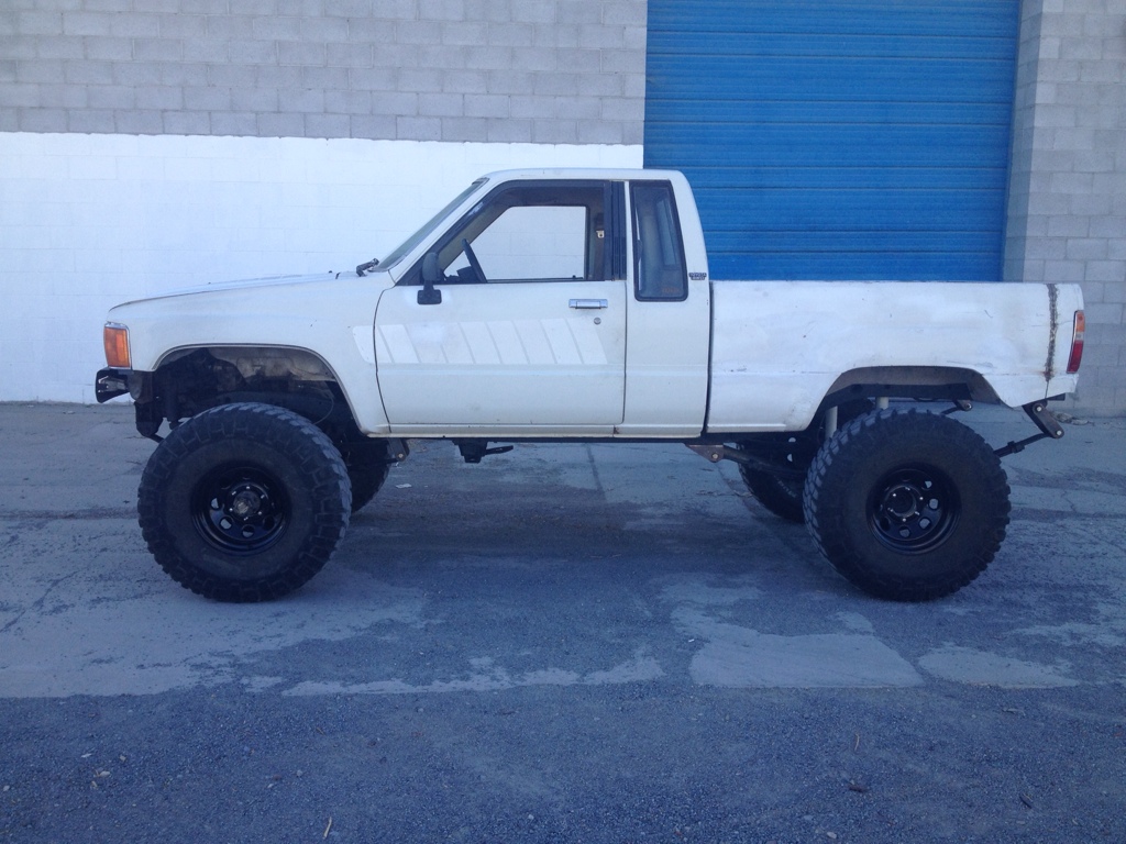

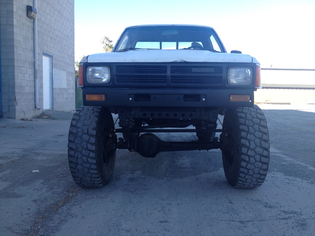

Took a few snaps of the truck on new to me wheels and tires. Much nicer stance IMO.
I can actually turn stop to stop now without rubbing on leaf springs !

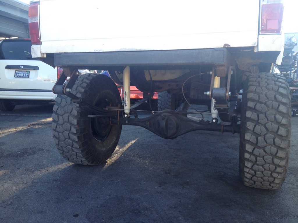

Rear tires almost touched the leaf springs before , now I got quite a few inches.
