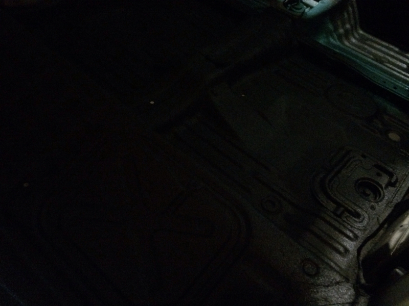

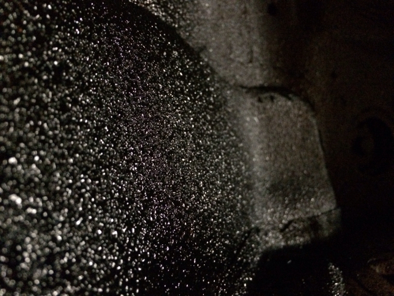

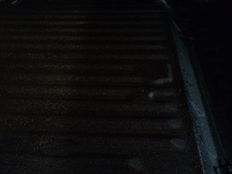

I cleaned the entire floorboard and the back to get ready for the primer. Then i degreased everything then primed it. After that had dried for a day or so I then but on the raptor liner. I only used 2 bottles of it but I plan on putting another coat for the back. Here are a few pictures they are dark but I will get some better pictures next time.
