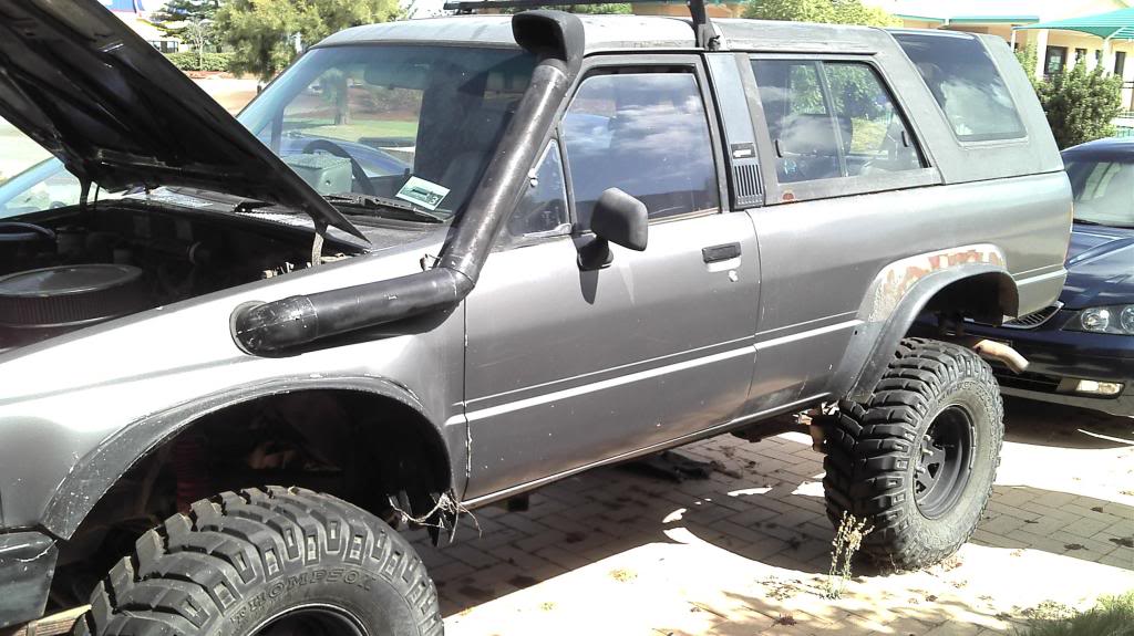

Gday guys
Been reading the forum for a while but thought it was time i made some imput
I live downunder in Perth Western Australia

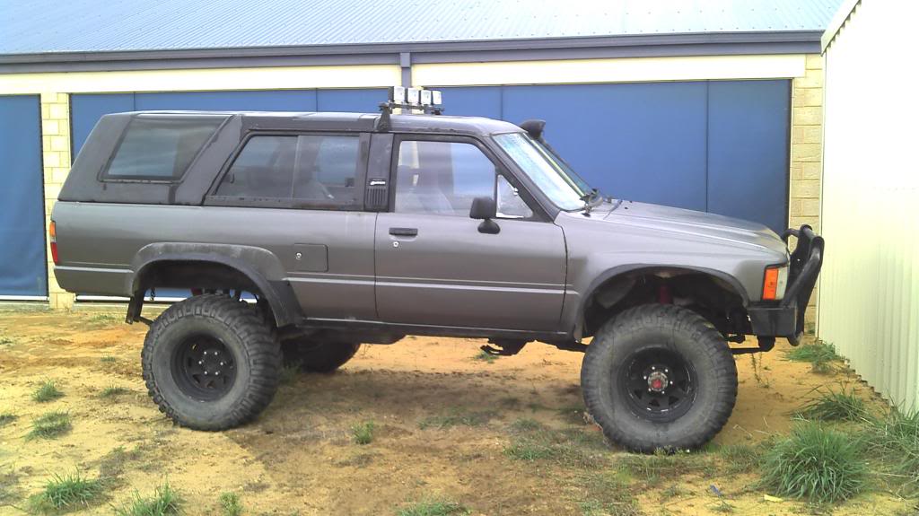

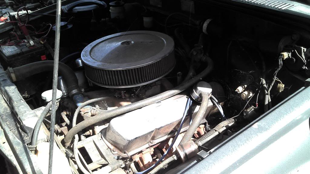

Ive got a 1984 4runner , that i am currently restoring as it was very rusty
fitted with a Holden 253 v8 (4.2L)
Its got 33" muddies
Powertrax rear locker
2" lift
Rancho shocks
Raised wheel arches

not familiar with holden what kind of HP is it pulling?

Holden is our aussie brand but its part of GM , introduced in 1968 the 253 4.2L and 308 5L was the early aussie v8 engie made by Holden , they stopped making the 253 in 1984 and the last of the carby 308 in 1991 replaced by efi 304 essentially the same . that was produced until 2000 when it was replaced by the LS1
Incidentally Holden have announced they will stop all manufacturing in Australia in 2017
253 has 174 hp (130 kW) at 4400 rpm
Torque 247 lb/ft (325 Nm) at 2400 rpm
Hope this helps

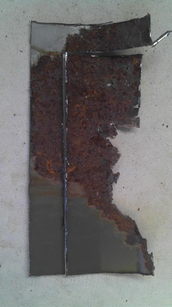

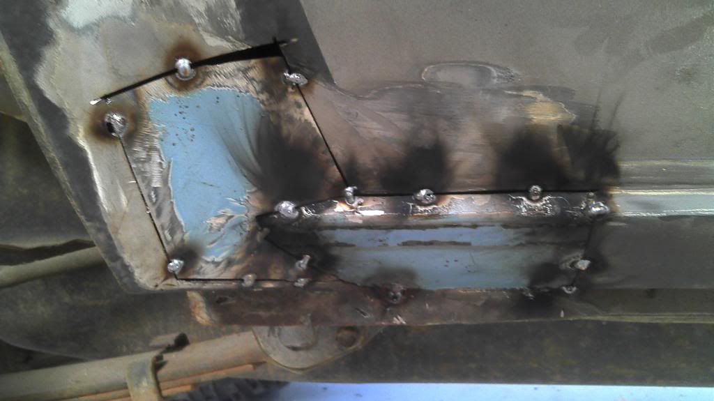

This is the lower rocker
This is the sections i cut out
I also treated the inside with rustkill
This is the patch panel i made from an old door i had lying around

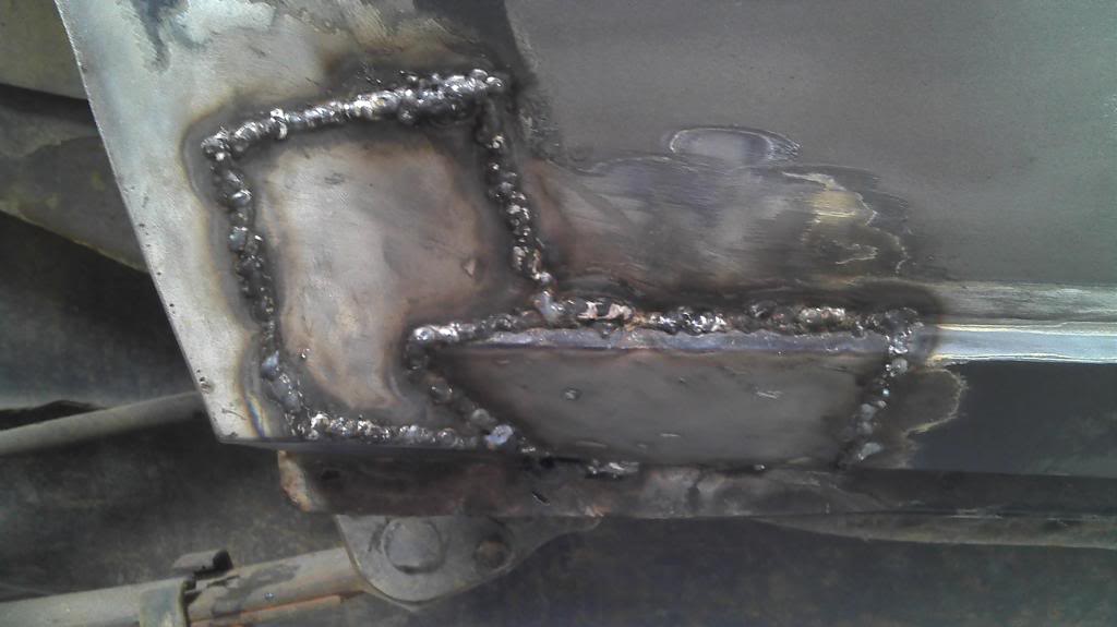

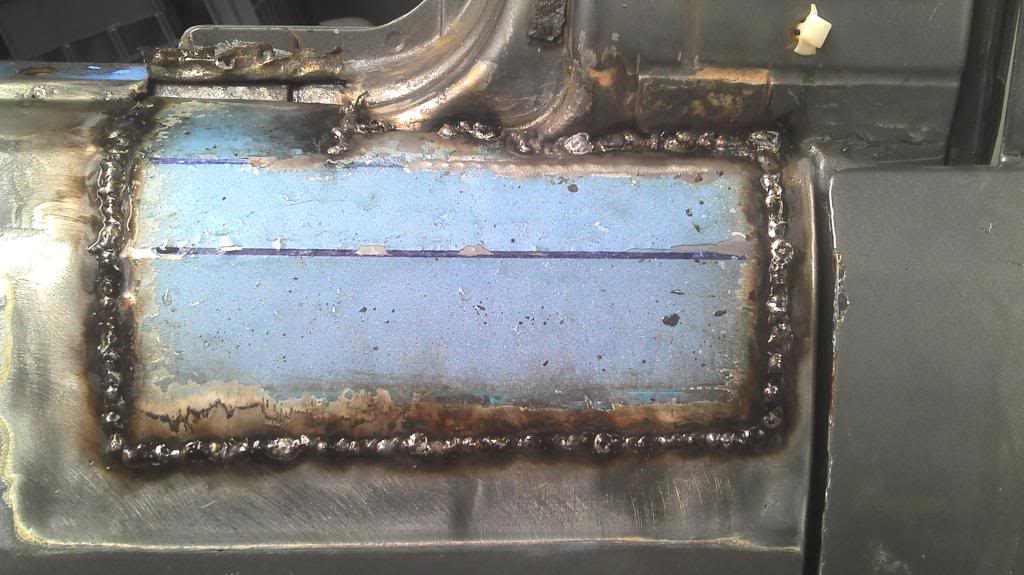

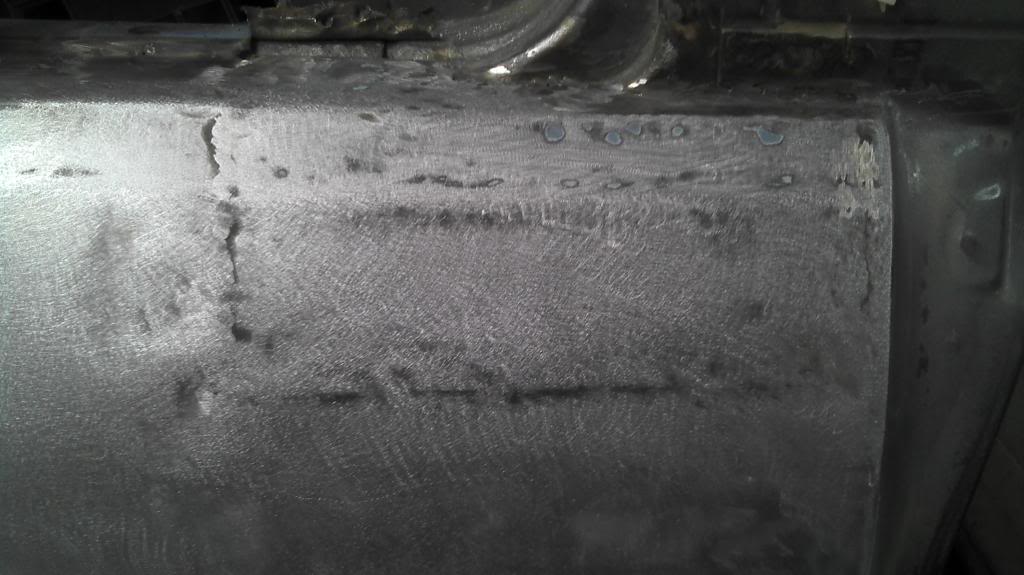

After welding , before grinding back

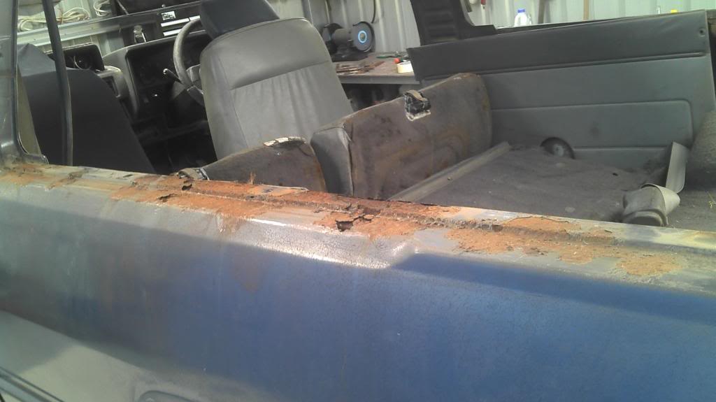

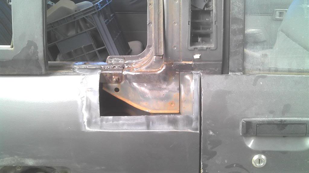

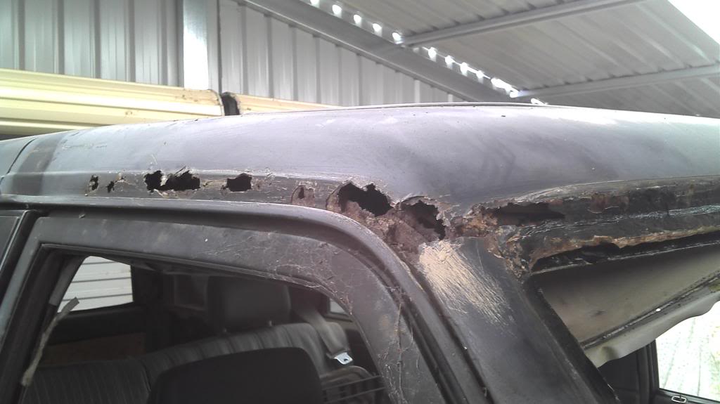

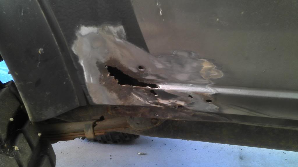

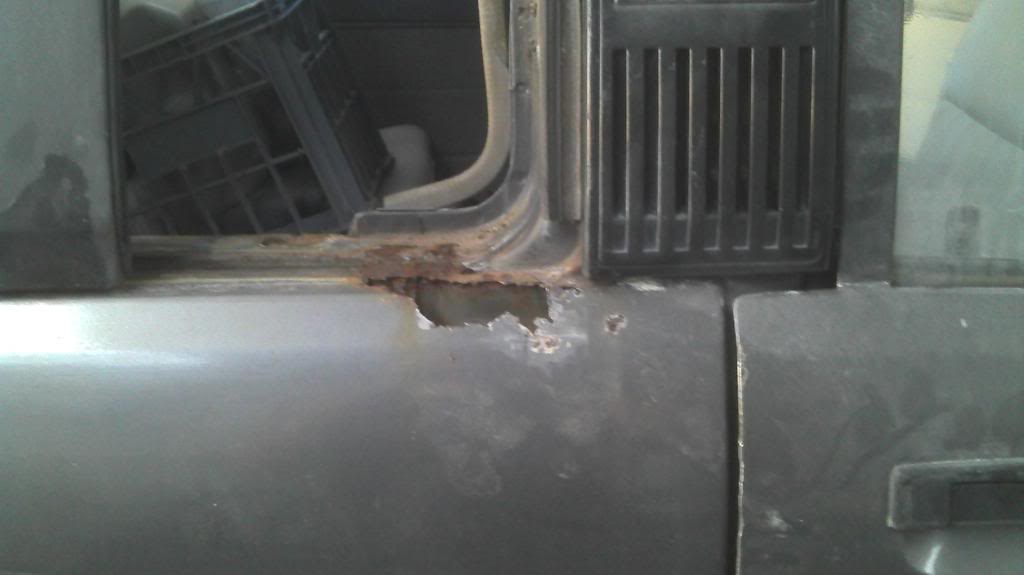

Here is the rust at the top of the rhr quarter
Only looked like a small section but had to keep cutting
I think this is the reason the lower quarter was so rusty , water was just flowing down
All cut out nice and rust free

Was worse than it looked

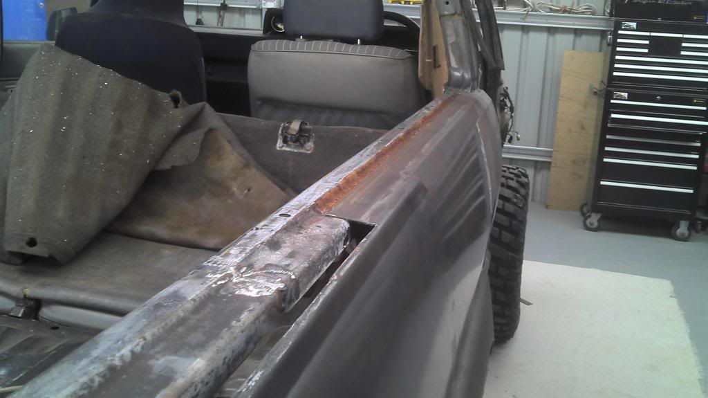

Was a bit tricky the get the angles right, on the repair panel but i got there
Ready for some bog to smooth it over and a coat of high-fill

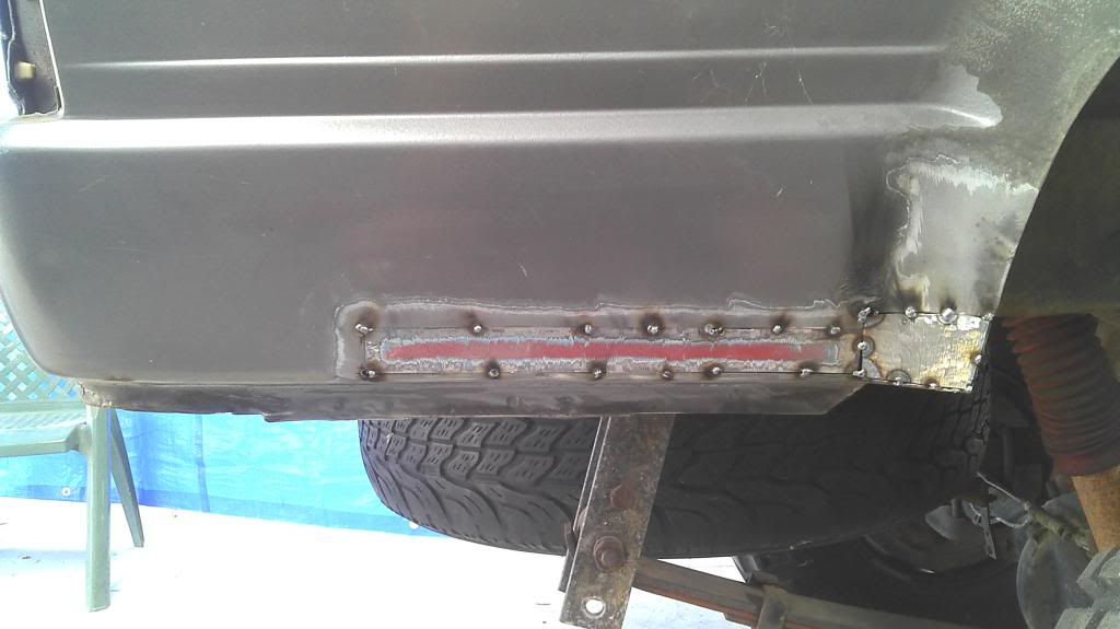

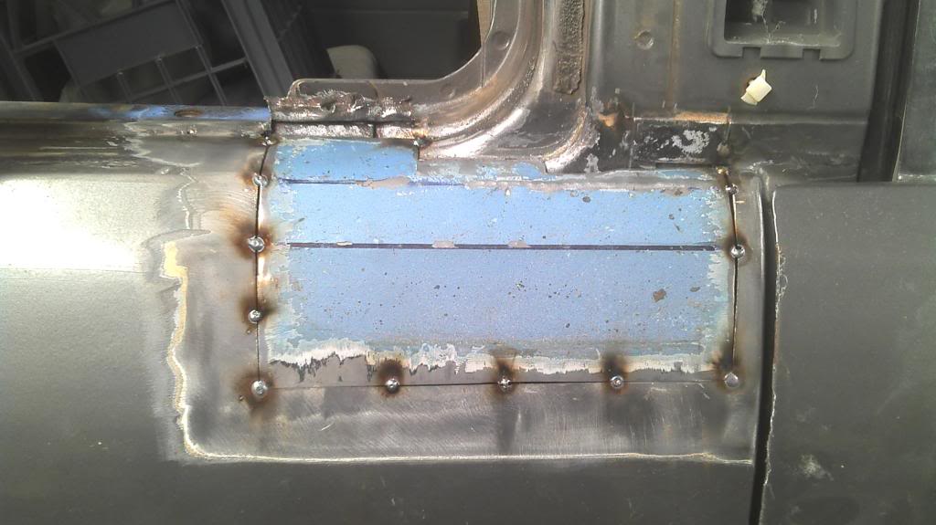

Just a small repair on the lower rear quarter , tacked in all ready to weld

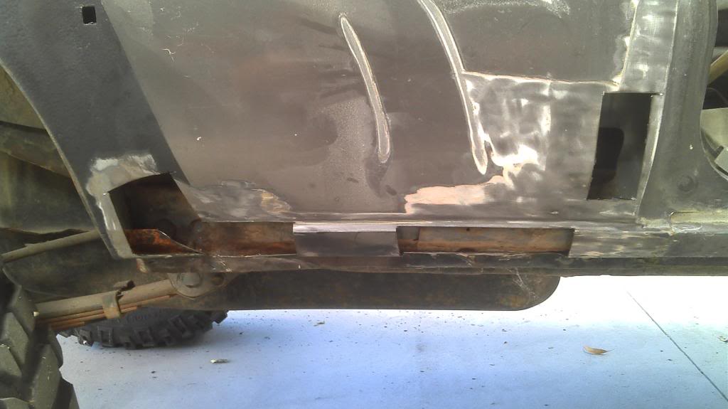

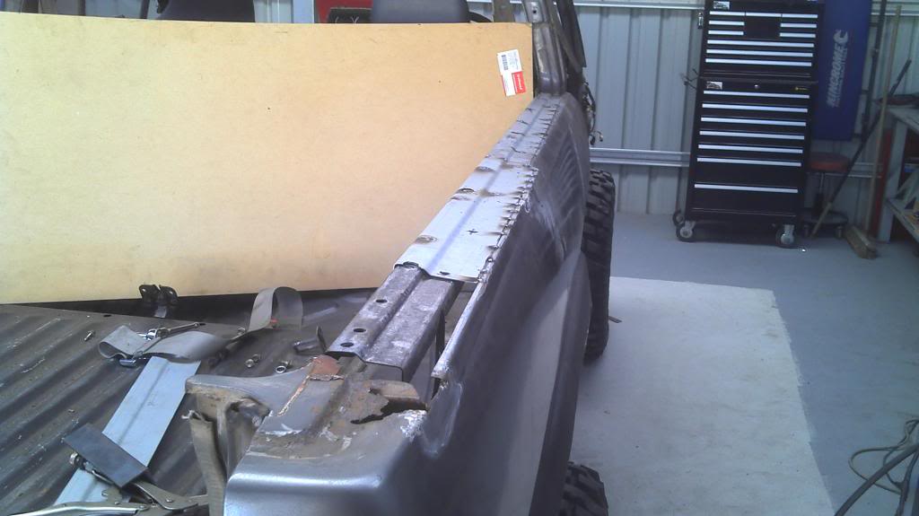

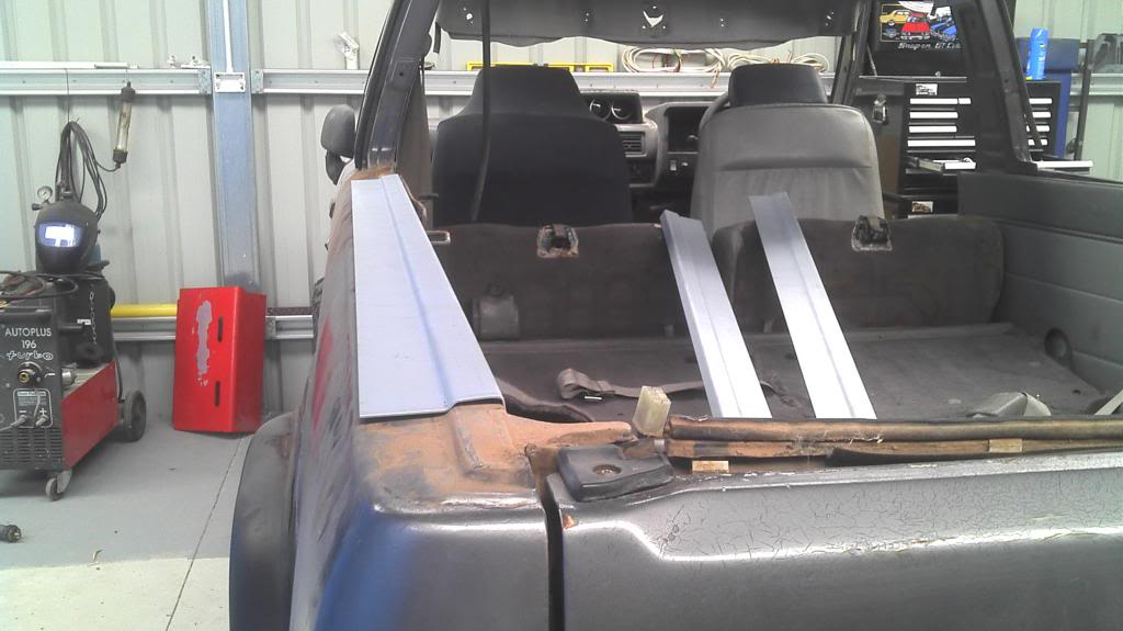

Ok guy time to tackle the big stuff

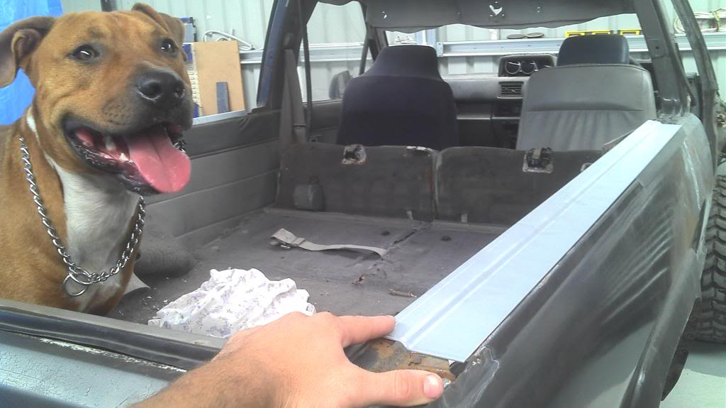

I cut out a section of rear quarter and dropped it of to a mate who is a sheet metal worker he bend up a new piece , he did an awsome job

Wow, your buddy did a good job on bending those patch panels, the contour looks like a perfect match! Man your really knocking out the body work, nice job!
