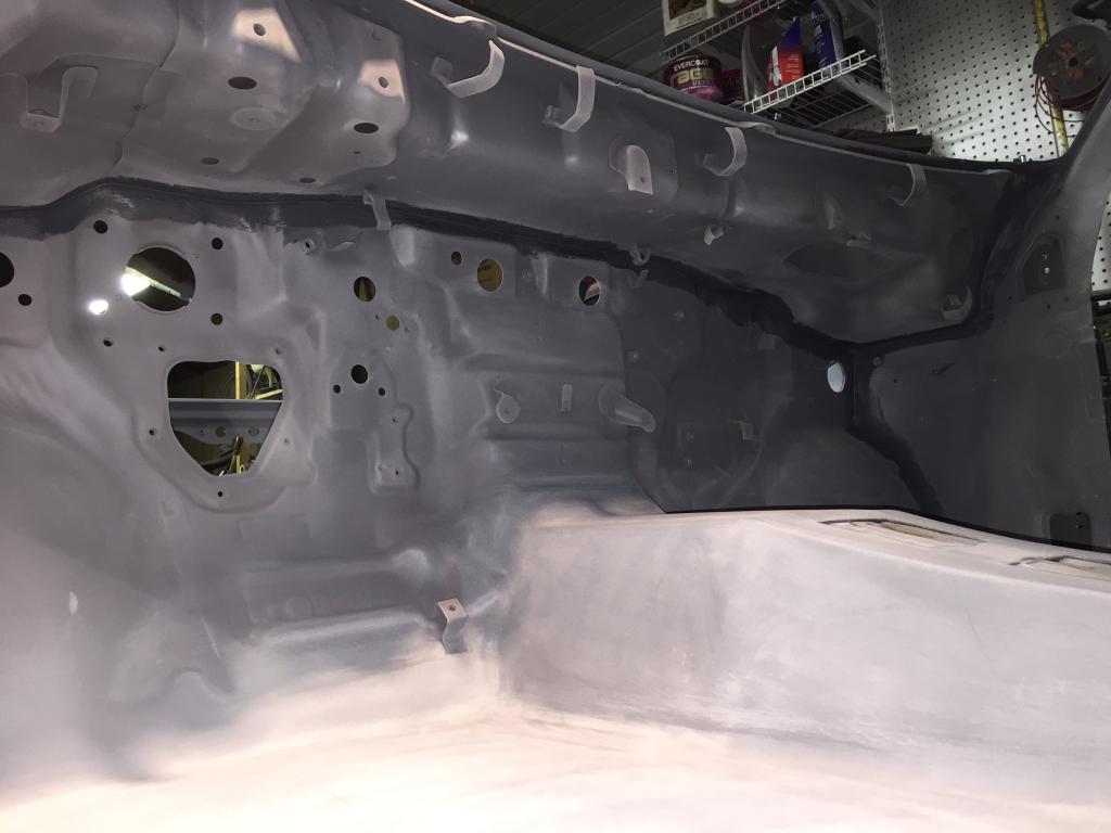

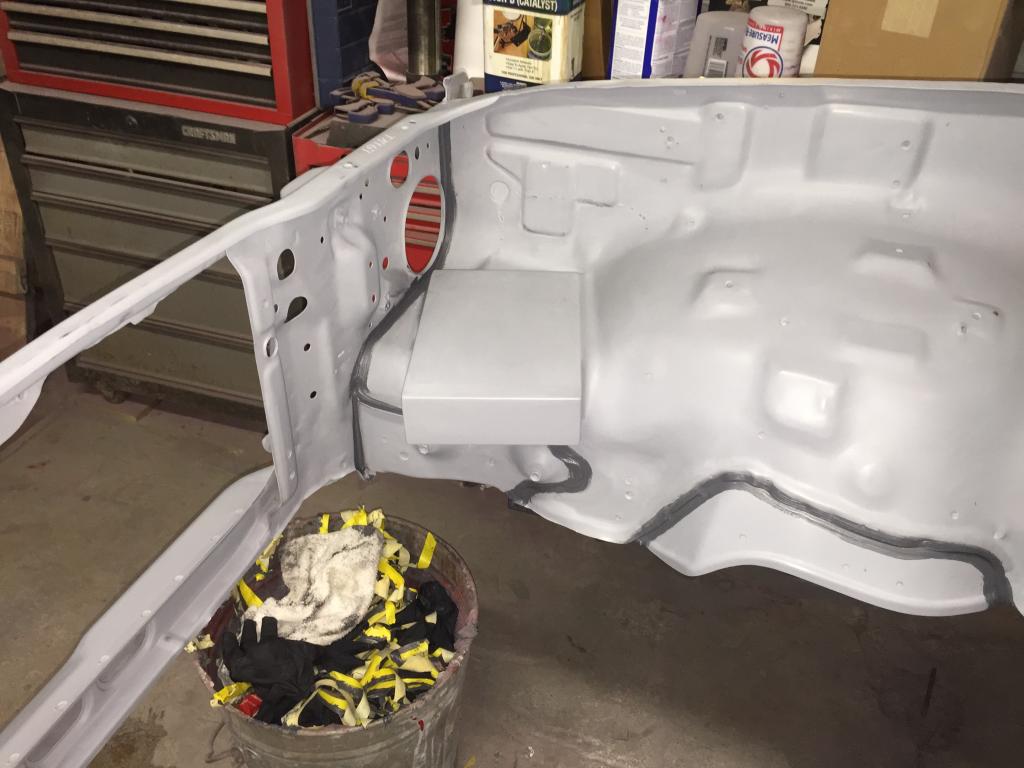

Late night of seam sealing last night. Got the engine compartment done and most of the floorpan done. I still need to hit the seam that runs up the kick panels and behind the top of the dash, the door sill/rocker panel rosette welds, and some touch ups here and there but that should go pretty quickly tonight assuming I catch a second wind - I'm tired as hell today...

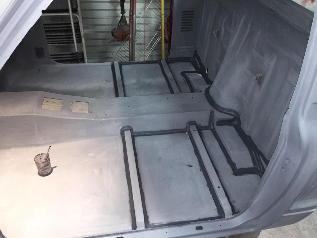

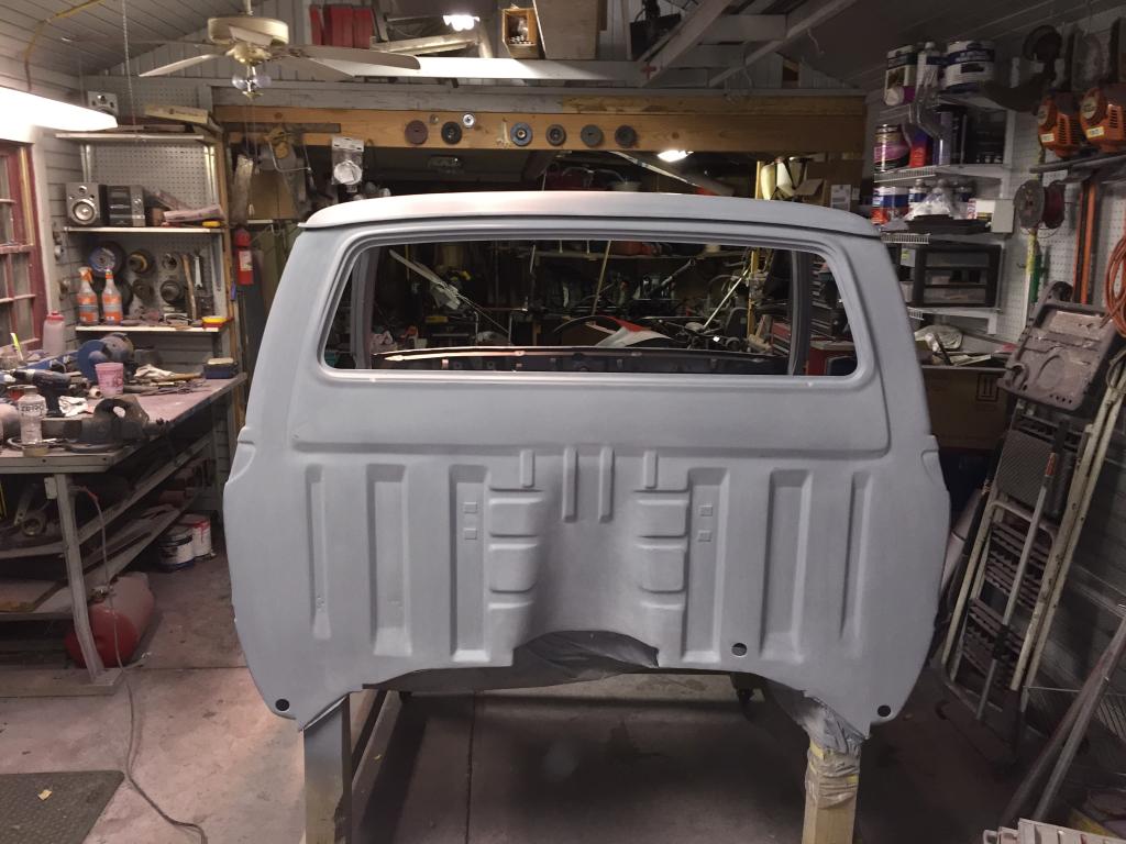

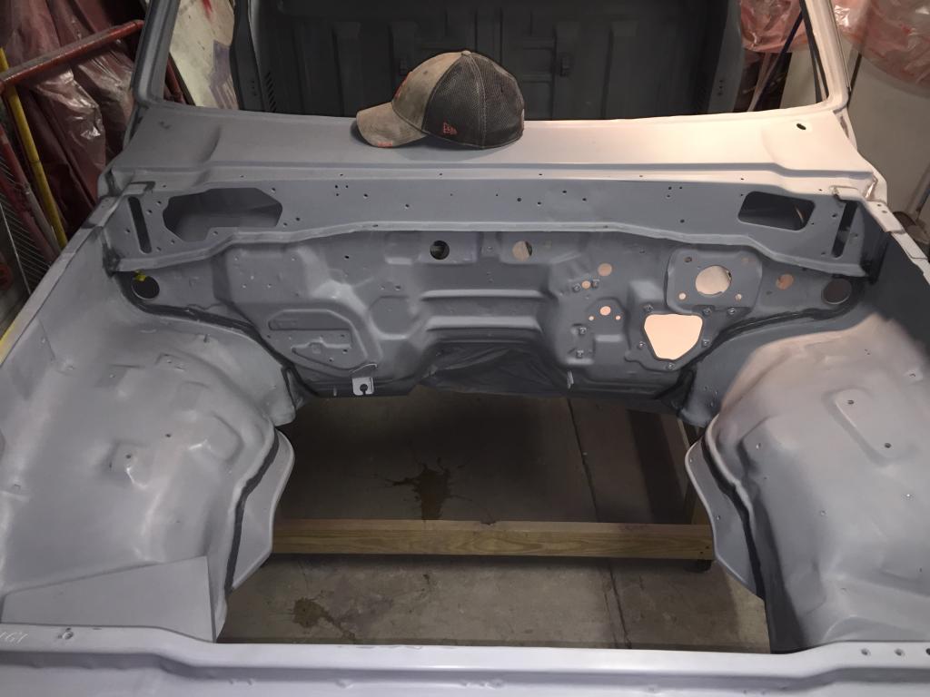

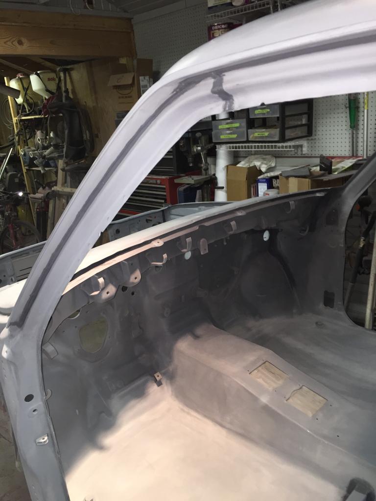

I finished all the prep for the cab tonight. All I need to do is roll it outside and blow it off real good with the air compressor. Last time I blew it off I still had a little bit of sand coming out of it from when I media blasted it!! This time I'm going to huff and puff and blow it with an air compressor until absolutely no sand is left in any crevice! Then degrease with some SEMsolve, tach cloth it and it's color time. I might be able to get it painted tomorrow but my friend is throwing his parents (kind of like my second set of parents) a surprise 40th anniversary party late tomorrow afternoon so I want to go to that and my wife isn't feeling well with the pregnancy so I will likely be kickin' it with my little homie all day tomorrow. Who knows, maybe I'll teach him how to sand and get him to help me with the surface prep on the bed... Anyway, pics:
Seam sealed up under the dash along the firewall (this is a VERY important seam, especially in the outside corners where rust tends to develop even under the factory seam sealer):

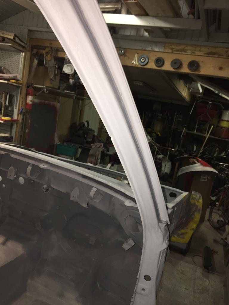

And below the drip rails (it's a lot smoother than it looks in the pictures):

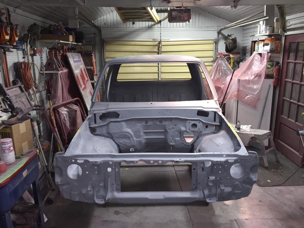

And not it's just sitting purdy waiting to color between the lines:
Hopefully that will be the last time you all every see it grey!

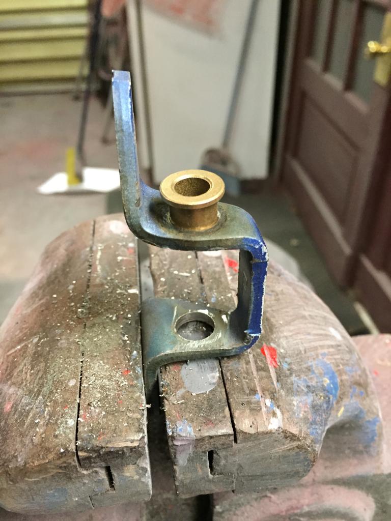

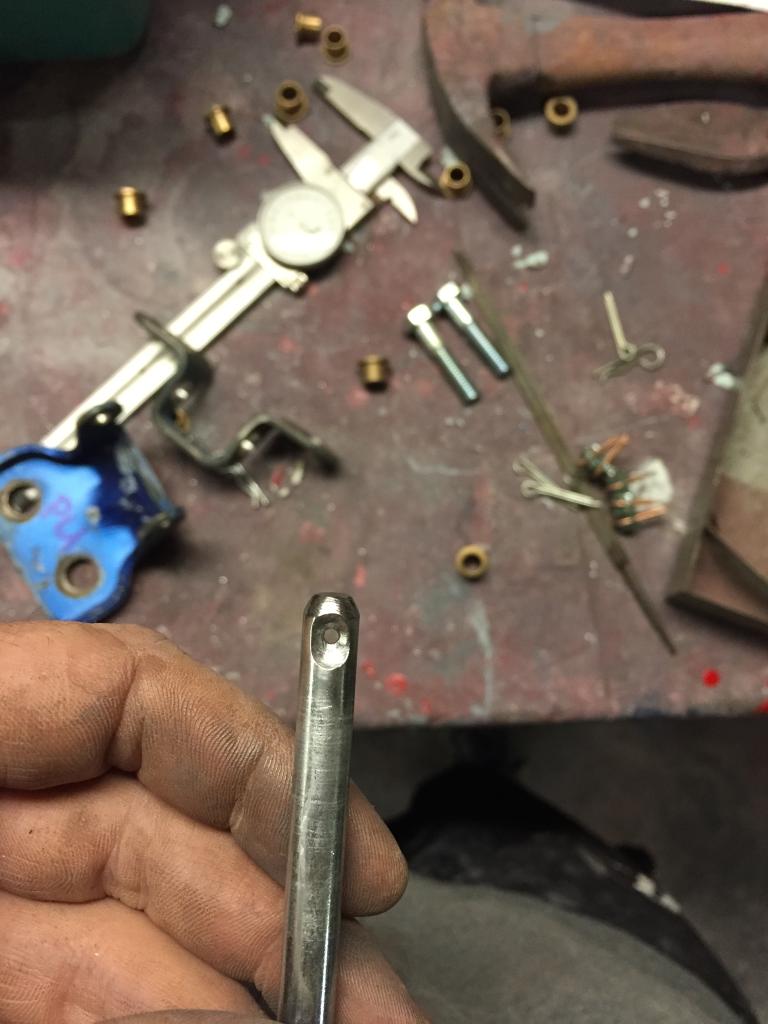

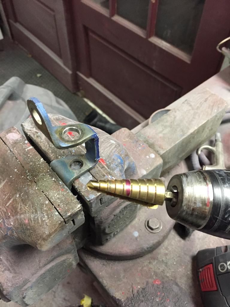

Also, I decided to tackle my door hinges tonight. I want to make my doors easily removable so that maybe I can decide to go doorless at some point, but I would unlikely ever get the notion to be a jeep tool like that... My plan is to eventually make a nice set of half doors to put on during the summer just because. No, I don't need them for rock crawling - you guys should know me better than that! I just think they look cool and would be nice to have when cruising down to the beach. Obviously, when I build some half doors it won't be some quick hack job. I'll build them to match the quality of the rest of my truck. Anyhow, here are the quick release hinges:
I cut and punched out the old pins to separate the hinges and marked them all so that I match them up properly when I reassemble them. Then I had to drill out the door mount side to 7/16" so the the new bushings will press in:

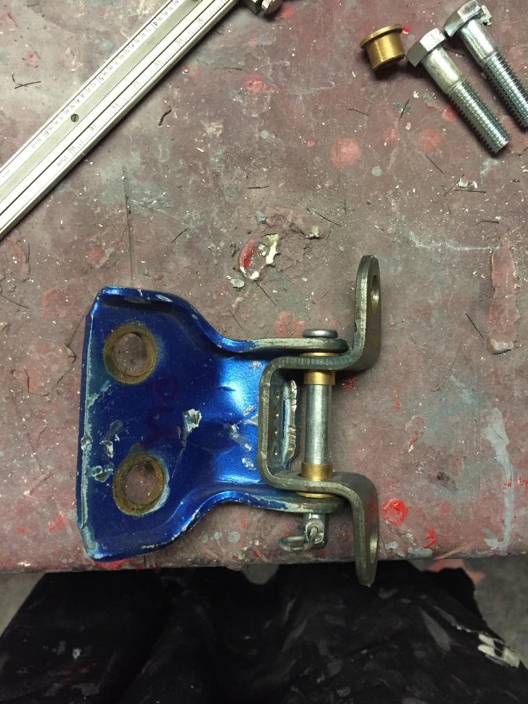

Here's the new bushing. I want to powder coat my hinges so I'm not pressing them in yet plus the company that I ordered the bushings from sent me half of them in the wrong size. The bushings I'm using are 5/16" ID, 7/16" OD, 3/8" OAL, 1/2" flange diameter, 1/16" flange thinckness. I got them from nationbronze.com for $2 each.

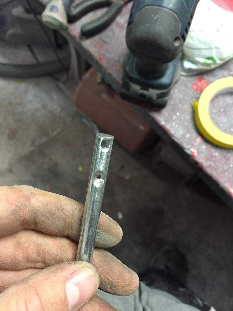

I'm using a 5/16" clevis pin but the hardware store didn't have the length I wanted so I got longer ones, drilled a new hole for the retaining pin, cut it to the proper length and beveled the edges for easy insertion:
And here is pretty much what it is going to look like. I mocked it up with the smalled OD bushings that they sent me in error:
Everything fits nice a snug so there shouldn't be any slop in the door. Now when I get my half doors built I can just do the same thing to the door side of another set of hinges and easily swap them on and off. Now who wants to donate a nice set of doors to my cause??

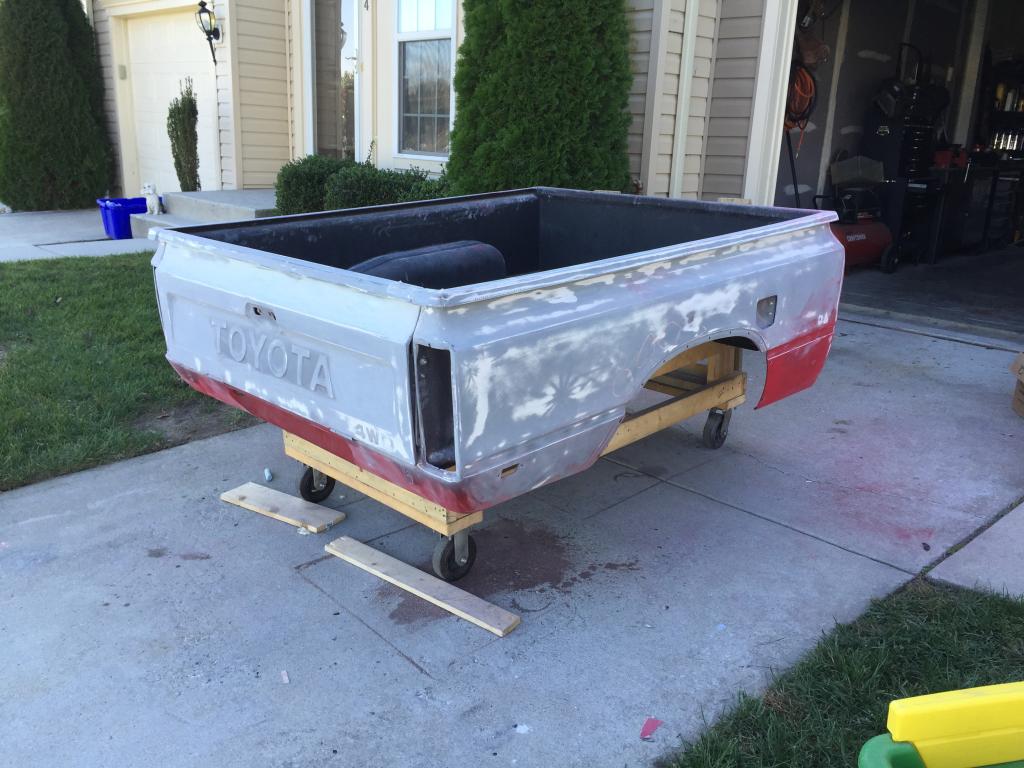

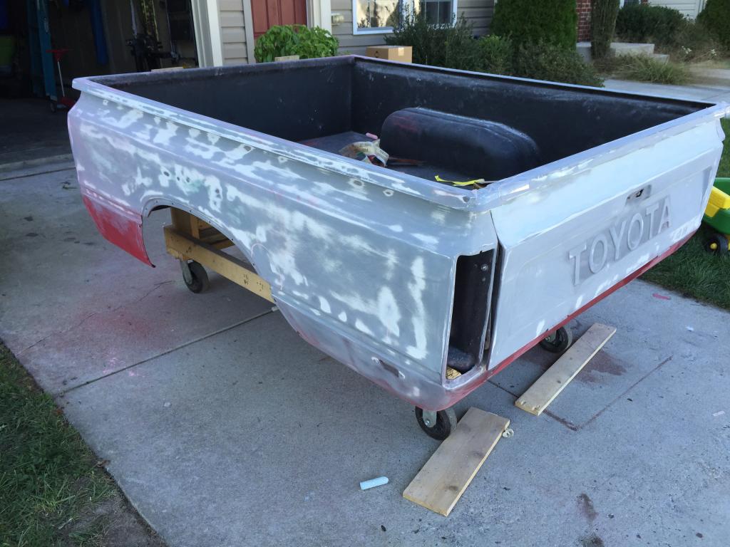

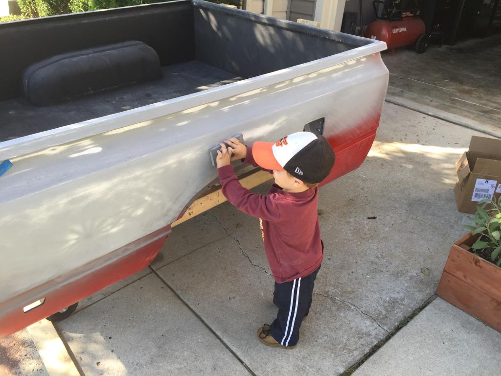

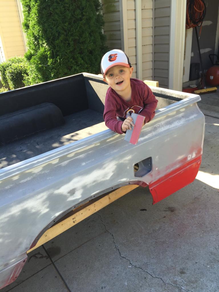

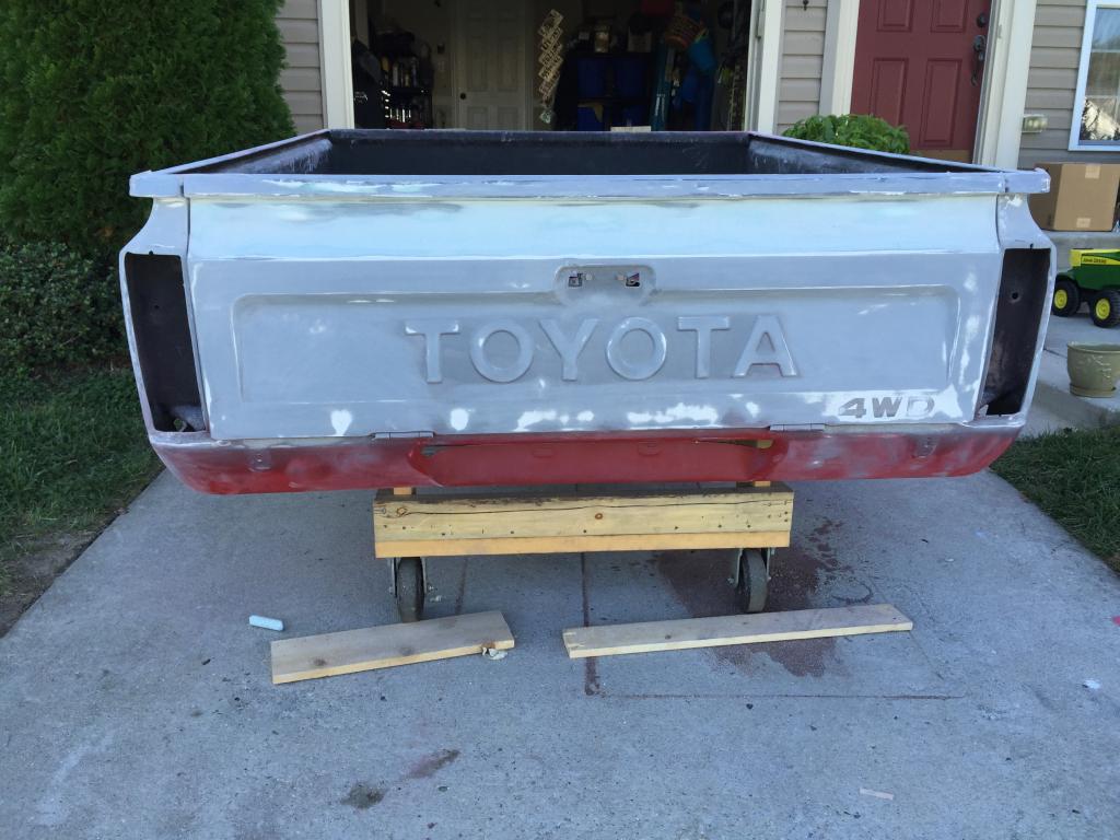

While I wait for the paint to flash in between coats on my cab I figured I'd post an interim update. Yesterday I got the bed blocked down real good to see if there were any areas that I needed to address before surfacer. Just a couple spots need to be swiped with a dap of filler near the contours of the fender wells and it'll be good to go. Like I said before, perfect surface on the bed for most, but I need to take it a step further.
Here's so pics of my boy helping me out yesterday:
Notice no sandpaper on the block..,
and then he managed to get a hold of one with sandpaper...
And the results:
Like I said, a bit of filler and then surfacer and it won't be too long before the bed is painted too... Now back to shooting the cab!

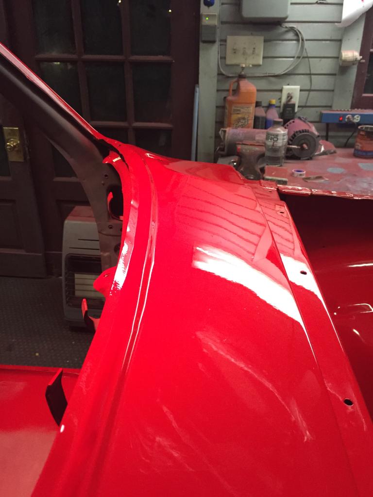

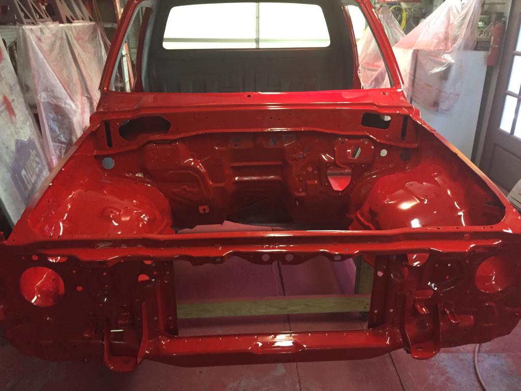

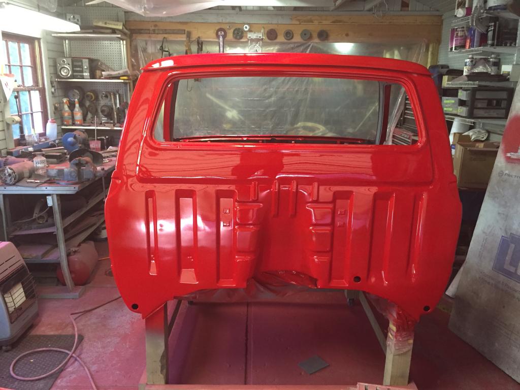

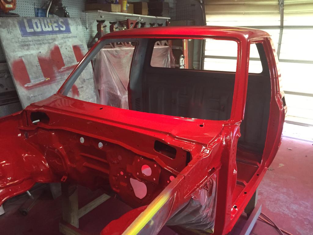

Cab is painted! I couldn't be more pleased with how the smoothie cowl and shaved rear cab seams turned out - definitely adds a nice touch to the over all look of the truck. Paint went down well and flowed out nice despite not having the proper activator for the temperature today. I have very minimal orange peal to sand out and two paint sags to fix. Both sags are in identical places on both sides of the cab behind the doors towards the top of the rear pillars. They aren't super bad so hopefully I can get them out with some 1500 grit and avoid using a nib file, but I want to talk to a painter first to get some sound advice. Here are the results:
I was worried about the paint laying down even in the engine compartment so I ordered some Satin Black ceramic urethane paint last week but it went down pretty good. Not sure if I should scuff it and shoot the black like I had planned or leave it red. Most restoration guys typically use a black under the hood and the ceramic paint is more resistent to heat and chemicals plus my engine is accented in a red that could possibly clash with the body red. What do you folks think I should do? Red or Satin Black under the hood?
