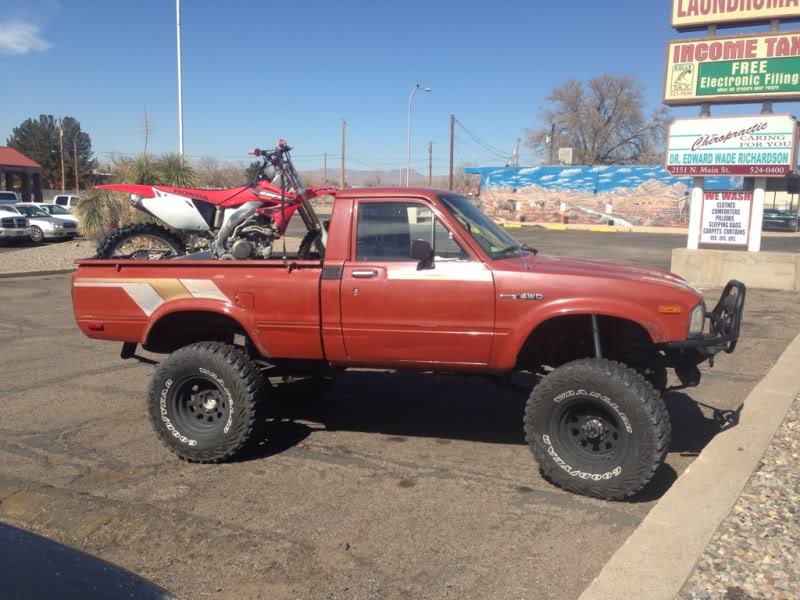

Old Apr 20, 2013 | 06:31 PM
  #363
JustDSM's Avatar
Joined: Dec 2006
Posts: 383
From: Las Cruces, NM
It sure does. Tailgate up too! I use my "oil change ramps" to lift the front end up to lower the tail gate. The darn truck is just too high push the bike up the ramp.. LOL

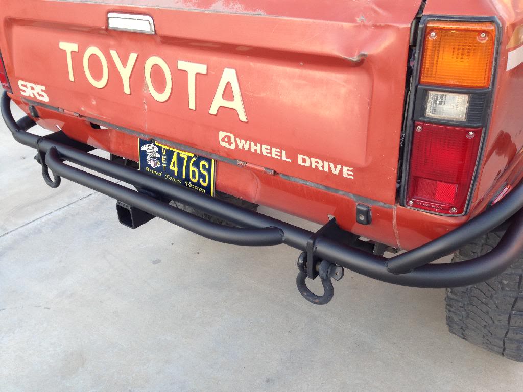

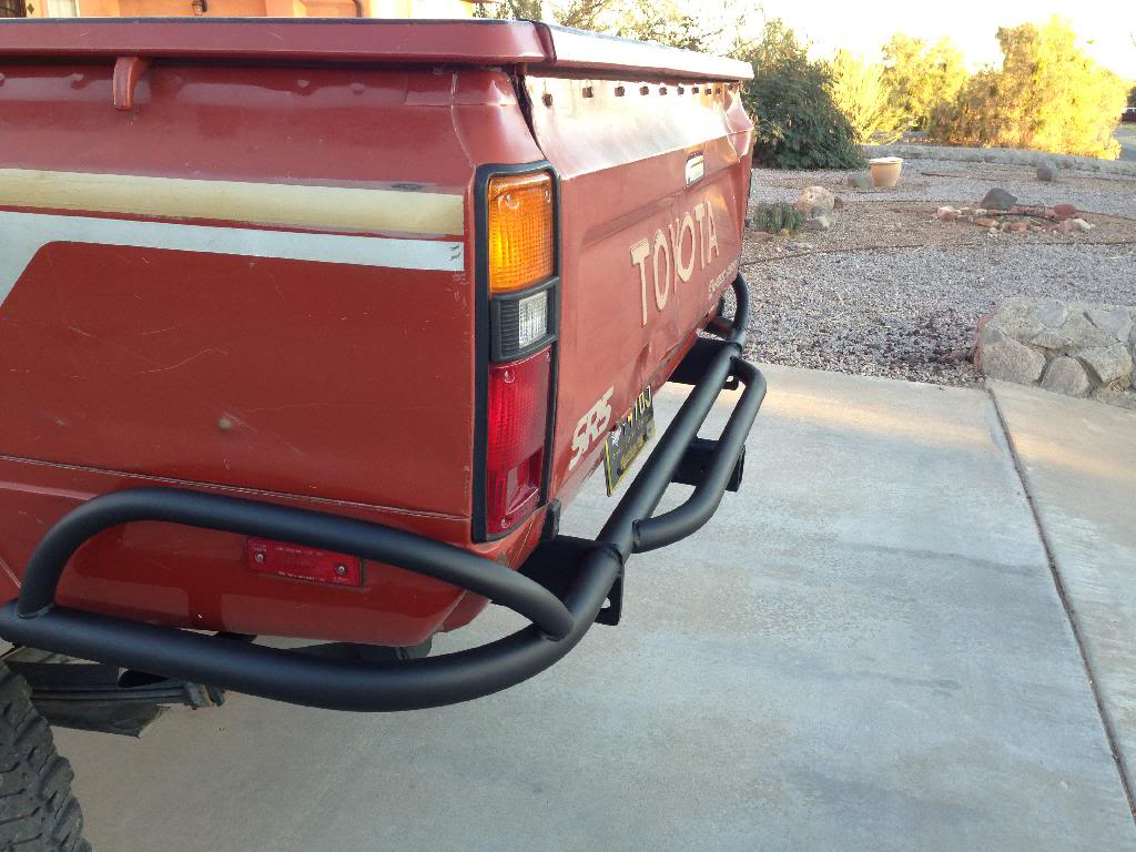

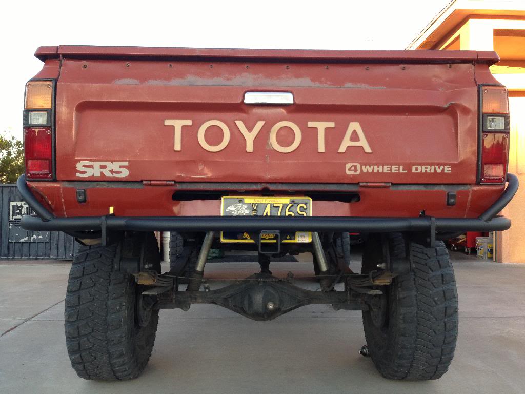

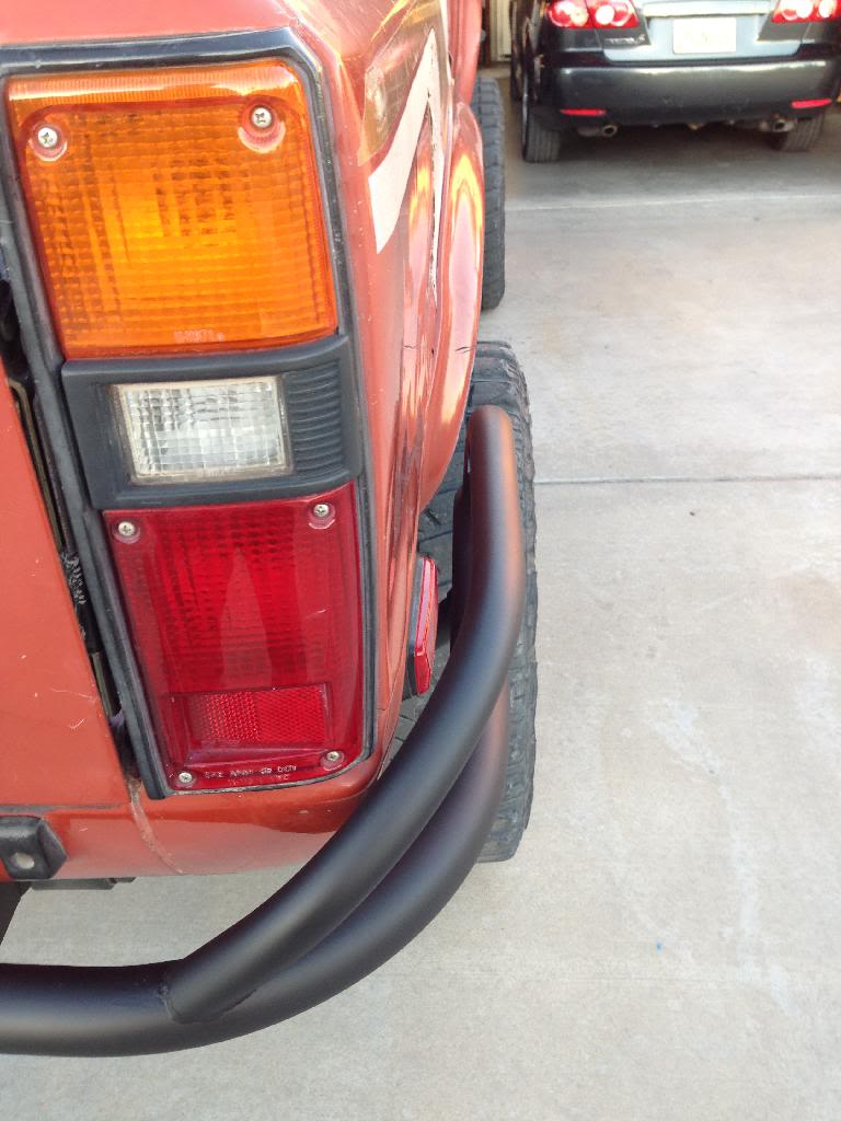

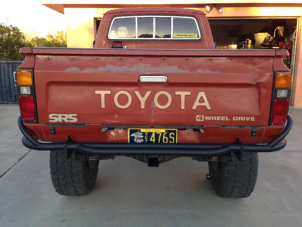

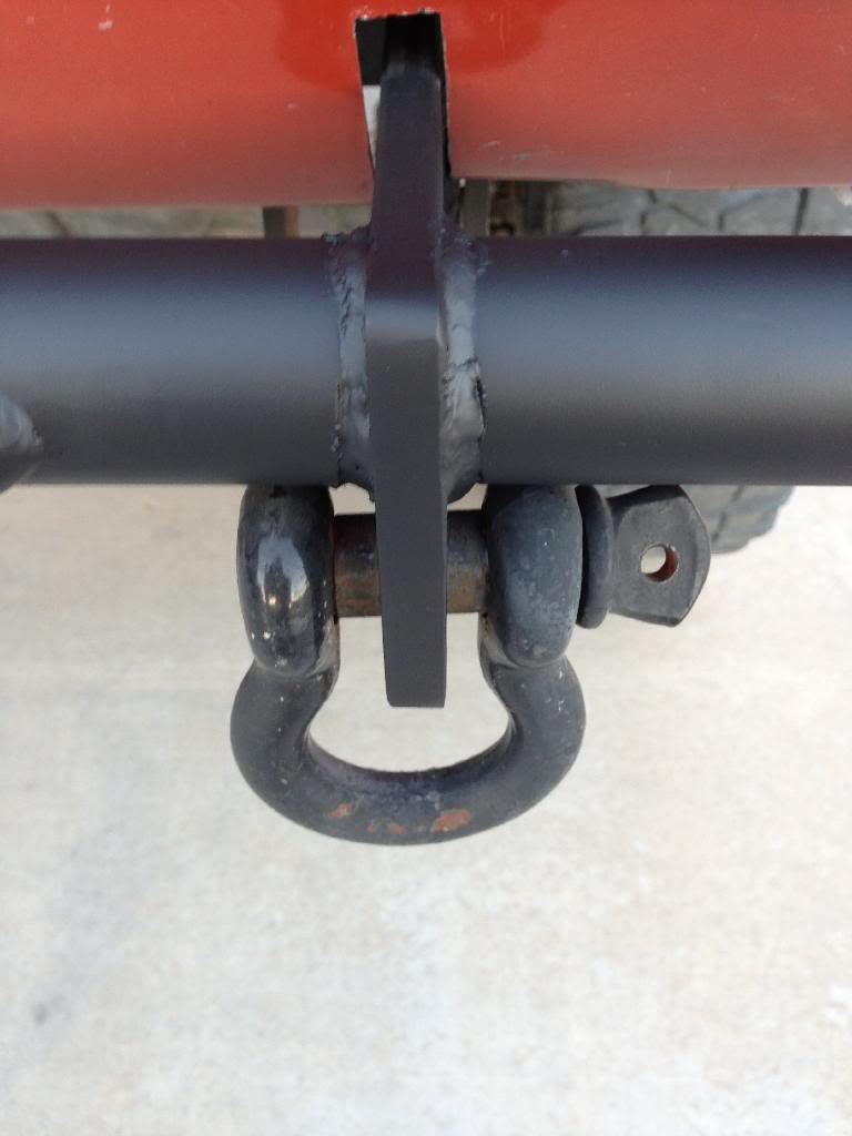

Thank you as well! I do have a little bit of update. I've got a new rear bumper fabricated. I've got some smaller tweaks coming that are more or less just refining things further on the truck. I know I've said it 100 times already but I'm just happy how civilized this thing is and dependable it is. I'm heading to LA (12 hour drive tomorrow night) for a little Thanksgiving fun at Disney with some friends. I don't know too many people who road trip in a 1st Gen LOL!
But the planned updates are to:

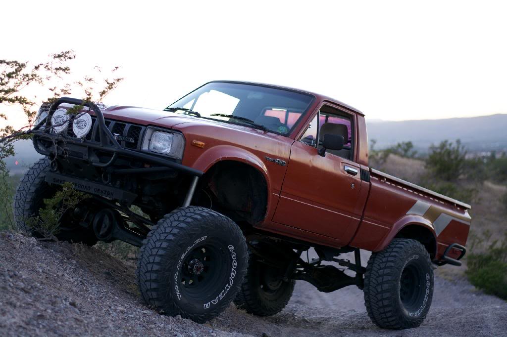

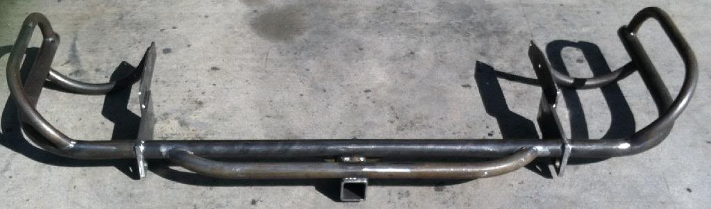

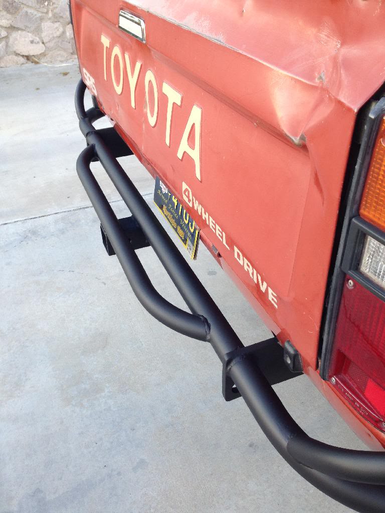

My new rear bumper:

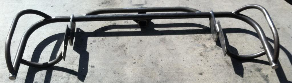

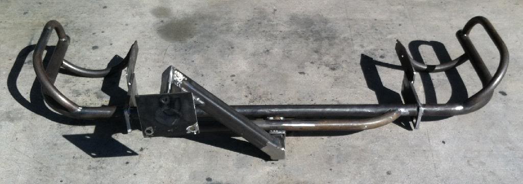

This shows the spare tire carrier. This design wasn't what I was looking for, So I'm re-making it to be a little more vertical so the drivers side rear tail light isn't as obscured.

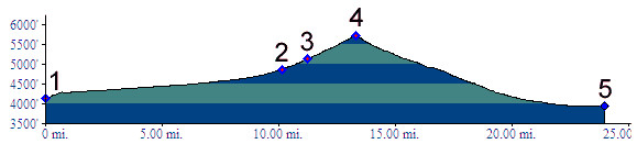

The the 3RZ is worlds better on hills (and every where else really).
Thats a elevation profile of the pass. It's about a 6.5% grade at relatively high elevation and I drop to 4th and I have no problems going 70-75 over it unless there's a STRONG headwind (I wasn't joking about 30-40mph in the previous post!). My 22R would be floored in 3rd gear and struggle to maintain 50-55mph even in perfect conditions.

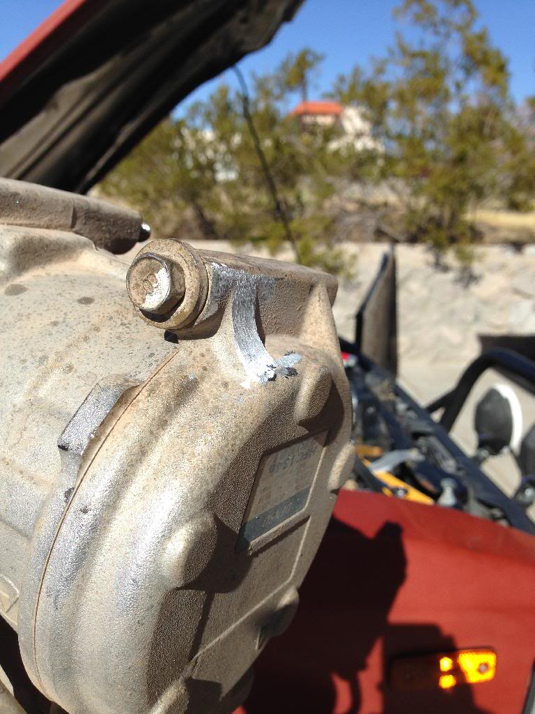

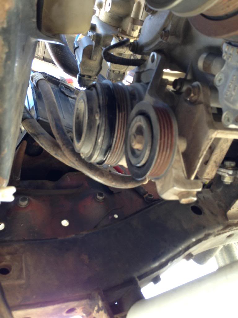

So I'm finally getting back into turning some wrenches on the truck! Took me about a year and a half or so of just driving it to get back into the swing of wanting to tweak on this thing thing!
Got the front springs pulled apart, wiped the grit/grime/rust off them, and thought they might just function a bit better with some lube so I used some motorcycle chain grease I have for my dirt bike. This stuff does well staying put so it seemed like a good candidate. Got the springs back together and man what a difference! The front end is a little more lively, I'd say I picked up an extra inch or so of flex since the springs have much less internal friction to overcome. I'm quite pleased with the chore I took on!

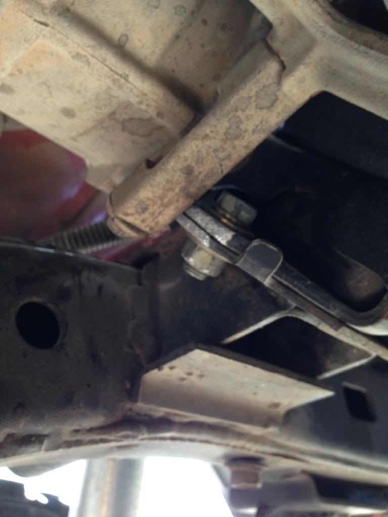

Replaced the transmission mount that was long over due! Dropped the transfer case and clearances the transmission tunnel a bit since the W56 has always liked to "tap" the tunnel when torqued up. I should have went another 1/16" or so as it still lightly taps when really torquing things up. Not hardly annoying enough to warrant pulling the T-Case again however! What a difference in drivability though. Holy Cow! Big improvement. When I installed it, I "preloaded" it somewhat so it's probably slightly stiffer than stock and I can feel the vibration when the idle drops really low (remember I don't have any balance shafts in my 3RZ). But beyond that the improvements in drivability and shifting FAR outweigh the additional vibration at idle.

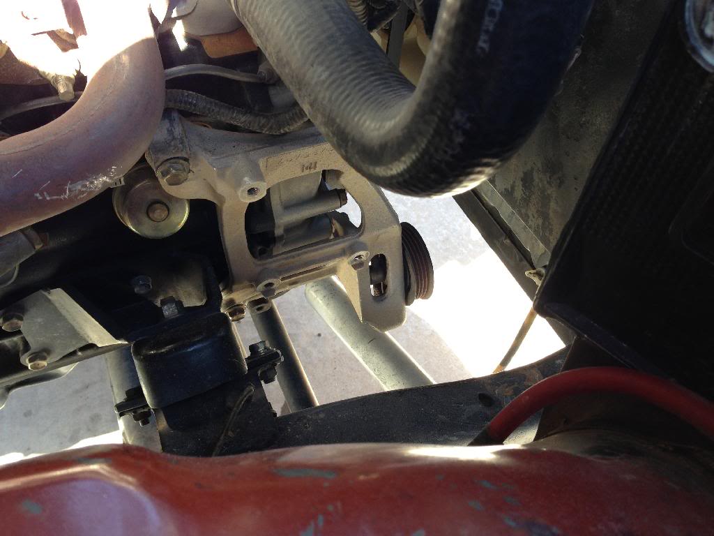

This afternoon I got busy putting the stock 3RZ A/C Compressor in the truck to function as an OBA setup. Pretty smooth/simple installation for the compressor portion. A little clearance work was needed on the motor mount and compressor. Not much, and nothing my die grinder didn't make quick work of.
Got started with the A/C Compressor bracket.
The required clearance work on the compressor and motor mount.

Now that the "heart" of the system is in place I've got a small shopping list of things to get this thing pumping out some air. The system will run off a master switch in the dash, and feed power to a hobbs switch that will turn the compressor on if the tank is below 90psi and shut things down once it reaches 120psi. I'll be using a 5 gallon aluminum DOT approved tank mounted under the bed for running tools and other goodies.
I've also decided to plumb in a heat exchanger and do a hot water shower setup as well.. Stay tuned!
