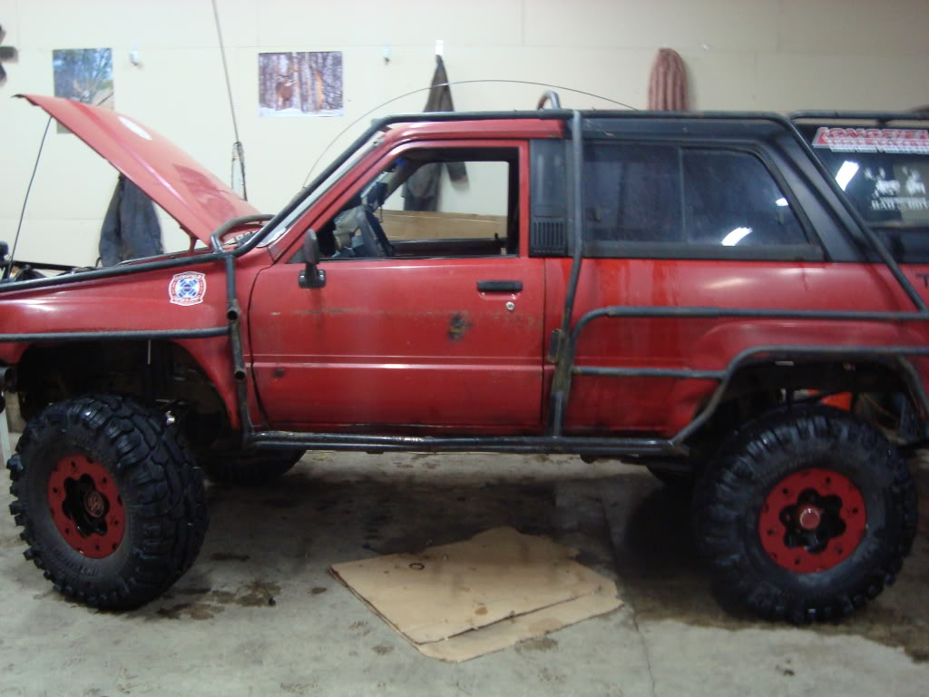

alright yall i need some help from anybody with weld on rock rings.
i need my tires balanced but i was told by the shop in town that they cannot balance my tires once i have rock rings welded onto the bead of the rim.
have any of yall with rock rings been able to have your tires balanced by a shop?
the things on the rims are rock rings

What the heck is that cage made out of?
