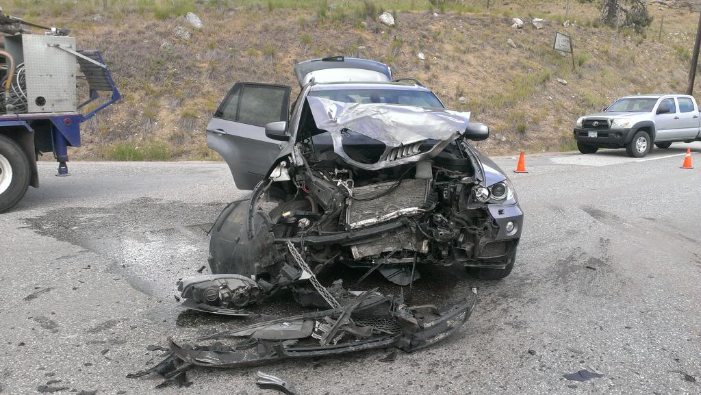

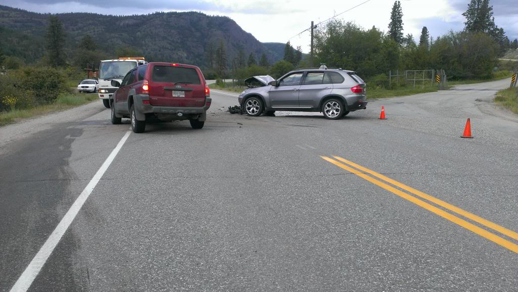

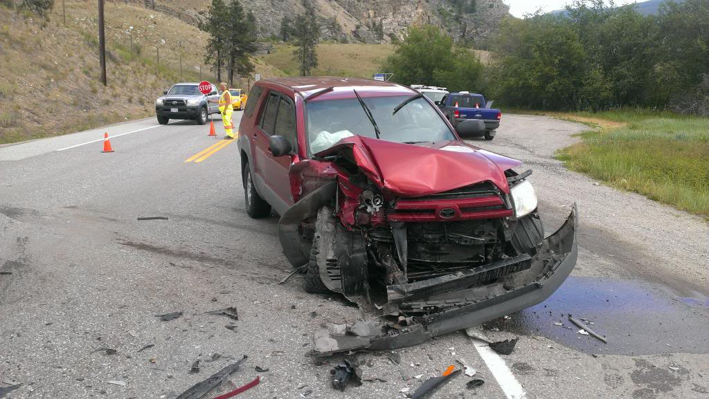

Well... I got a little help in Deciding what to do and even got some time off to do it in. The 4runner is no longer able to get a 5 speed swap. Sorry to any that were looking forward to this. Colossus got written off in a highway accident where someone pulled out on me while I was traveling home from work. I am very glad colossus was such a safe vehicle. Pictures below.. memorial was beautiful... now to find one with all the stuff already done to it to replace it with.
Here is Colossus as he sits now
The other vehicle
and the scene
Everyone is ok, I got minor injuries. I should be getting a settlement and a replacement check for the vehicle. I gotta work out with the ex how much she is taking and hopefully I can sell my supra to pay off the difference. I am thinking about going to a 2005 and up Tacoma since I need a truck as a welder.

OUCH! Looking at the two damaged vehicles how the heck did you two hit?

Sorry for the delay.. not on the computer much while I am trying to heal up. If you look in the picture that shows both vehicles there is a side road that is at an angle to the highway. He was on that road. .pulled up to the stopsign and tried to cross my lane to go the opposite direction that I was traveling.
