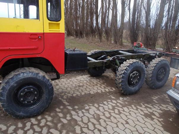

It is that one, however it is not as big as you might think. Right now it sits as a chassis with engine and all drivegear and the cab on.
Adding me (96kgs) and a half tank (40 liters of petrol) it weighs 2,180 kgs.
We plan on a 3.5 ton total weight.
This is what it look like now:

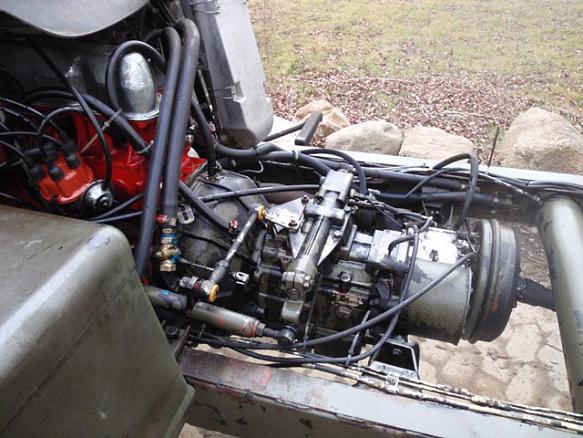

Jep! The shifter is behind the cab. This is the original Volvo gearbox in place:

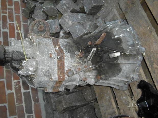

I've found a pic from a scrapyard here showing a dyna gearbox (bad img. quality though):
The shifter seems cable operated, Perfect for us!!!

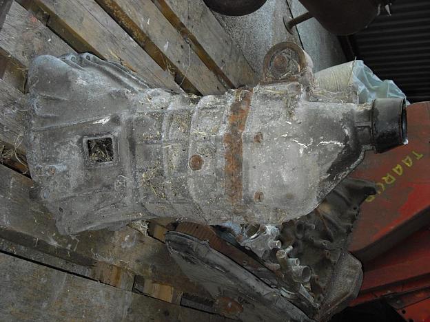

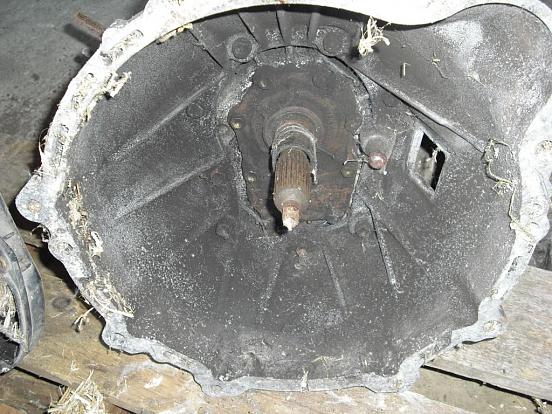

Hey JD, this one might be for you. I got a lead on a Dyna gearbox, but I'm not sure wether its the right one, Its dirt-cheap, less than 100$, but the guy who has it does'nt know where it's from other than it sat behind a 2LT and he thought it was from the late 80's
He sent me some pics though:
As far as I can see the house is aluminium, and the R452 is cast steel right?

Yep all the R452's I have seen have cast casings and I was only looking at one last Saturday
Maybe ask him if he will remove the rear section and count the OD gear teeth as you never know.
JD
Old May 18, 2009 | 07:56 AM
ChristianJS's Avatar
Posts: 20
I thought so... I'm almost considering having one shipped from Australia...
