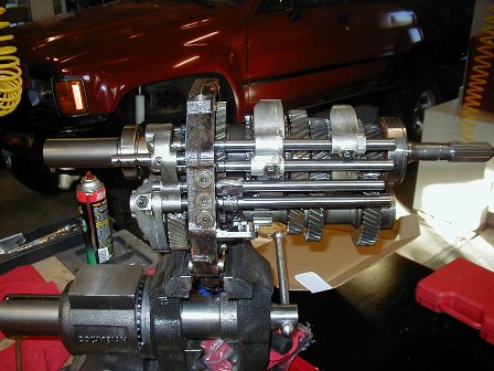

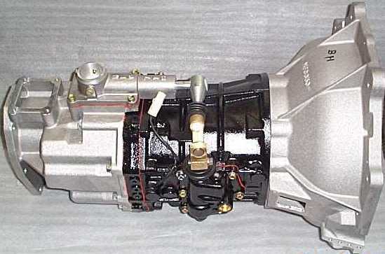

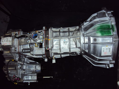

But today i got a new idea; could I make a R451/2 - R151f hybrid?
The idea is to use the part of the Dyna housing with the shift, and part of the Cruiserbox which attaches to the transfer
To make the idea more easy to follow, i found a couple of pics.
the R151f with the cruiser splitcase transfer:
the R151f without housing:
the R452 Marks uses:
As far as I can see it should be possible to take the front housing from the R452 Dyna housing - with the shifter mechanism - and attach that to one side of the middle plate, and use the R151f on the other side, but before I spend close to a 1,000 AUD I would like some second opinion, perhaps even from some-one who has actual experience in gearboxes, unlike myself! :-)

Any takers on the gearbox issue? I have never really taken a gearbox apart, so I'm a bit in the dark here...
(I will post pics, when I get time to hook the camera up)

You might try contacting Marlin Crawler on your gearbox questions...

REALLY interested in seeing that SICK sucker come together! Not much of a trans knowledge base... but I'm glad you're taking extra care to be SURE as you plan to head out into the middle of nowhere, correct? lol.
Pics of the thing? I'll look back, just saw a couple thumbnails.
Best wishes, Christian!
Old Aug 15, 2011 | 12:22 AM
  #38
ChefYota4x4's Avatar
iTrader: (5)
Posts: 19,281
Likes: 20
From: Lake Havasu, AZ
Ok, saw it.... LOVE IT! lol. Can't wait to see this thing all ready for a "trail kill'n expedition"!
