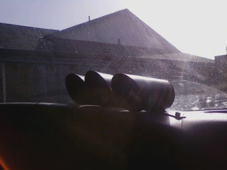

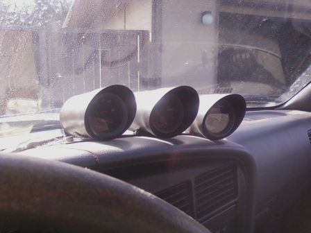

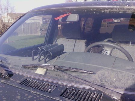

this is what i did, im using sun pro gages,it workes very well for me and dose not get in the way of driving.
Attached Thumbnails locating gauges post-swap-gage1.0.jpg   locating gauges post-swap-gage-2.0.jpg   locating gauges post-swap-gage-3.0.jpg
