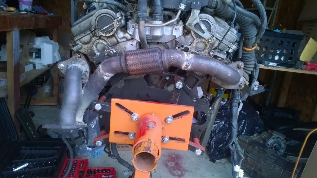

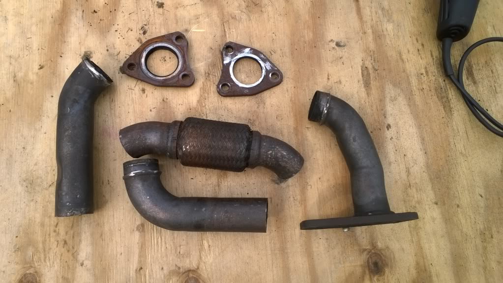

i did the thing

Nice. Looks about ready to go in.
I just saw you're using energy suspension mounts. Poly I'm assuming. I'm curious to see how much vibration you get with those. What was your specific line of reasoning for those.

Originally Posted by irab88
i did the thing
See. That wasn't so hard.

yeah, but my welding sucks. flux core is convenient, but messy.

Ya, so is mine. Only reason I use it cause it is cheaper right now than buying gas. Flux core sucks on thin exhaust pipe.

Now wrap it with some high temp exhaust wrap.

Question- how far do normal crossover pipes go behind the heads? I should have asked before I welded it all up.

Header wrap is crap.
Put the original heat shield back on. If not, you better put some heat blanket on the firewall before you stuff the motor.
You want the pipe as close as you can. Just make sure you have the clearance for the bellhousing.

the pipe is close to the bellhousing, but it clears.
