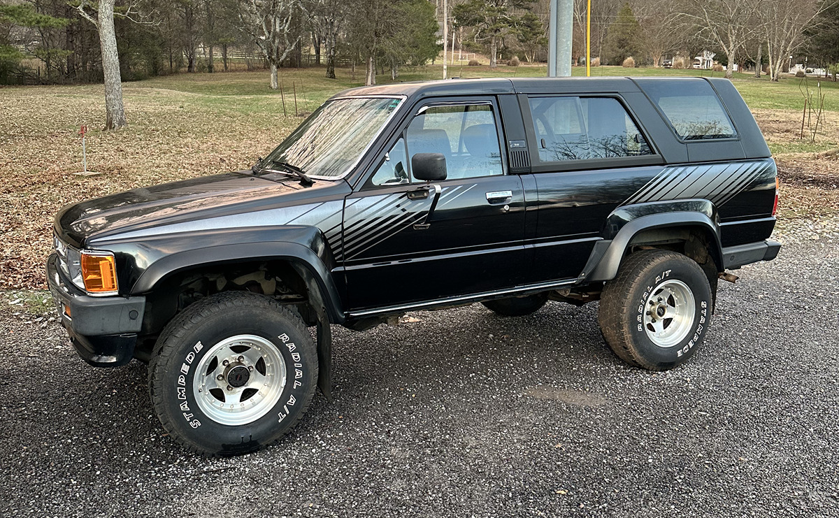

Well I haven't made any progress on the motor situation, but I did get it out of the barn and washed for the first time in 15 years

Gorgous car!

That's a nice truck and definitely worth fixing up. If it was me and it WAS running before, I'd try to get it running before I jumped into a swap. Getting the fuel system cleaned up would have to be done either way so it wouldn't be wasted time or money for that stuff. A running truck would give you time to plan your swap and gather what you need. Good luck.
