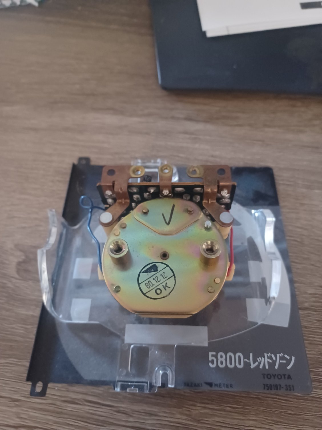

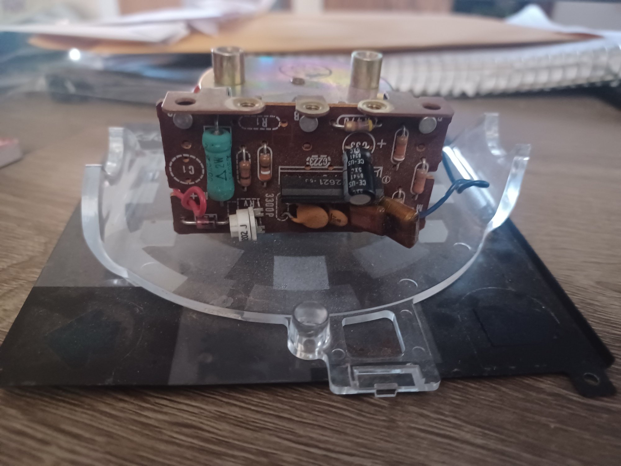

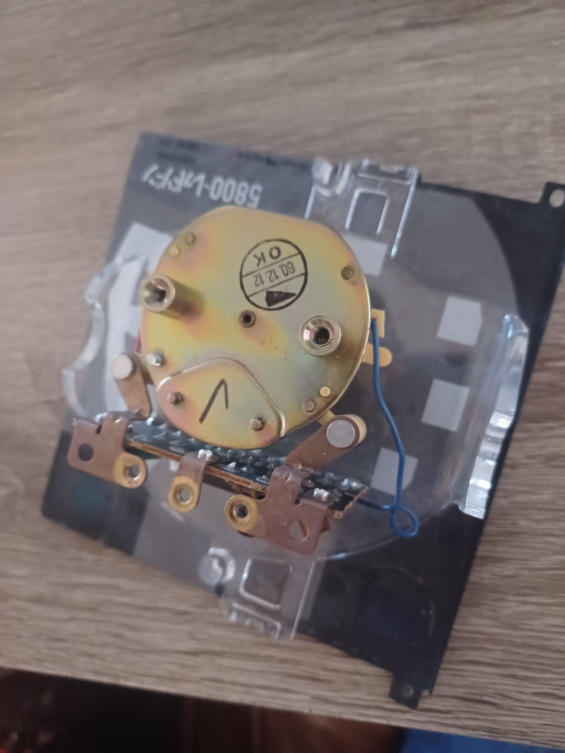

Hello, I have been searching around for the proper area to solder on the resistor on this tach, but I can't seem to find the same design as mine. The closest I saw in my searches was for a 22RTE.
My drivetrain donor was a 1996 T100 4x4 MT and the truck it went into is an 84 22R 4Runner. The tach I believe is out of an 86 4Runner, I got it a while ago off eBay. It worked with the 22R, but now I can't get it to read at all, as expected, and am not sure where to solder in the resistor.
Thanks for any input.
-Tony

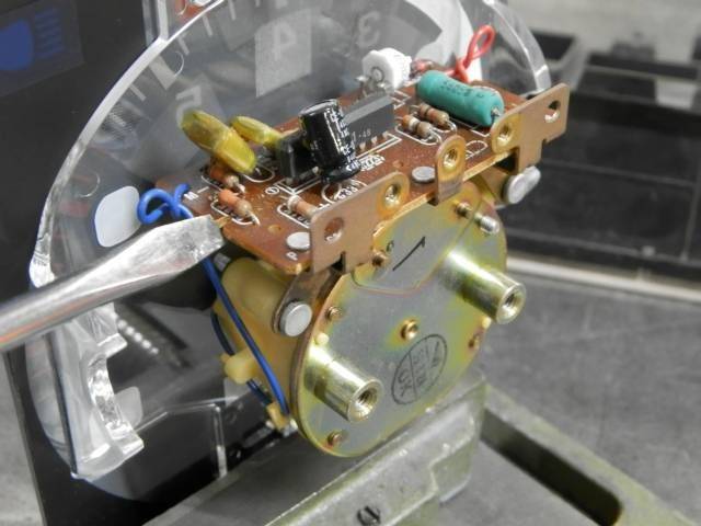

When researching my swap, I grabbed this pic from somewhere - sorry, I don't remember where I got it... Hope it helps.
Bypass the resistor indicated by the screwdriver, just solder a 10K ohm across it, I believe.
