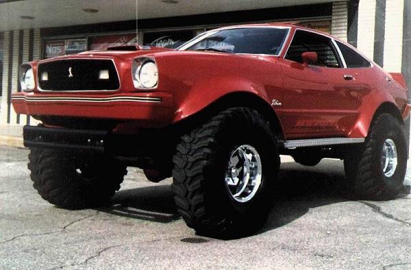

this
to this
the other reason is when a 350 comes into play you have to uprgrade everything from driveline to god only knows what else, and by the time you make it so your not ripping your parts in half with to much power you might as well have swapped for that 3.4 and save yourself the hassle. I wanted to swap for the Lexus V8 for my current 3.4 but decided since only a couple of guys are in the process of doing it, I would wait and see how theres come out. Most toyota owners just want a little more power 40hp is good I would like 40 more and thats what the Lex V8 would give me ok maybe a few more but you get the idea. And I wouldn't have to swap a crap load of stuff and being worried about killing my tranny or t-case or anything. The power range is still close enough that the stock components could handle the extra power.

those rigs always crack me up! Once I saw an MG-B body on a K5 Blazer frame.
