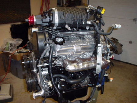

Oh, now that's just purty.
Brian
Old Jul 20, 2006 | 02:25 PM
  #82
mt_goat's Avatar
Joined: Nov 2002
Posts: 10,666
Likes: 5
From: Oklahoma State
Brian
Thanks, yeah purty until the first mud hole anyway lol.

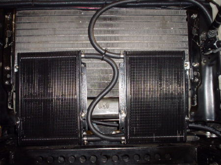

Hey I welcome the input, that's one of my reasons for posting this stuff. So please anyone bring it on, I can handle it.
Thanks Brian, I'll keep a close watch on a lot of gauges for overheating issues, EGT, trans temp, water temp, and cooling fan output.
I agree the auto tranny will be dumping an extra load on the cooling system. Maybe I should think about bypassing the factory radiator cooler all together? Did you see the extra tranny coolers I have installed? Just in case you missed them, here's the pic again below. I'd feel pretty good about just letting those 2 coolers do all the ATF cooling duties. The valve body upgrade I did also will help reduce the heat from the tranny.
I will be using a 3.0, (3 core) radiator (new aftermarket). The 3.4 radiators are shaped different and won't fit our earlier trucks. They are wider and thinner (only 1 core).
I believe (could be wrong) a lot of the overheating issues guys are having with the e-fans is they are not maximizing the flow thought the radiator because of poorly fitting shrouds. It's not how many CFMs your fan will move, it's how many CFMs your fan will force through the radiator. And you said yourself Brian in another thread that everyone (you know of) has a 2 inch gap at the bottom of their Taurus fan shroud. A two inch gap seems like pretty big gap to me, where the air flow is being allowed to bypass the radiator cores.
Another thing I see a possible problem with other's e-fan set-ups is fan control. If the temp probe doesn't see the heat and turn the fan on soon enough you over-heat before the fan can respond.
Brian what e-fan do you know of that moves more CFMs than the Taurus fan? I've seen claims that this Taurus fan moves 4000-4500 CFM on high speed IIRC. When I hook up the fan directly to a battery it really seems to move some serious air.
The e-fan seems like a no-brainer to me for the 3.4 swap because the 3.4 mechanical fan doesn't fit the 3.0 radiator shroud, so a 3.0 fan must be used to go mechanically. Also the body lift required to fit the engine under the hood, forces the fan into a bad position relative to the fan shroud. In some cases part of the shroud has to be removed leaving a big gap and loss of forced air flow.
A Lincoln Mark VIII fan move more air, between 4300 ad 5500 cfm on hi. I think the the Taurus Fan moves 3500cfm on hi.
Lincoln Fan on Corvette Forums:
http://forums.corvetteforum.com/show....php?t=1441606
Other than that, the only stronger one I know of is an electric fan off of a Dodge Viper, but its really expensive. I think the Lincoln fan is more expensive than the Taurus, but still possible. Note it pulls 43 amps continuous on Hi, too much for the FK-35... you would probably want the FK-60.
EDIT: BTW- the Taurus fas is a 16" fan, the Lincoln fan is 18". Like I said, see what happens first, but if you have overheating issues, you do have an upgrade option.
