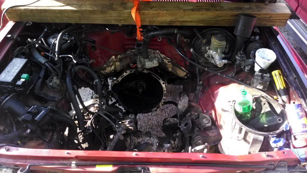

Well, I've been "in the middle of" my swap for about a month. I just had a few questions that I cant seem to find the answer to anywhere.
First off, what all do I need to keep in the engine bay? its a 92. heres a pic of the bay. it would be awesome if someone could edit it and circle what stays and what goes. Name:  IMG_20140512_182212854.jpg

Depends on what you wanna keep... Cruise....A/C. Pull the 3.0 engine harness all the way out including the ECU. You'll need to get one made or buy a new high pressure power steering line....and some other things. Read off road solutions write up about this swap along with everyones on here. Thats the way i figured everything out and probably a lot of us swappers. Im getting a harness made thru toy-only-swaps

Have you read the stickies? Pretty much everything has been covered on what needs to be done. Don't throw anything away till your up and running 100 percent.

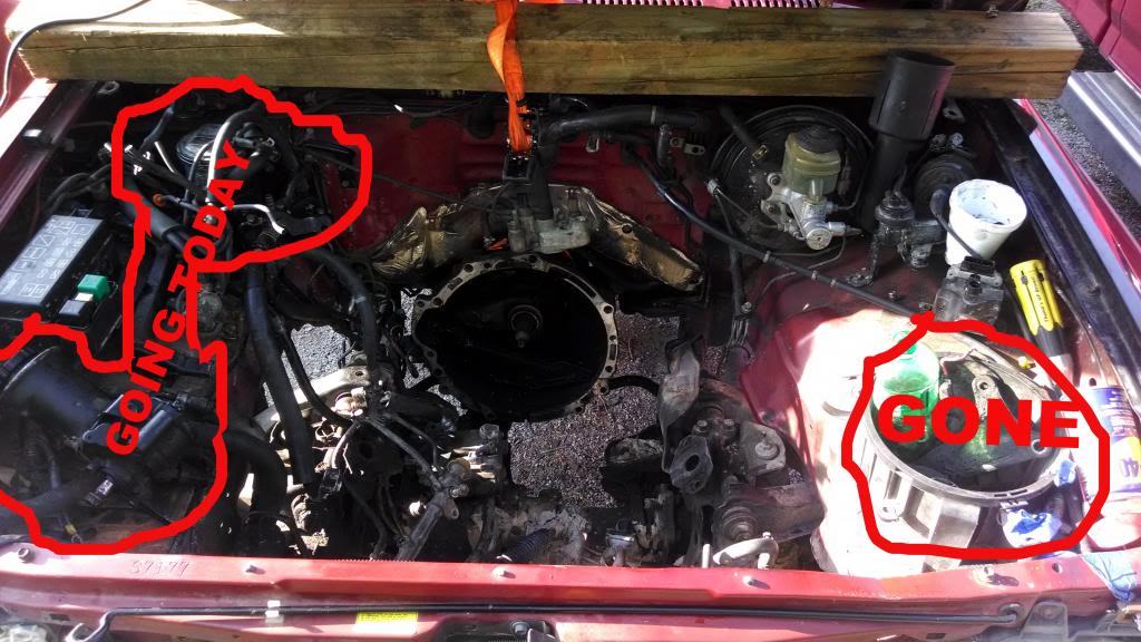

heat will stay. I do have a wiethat is incredibly cold natured. cruise too.i mainly meant all the old vacuum stuff.
Everything in red is either going or gone. I could use the vacuum diagrams for a 92 runner and a 97 taco if you have em. I have no clue about the wiring, so ill get to that when I get to it I guess

The 3.0 air box has to go (replaced with the 3.4 version), the 3.0 power steering pump has to go (replaced with the 3.4 version and a custom hose), the evap system depends on your local state's emissions requirements, either keep the 3.0 and hook it up as described in Elvota's swap thread, or swap in the 3.4 system.
