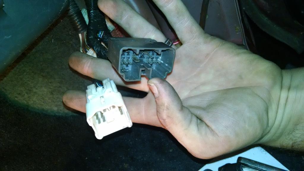

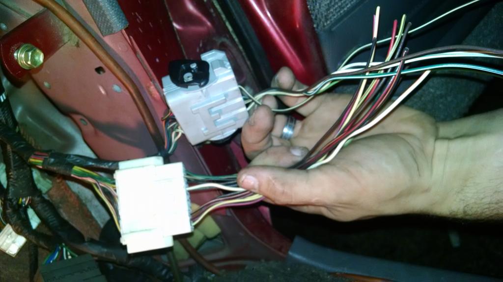

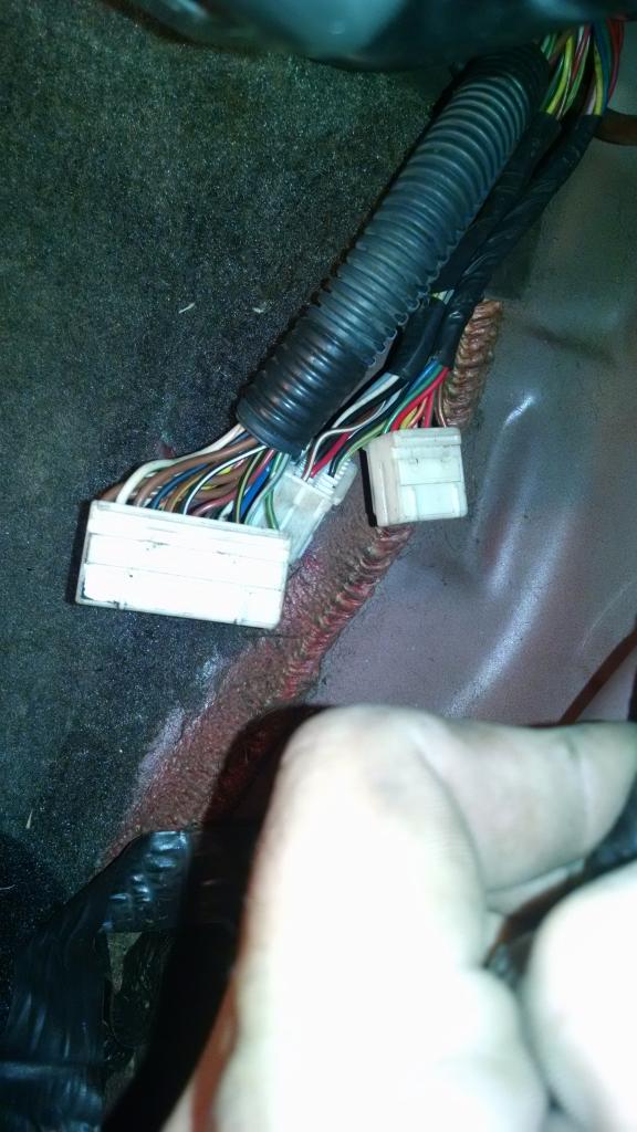

okay im going to start delving into the wiring, and I know the first three plugs are unchanged, plug them straight into the ecu.
Am I correct in that I need to take the pins out of the larger connectors with the lock brackets (cant remember the designation for these)
and repin them with these, the IH1 and IH2 connectors
then what do I do with the fourth ecu plug?
note I deleted the ac, and have manual aisin hubs, so a.d.d. isn't an issue.
this is a 92 runner 4x4 mt receiving a 97 taco 4x4 mt for clarification.

Essentially yes. I've never just taken the pins from your donor and inserted them into the plugs of the vehicle your swapping to. I usually make a jumper harness in between. You should have both sides of all The plugs you have pictured. Just start matching up functions according to your ewds

I do have all the plugs. I'm just not all that sure of where that would be in the ewd. Would it be on the pages that have theecu on it and the wires leading off it? (You know the one). I hate soldering, but it looks like that's the best way to go. Wait, that's what you mean right? Solder the wires together and make like a long harness with the female II1&2 plugs on one end and the male IH1&2 and the other? I feel so stupid having to ask but I just don't wanna screw it up.

Yes that's how to make a jumper/adapter harness. Just match up the functions. I'd recommend using wire nuts for the connections till you get everything working, THEN solder the connections. Solder then shrink wrap. No sense in soldering everything together to cut it back apart because you tied the wrong ones together.

Frankly why couldn't I just use the 3.0 plugs on the 3.4 harness? Repin it and plug it straight in?

You can do that. It was easier to make my adapter harness inside in the AC. There is more chance to mess up repinning it.

the pin styles are different. Make an adapter harness. This is the easiest thing to do.
