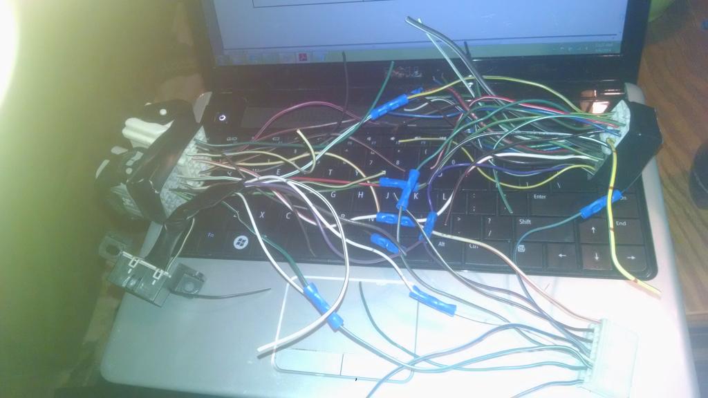

I said id post a picture, so here it is. its no where near done, but ill get back on it after I get to where I can see straight. sorry for quality.Name:  IMG_20140806_242650462.jpg

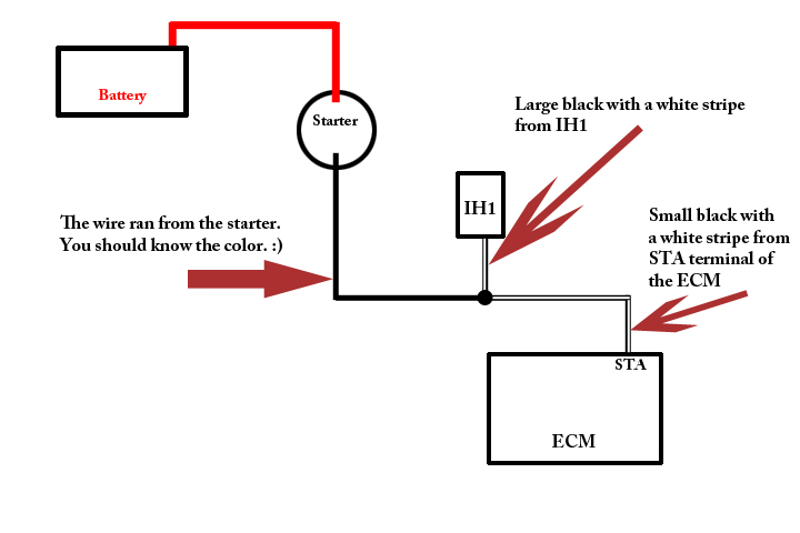

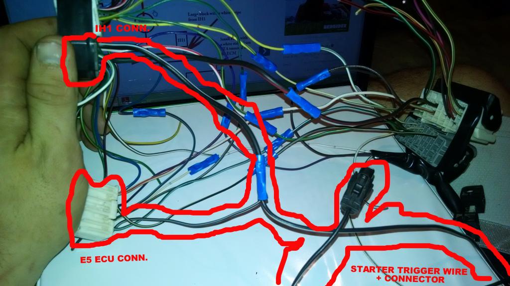

1. so, why is it that even when I have nothing hooked up to the plugs, no ecu plugged in or anything, when I turn the key, the COR relay clicks, and my pump turns on. I know it turns on because I hadn't tightened the fuel line all the way, and I smelled, plus saw fuel.
2. I was working on pushing the harness through the fire wall, and absentmindedly placed the ecu on the battery.... long story short, it arced and I saw a bit of a spark...... what are the chances I fried the ecu? ill kick myself if I did.
3. im pretty sure I need to pull my gauges AGAIN. I did the tach mod (resistor on the back of it) because anytime I turn the key it jumps to 2-3k rpm and holds there. any knowledge on this?
4. plugged the ecu in to all the connectors in my shoddy harness half expecting it to atleast turn over once or twice, but no dice after key turn.
This is dntsdad's diagram on his 3.4 swap 101
this is part of my conv. harness. ive marked out whats what.
Can somebody confirm this?
And DNTSDAD if you read this im soldering the connections later, the butt connectors aren't here to stay.

Can't be much help on this. I don't recognize all your plugs so I'd be guessing. Must be a donor I'm not familiar with.
I will say that al you want to do is find the wire in your vehicles body harness that has the larger black/white wire. Confirm it goes to 12v when you crank, connect that to the starter trigger itself on the starter and also stub out a wire to connect conte STA on the ecm.
