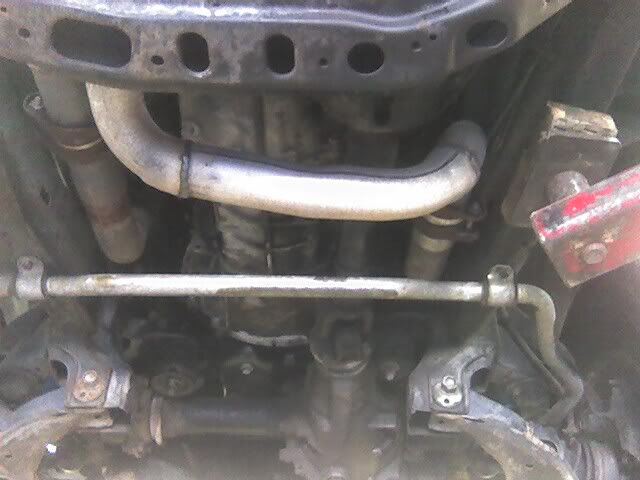

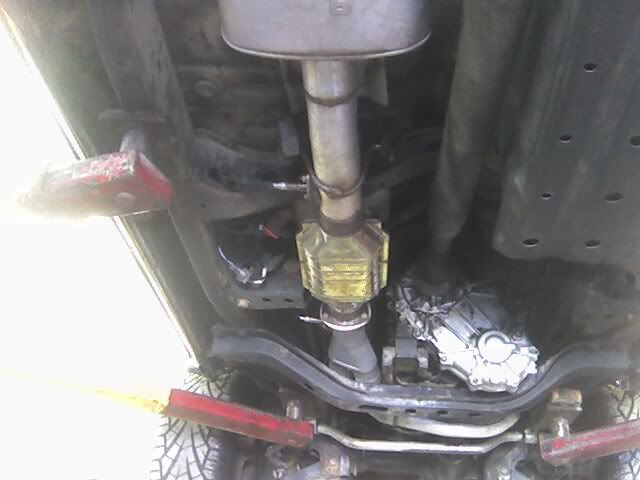

I don't have any good underneath pics; I found a couple I took with my cellphone shortly after I re-did my crossover. I used 2 1/2" swivel couplers and pipe from the headers into a Flowmaster dual 2 1/2" into single 3" out, then a 3" magnaflow cat (all in the pics), then I tried several different mufflers until I found a combination that worked best. I'm currently running a stock Dodge Ram muffler and a Summit race resonator after it (no pics of that stuff though).

Thanks, Its hard to see from the picts, but it looks like you did exactly what I was planning on doing. It looks like I got those headers, well at least I have paid for them. Now just have to wait for them to come. Do you have a body lift on that truck? Just curious what size whole I am looking forward to in my hood.

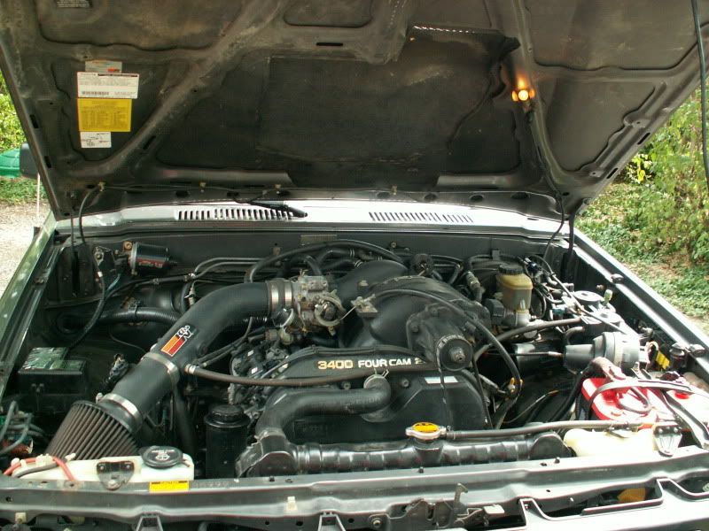

I have a 98 4runner with the TRD headers, i installed the headers a little less then one years ago, no problems or complaints. I also removed that cat and i have a 02 simulator because i got tired of the check engine light lol
Truck runs strong, i also have a custom intake + velocity stack and KnN filter. I was running a regular cone KnN when i installed the headers, the truck woke up when i put a velocity stack and KnN. I also converted to a 99+ MAF and ditched the restricting older MAF.
I almost went with the OBX's since i could find TRD's for a decent price. They were exact copies of the TRD's so i was just going to grind them out and clean them up a bit prior to install. But i got lucky and scored a set of TRD's for 400. So i installed them
