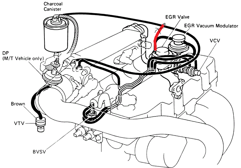

Could it be a vacuum problem? I found the turbo diagram and everything looks fine however on the diagram it shows the EGR vacuum modulator going to the EGR valve. On mine as drawn in red you can see it goes to the plenum on a 3way vacuum, whats up with that? Pics attached

welll. obviously, it's not routed correctly..... the sole purpose of the modulator is to run the egr correctly.... which it is not connected to...

in short: the modulator control is connected to the throttle body so it isn't actuating when it could choke the motor out.... via a vsv and bvsv, of course....... and that does not clarify if you left the jumper in and attempted to start it..... we get thet the fuel pump turns.... the jumper eliminates certain problems and you need to be clear when and if it it is jumpered to run while attempting to start, or is running, not vauge, like that you can "hear it run when you jumper"...

Yes, the jumper is in, with the same results in or out..
So in the photo with the circled 3 way vacuum jumper - I can't find any reference in the FSM or online as to what goes to that vacuum-line-wise..

the first pic is the related vacuum routing........ fairly strait foreward.

Maybe with misrouted EGR vac lines, or defective EGR controls, the EGR is opening as soon as the engine runs enough to make vacuum and kills the engine.
Remove the vac line from the EGR valve itself and plug the line.
See if the engine will start and run.
It may be possible too, that the EGR valve itself is stuck open.

i would make that diagram, or the one that should be printed on the driver side under the hood match the engine first. it seems to have been reworked, and whom knows what else could be off...

Okay, I routed the vacuum lines as the diagram shows. I plugged the line marked in the pic going to the egr and had no difference in running, shuts down after 1-2 secs sounds/acts the exact same.. If I rev it up when it starts, it shuts down the exact same as if I just let it idle immediately after starting..
