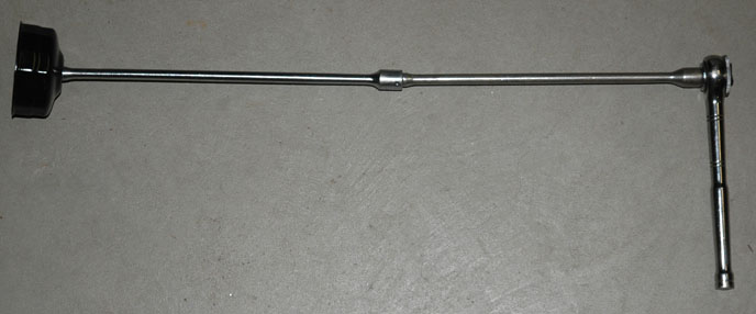

or you can use this....works really good, just wrench it from the outside of the truck...
Attached Thumbnails what did I just break? &lt;/tard&gt;-filterwrench.jpg

CynicX, it looks like that is what he was using from the picture he took. Look at the filter socket on top of the filter in the pic!

Yeah, I was using one of those filter caps as the pic shows. However, I could only get a wrench on the inside. I tried to use extensions to get it to the wheel well but the angle was wrong. CynicX pic appears to show an articulating joint; I guess that is what I needed. I think I’m going to have to find a wrench like MTL_4runner.
