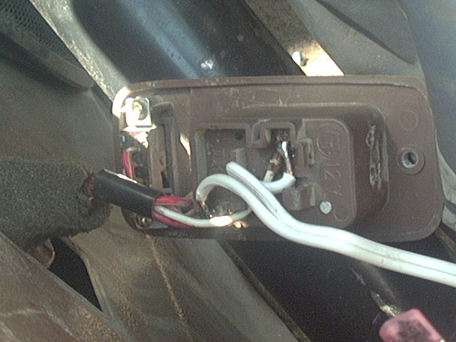

The 1st gen 4Runner deck light is wired like that. The front deck light switch and the rear switch behind the roll bar will turn the light on and off. Only gotcha with the factory setup is it requires the parking lights or headlights to be on before the deck light gets power. So I rewired the front switch for constant power and then spliced in an external plug into the rear deck light so I could plug in some other light. I use a 12v LED trouble light strapped to the roll bar for a deck light. Unfortunately the FSM wiring diagram does not show the full wiring for the 4Runner (they only have the pickup setup with one light and one switch). I suspect it is set up as a three way light switch:
- http://home.howstuffworks.com/three-way2.htm
Tapping the rear deck light for an external plug:
That white wire runs to a 12V lighter plug into which I can plug a 12v LED trouble light on the roll bar plus an LED festoon bulb in the deck lamp:
My old camera does not take good pictures in low light, but it is very useable light in back and with the LEDs, it can run for hours w/o draining the battery.
