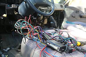

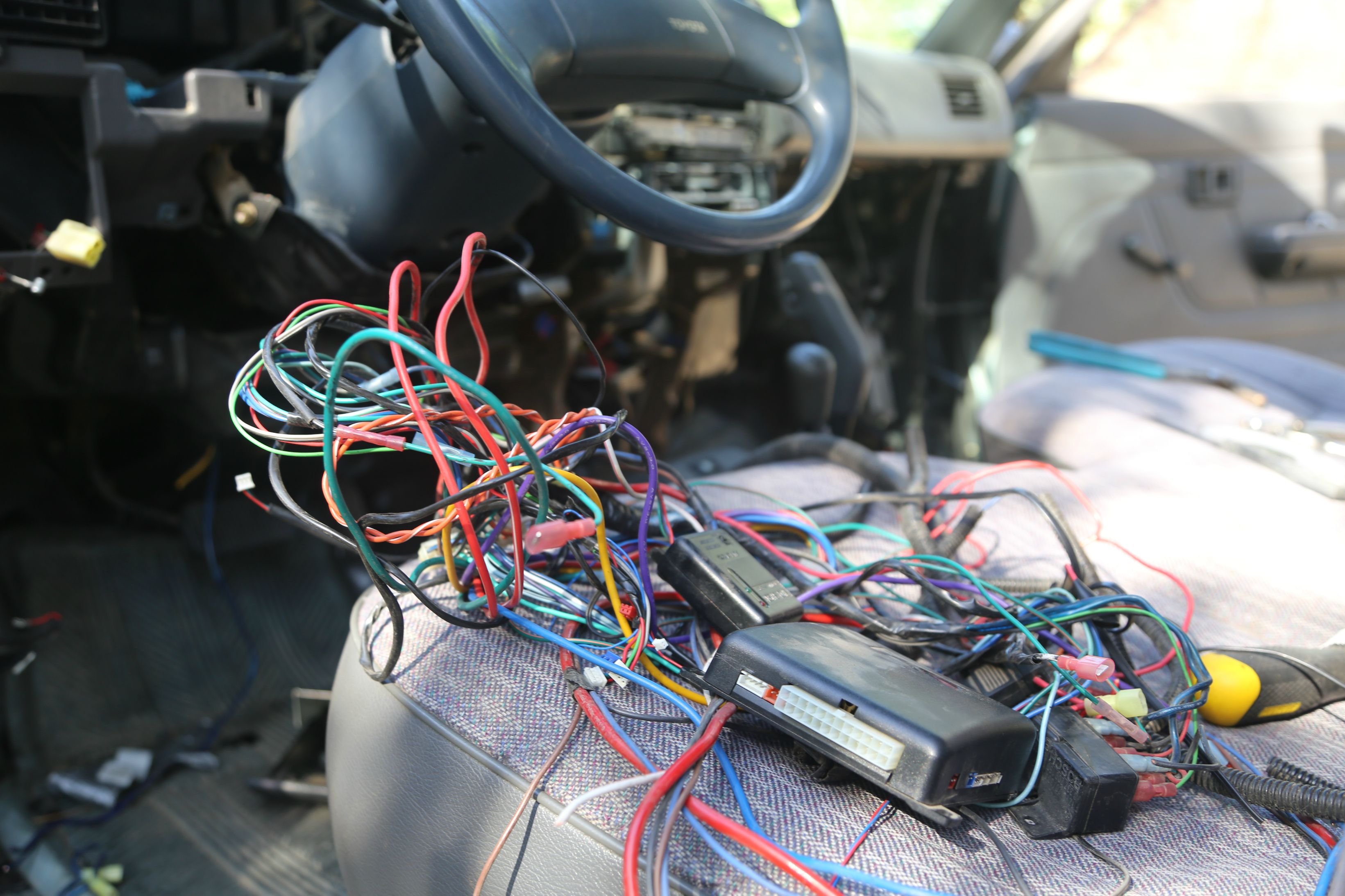

Ok, so as i pulled apart my dash to take out my cluster and install some red LEDS i found something that i knew but didnt know. I knew at one point this truck has a remote start/alarm system.
3 hours of tracing and untangling and disconnecting later.... considering i have zero experience with car electrical systems im amazed it still runs.

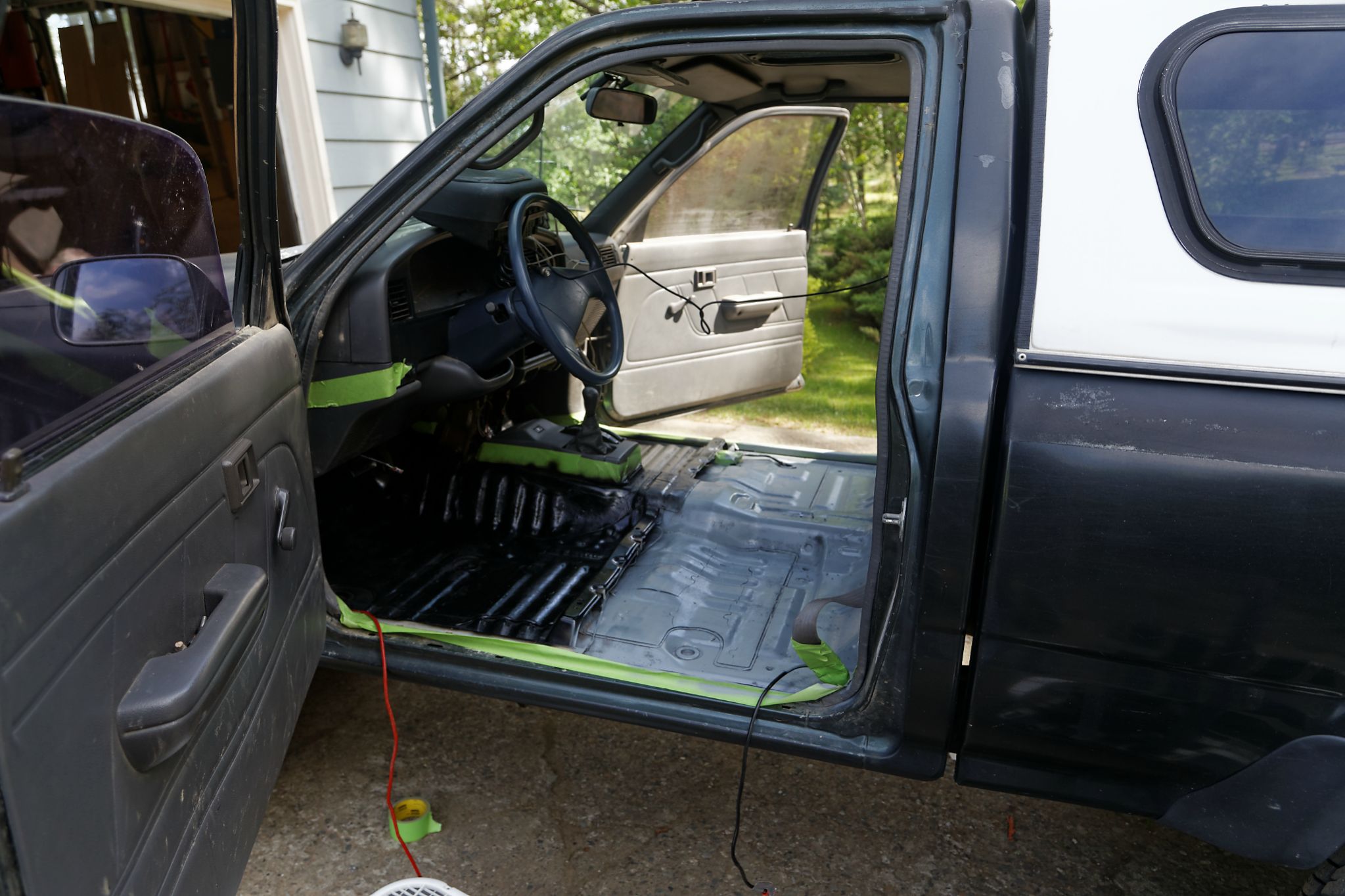

oh and i also cleaned/refinished my cab the other day.
