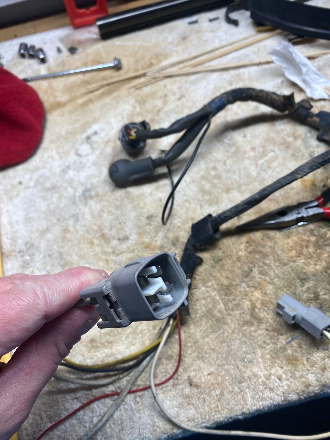

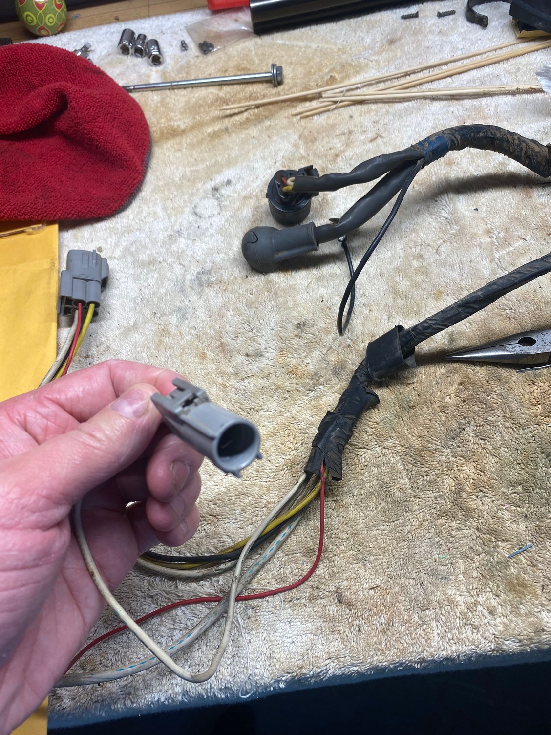

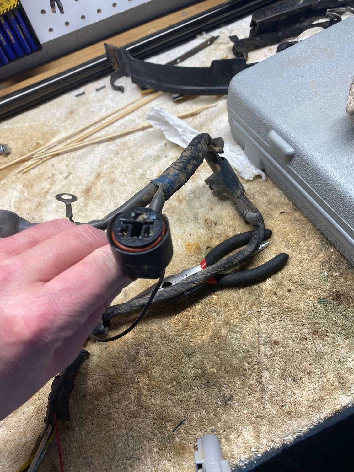

If you could not find harness, just rewire. Pretty simple wiring. I have post "How Charging System Works".
Merry Christmas!
any idea how to remove these connectors? Trying to forgo messing them up since I’m having trouble finding any of these parts.

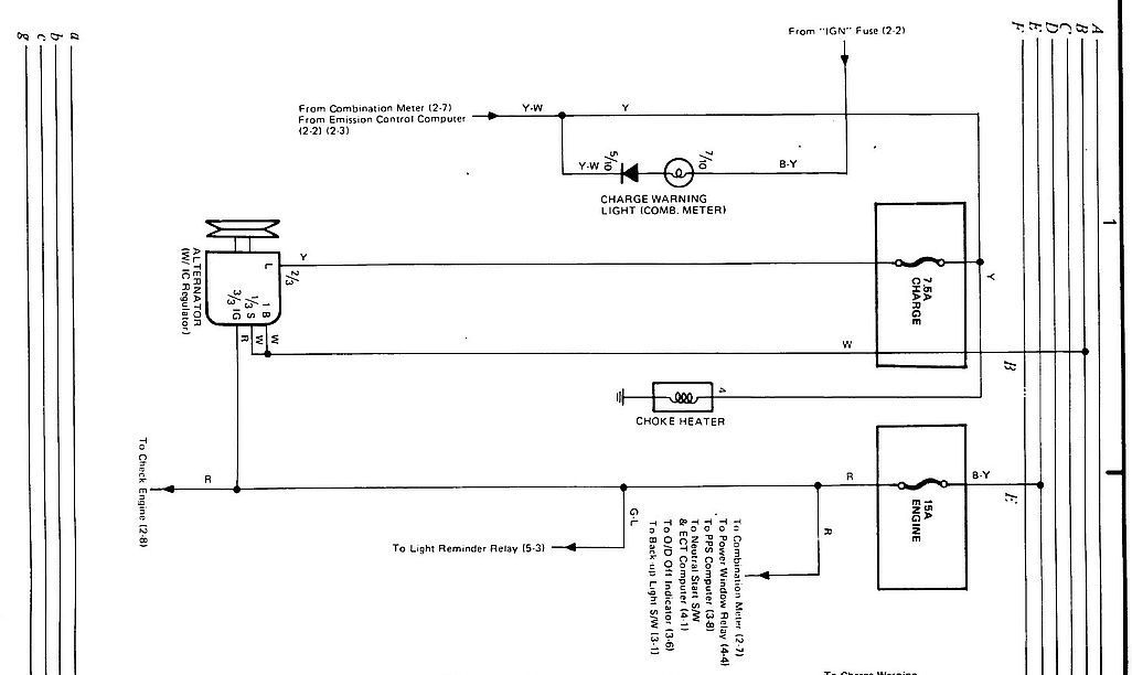

This almost answers my question I just need to know how the ignition switch and the ignition coil and module interact with the rest of it
Last edited by Darylzane; Feb 15, 2022 at 02:37 PM. Reason: I thought it would post directly to Pat's answer with the two diagram pictures
