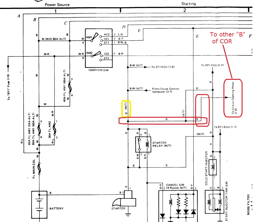

Originally Posted by tomd
Now, this "junction after the start relay in the wiring harness where the feed to the COR is tapped". I'm assuming by "start relay" you're talking the one out on the right inner fender right beside the resistor?
... From "where the feed to the COR is tapped" does it go directly from the tap to COR or to computer and back on the way?
Yes, he's talking about that starter relay.
The "tap" is the black wire from the "ST1": contacts of ign switch. It is NOT ELECTRICALLY AFTER the starter relay. It is Electrically upstream of the starter relay; it supplies power to positive side of relay coil. But again IF you physically trace the wire run, the tap is is be physically closer to the COR than the starter relay is.
Here is that tap on the schematic.
From that electrical point (may not be exact same physical point) there is also a tap to the ECU, but don't worry about that for now.
Here is where that tap connects to the C.O.R.
As far as physically finding the taps, we would not be able to do it for you remotely; Those could vary from model-year to another, The best way is to do it yourself; that's also the best way to your schematic. best of luck,
